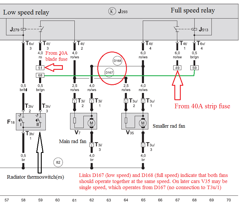

Numbers in rectangular boxes show the 'current track' where this wire continues.  'Current track' numbers are the numbers running along the bottom of each diagram. When you get to the correct page with the referenced current track, you'll find a corresponding rectangle containing the number of the current track where you just came from.
Example here where both current tracks are on the same page (they usually aren't)  I've drawn in a green line to show the two points being linked
What that bottom values mean? here is 57, 58, 59 etc... ?
And another question - you wired numbers like 68 and 59. I'm assuming that this is just an example, and I have to ignore numbers, because in real situation the 59 number will be connected to 59 and 68 will be connected to 68, right?

No, wrong.
As I wrote, the numbers along the bottom are the current track numbers. The numbers in the rectangular boxes refer to these.  Don't ignore any numbers.
Please think about this for a while. It's confusing at first but simple really.
Live connections start at the top, from a relay plate or control unit and work their way down to the bottom (earth track).
Usually the current flow diagrams start with a detailed explanation of how to read the manual.
