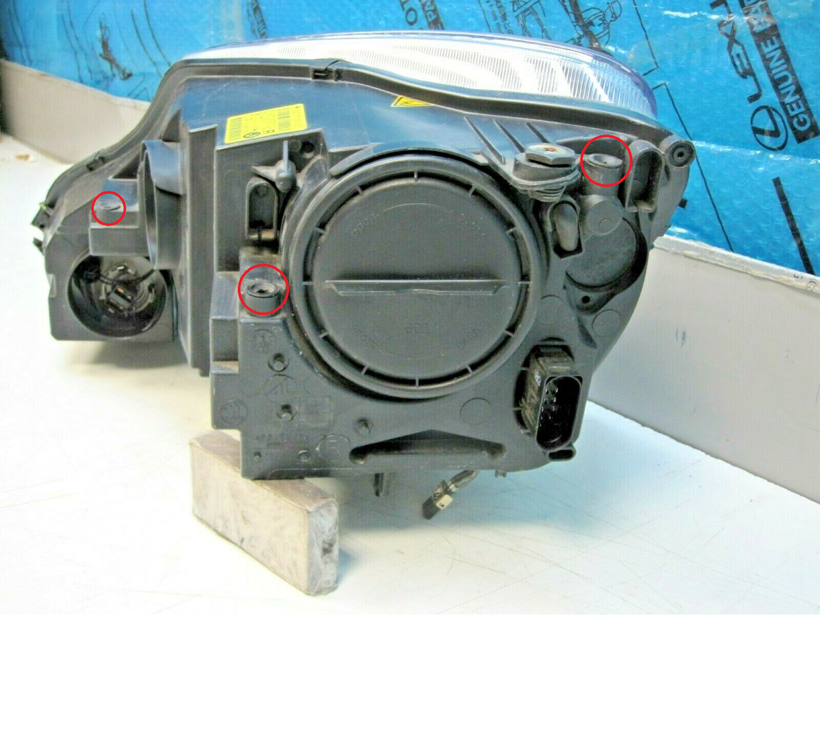

It'll probably be the black hex adjustment screw above the fog lamp, to the right of this picture:
Thanks, I will try turning that adjustment screw and see what happens.👍
Don't forget that the fog light cannot individually be adjusted as the whole light unit is one piece, so turning that screw is also going to alter the settings for the dipped and main beam.
