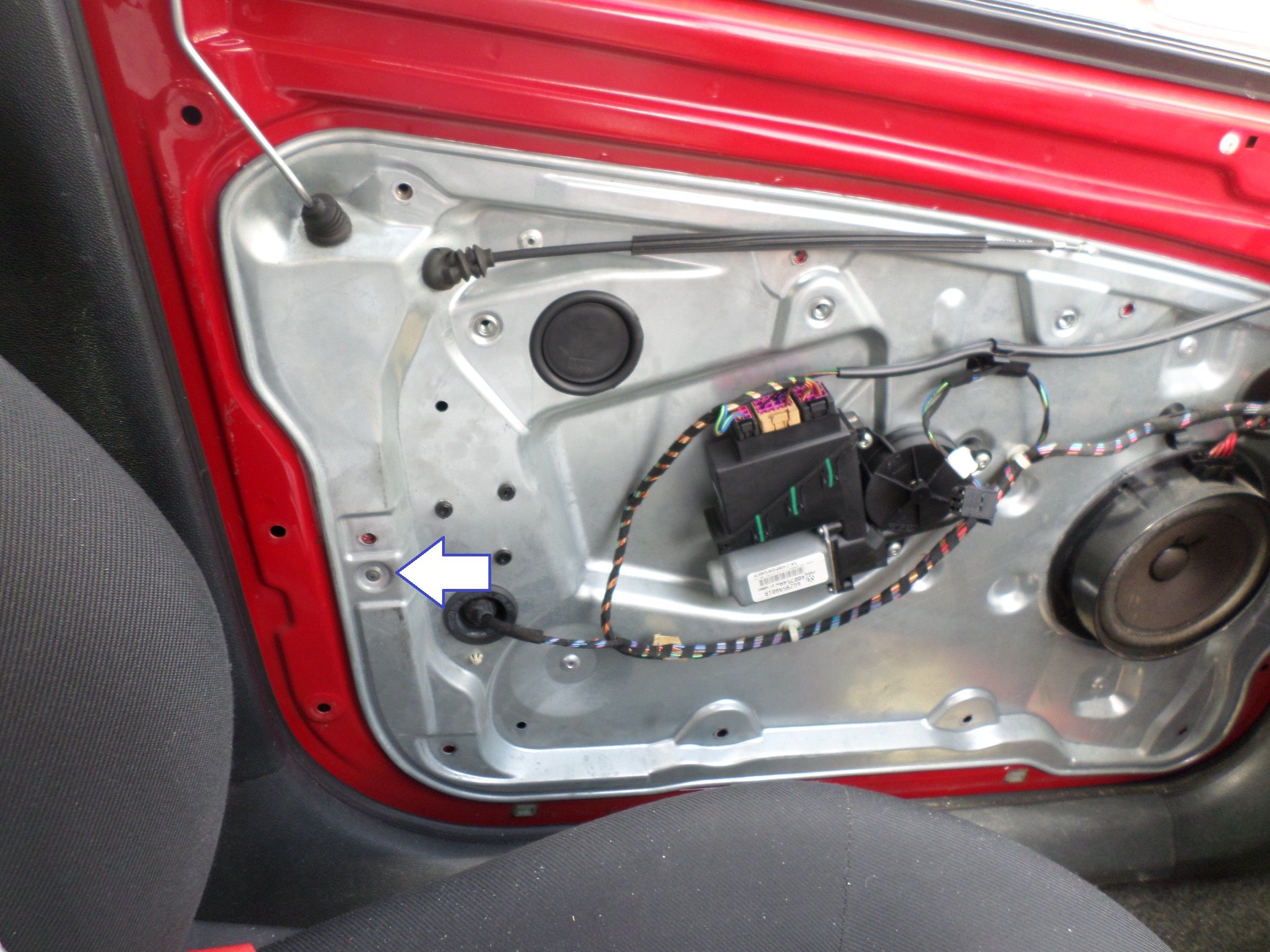

The passenger door only unlocks once in a while,  it seems random, I've managed to get it to work and have taken the card off but am now faced with the carrier which is bolted on.

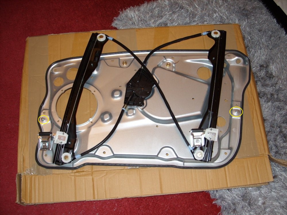

What are these, one indicated one on other edge ? locating dowels or rivets ?
the carrier doesn't seem to want to move, the door has locked itself again

You don't need to do anything with those rivets, they are something to do with the electric window mechanism.  What you do need to do is to take the two large plastic/rubber grommets out, lower the window glass until you can see the bolts to release the glass. Do that, tape the window up fully once it's detached from the carrier, then you can remove the carrier.
Locating dowels :)
