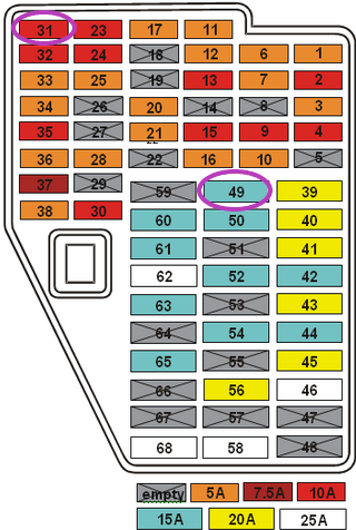

Seems strange how it only happened after you changed the window regulator though. Seems more likely that it's related to that rather than a module. Have you checked the fuses?
Fuse 31 & 49 are the central locking.
FIXED*** thankfully it’s now sorted and it was Infact fuse 49 even though it doesn’t even look split or burned out so that’s a bit weird.  But changing it seems to have done the trick. I guess sometimes it’s the basic stuff. Thanks for the help!
Glad it's fixed 🙂 Fuse might have been making a bad contact if it wasn't blown. Or maybe removing the fuse caused something to reset.
