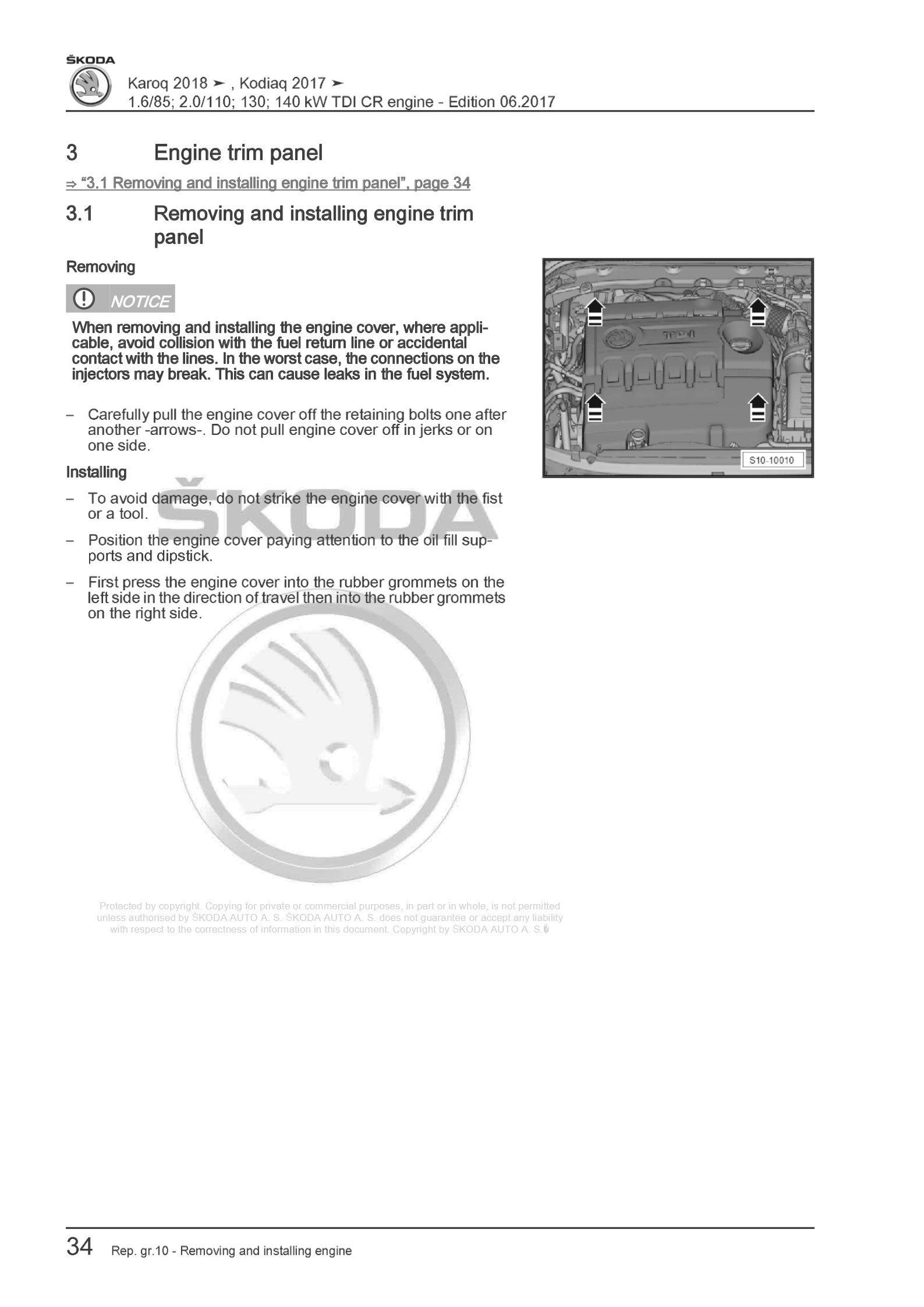

A very basic question, how do you remove the Engine Cover (The plastic Bit)
Hi Andmag, I assume that you mean the plastic cover over the coil packs, on top of the engine? put your fingers under the left hand side of the cover (belt pulley side of engine) and gently pull up -  a rubber bung in the cover fits onto a spigot bracket bolted to the engine, the right side of the cover has two spigots that fit into recesses in the intake trunking. Smear a little petroleum jelly or similar on the rubber bung before refitting.
Thanks for the help guys, all worked out ok
