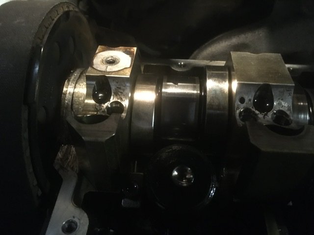

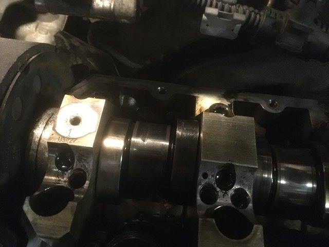

So I have just got the injector rocker shaft off and found:
Cyl 1 rocker lobe deep gash in the metal
Cyl 1 first lobe (inlet?) tip to toe 57.75mm
Cyl 2 first lobe 61.79mm
Cyl 3 second lobe (exhaust?) 60.75
Cyl 4 second lobe very worn
Basically all but one of the lobes shows sign of wear but the lowest above was the worst by far.
Have just ordered a new kit from Engine Team.
Question though about how that deep gash could get there and the corresponding rocker is damaged?
Poor metallurgy/manufacturing/incorrect oil.
