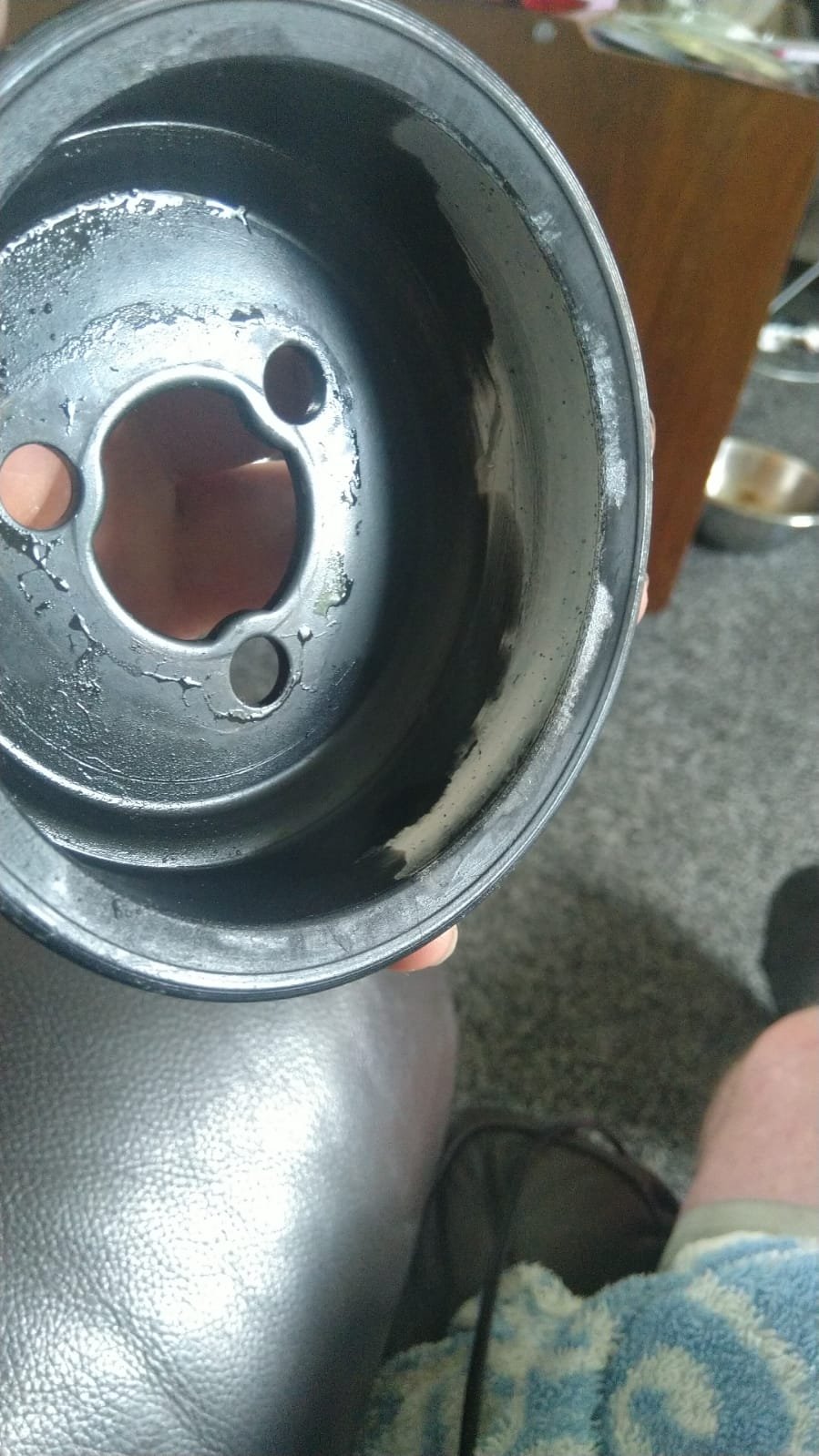

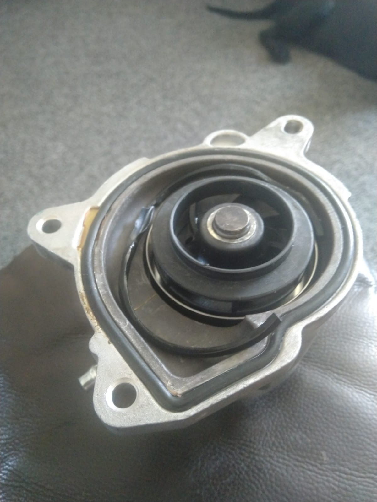

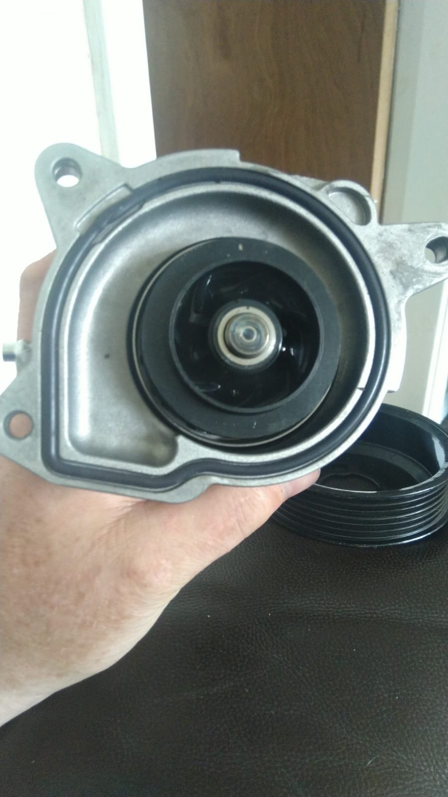

Hello again, I have some picture of the current pump that has been taken off. May I add, the first picture is the old mickey mouse pump that replaced the original one when I rebuilt the engine from timing chain renewal. I had replaced that with a new skoda part, and this is the one I now have a leak with.
That said the new skoda pump has failed and seems to be in the same place.
The first image below is the new Skoda gen pump that was replaced 2 weeks ago. Although it looks good inside. Its leaking in the same place around the shaft that the pulley fits too. Second image shows the coolant dried on the inside of the pulley. Showing it to be the same place. Am I that unfortunate to have to pumps fail in a similar way or are they just crap and not that good. Or do I have a problem that's causing it to fail in the same place. Its odd to me.
Edited by Interplain

I see there is a small pocket in the casting that coincides with where that rubber gasket material joining point is, I wonder if some sealant needs to be added to that point only?
I wonder what the purpose of that "pocket" in the casting really is for as when you look closely at the previous pump, it also has that pocket in the casting but that rubber gasket seems to have been either made in a single piece or the joint point is invisible - is the "unevenness" in the rubber gasket on the new pump actually where the material is joined or something else that has caused that appearance on that new pump?
Edit:- I do understand that any fluid leaking out around the gasket sealing point, should, if it is just a small leak, run down the face of the engine, but if it was a bigger leak it might spray out and get caught by the belt pulley, just a though option for this second pump leaking.

That pocket in the pump casting is like a fusible link, a deliberate ploy to allow the seal to move if it is distorted by excessive pressure, this causes an obvious leak to act as an early warning if the system is overpressurized. The fact that your tank cap is also blowing coolant out just provides more evidence to support the theory.
