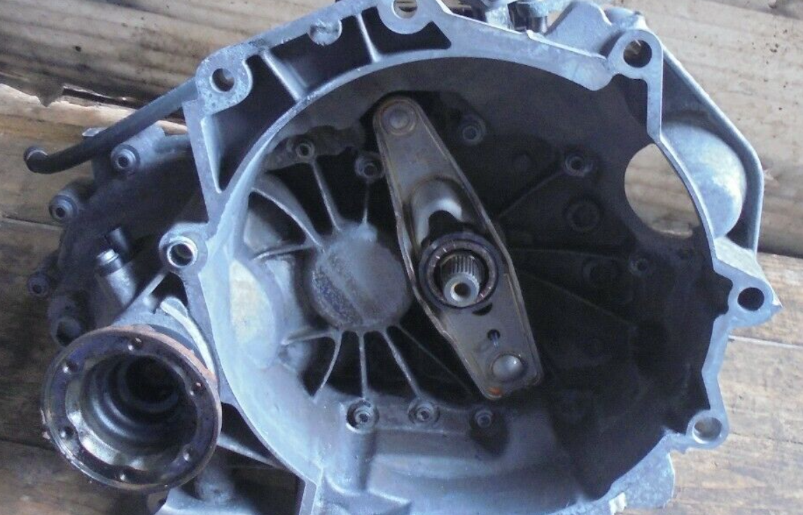

Looking at this image from an ebay listing, the starter hole is going to give much better access for viewing than the slave cylinder; looks like it might be hard to get round the release lever from there.
Still might try there first 'cos there's a lot less disassembly involved, two screws.

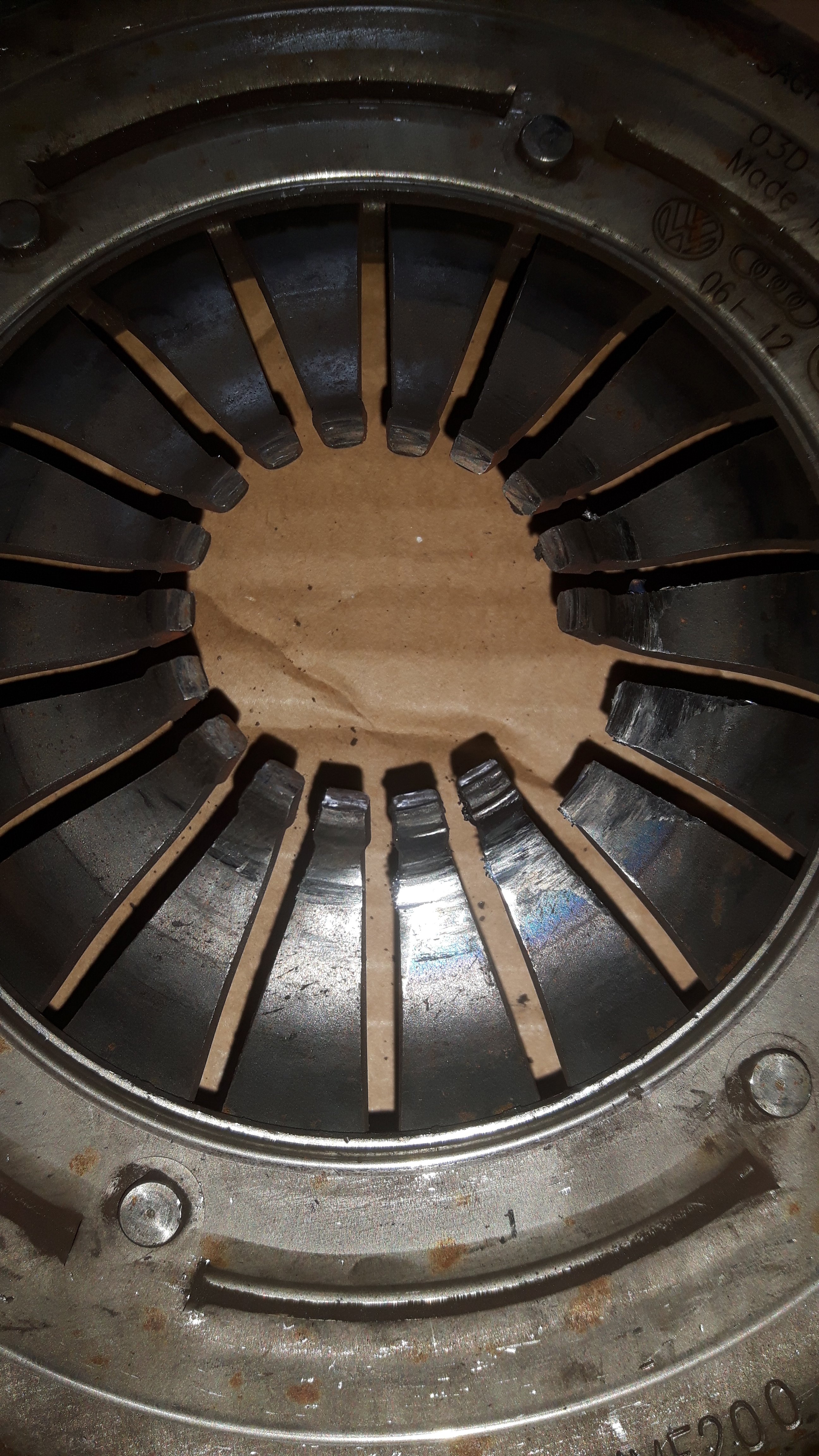

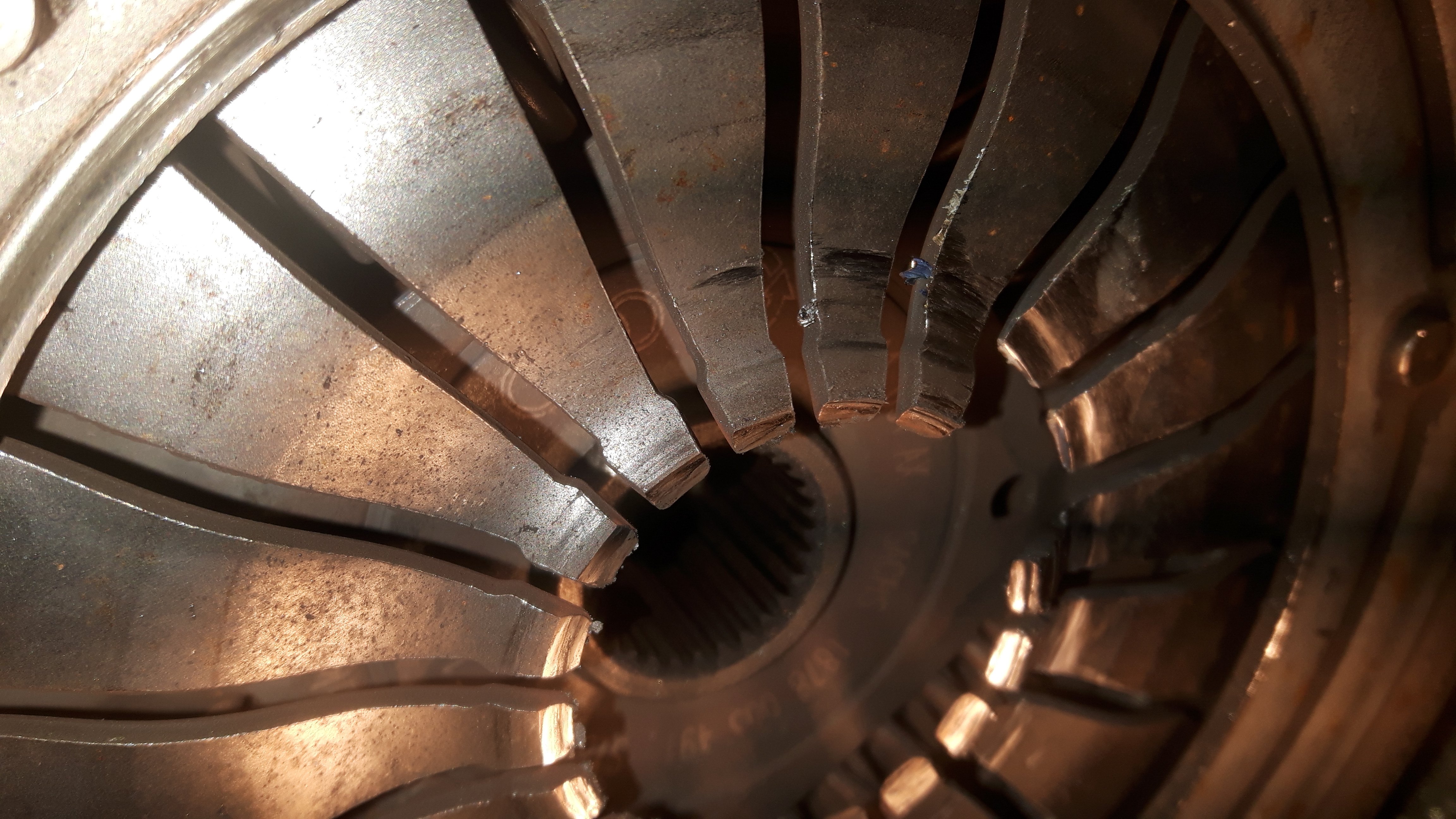

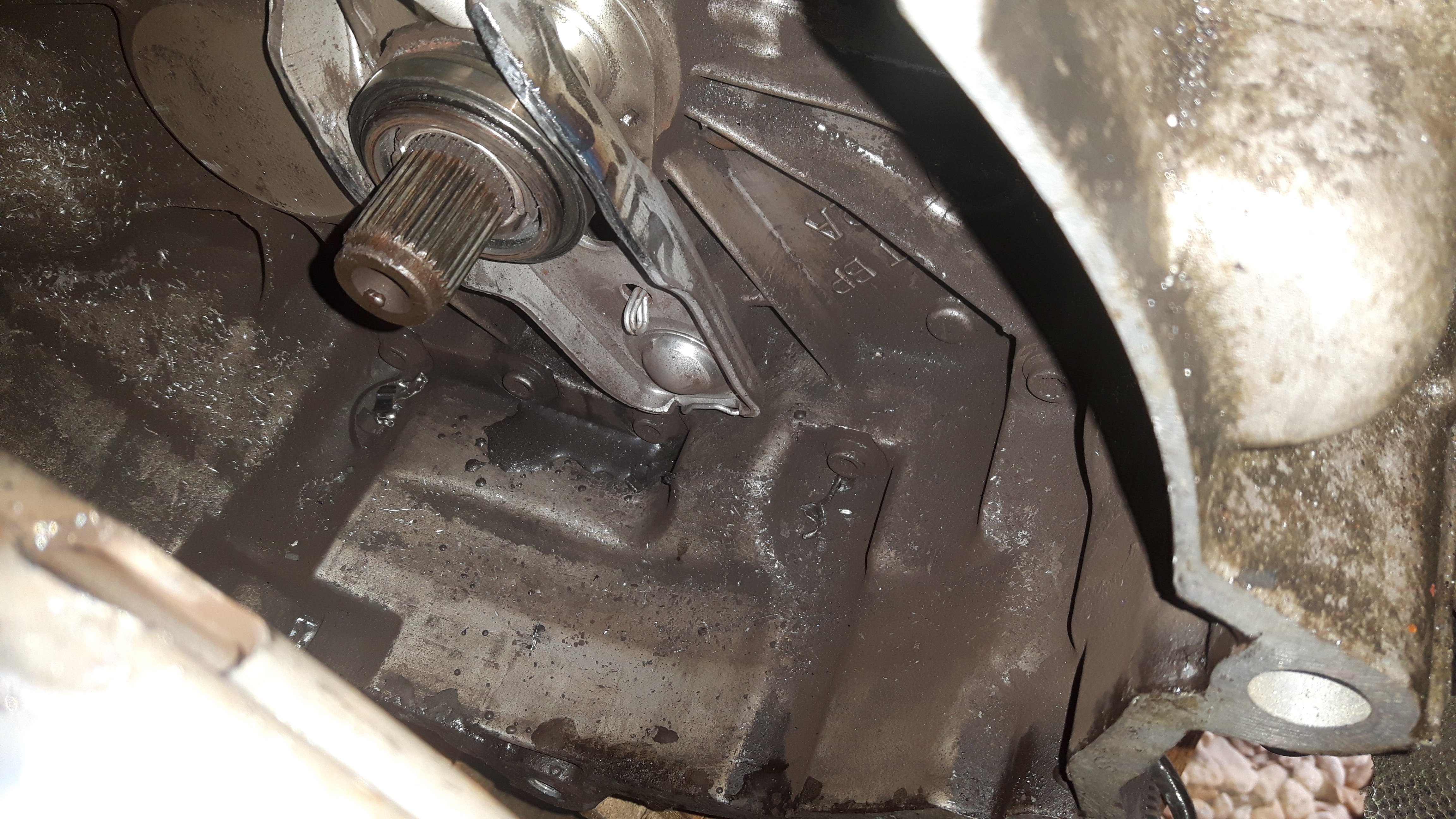

Not the best pictures in the world, better ones to follow, but the misbehaviour may have finally been diagnosed.
'Finger trouble' almost certainly caused (or started off) during the gearbox swap of Easter 2019.
I'm fairly sure the fluid evident in the bellhousing is coolant that's worked its way down there very recently, as the engine head was removed yesterday too. Plenty of metal fragments and swarf about though.  ☹️
Looking like a new clutch cover, new release lever and release bearing reqd, as a minimum?
No amount of peeing about with the clutch hydraulics was going to overcome this little mess.
Edited by Wino
Two of the fingers look snapped, yes?
The release bearing looks too far back in the fork, was it not making an awful noise?
Edited by TMB
  • Sponsor
Yep, two broken off, one or two others bent, most of them machined a bit by incorrect contact, release lever also machined a bit (see bluing of side nearest camera). Right old mess.

I don't think this has been caused by assembly but something looks to have happened with the release bearing to me. It looks like it's moved back for whatever reason, allowing the fork to touch the fingers.
Edited by TMB
  • Sponsor
JJL-code gearbox.
I reckon the release bearing and lever have both been subjected to trauma due to bent fingers 'ravaging' that general area.
I remember struggling more than previously to get the gearbox back aligned/on after the box change. Bet I clouted those fingers with the input shaft.
I'm surprised it's taken over a year to really affect the running of the car, and in such a limited way, although I suspect it wouldn't have been much longer before there wasn't enough clutch mech travel to find gears any more.  Must get some fresh oil in there as well.
Yeah, thinking about it again, the fork has touched the fingers mainly in one place, suggesting that the fingers haven't been in an even plane.
