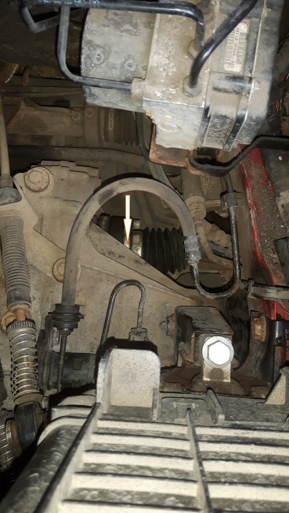

Have literally just had another idea that might be easyish to check once the rain stops - could it be that the flexi section of the hydraulic hose between master and slave is swelling/ballooning somewhere, taking some of the fluid that ought to be pushing the slave cylinder's actuator?
Far-fetched and probably just me being in denial about there being something wrong inside the bell housing. Fingers crossed though...
Deffo worth checking.
  • Sponsor
Had a go a few minutes back.  Nothing bulgy but interestingly, the whole flexi section can be felt to move slightly (in the direction of the arrow) as the clutch pedal is pushed fully to the floor. Not sure if this is to be expected, or how to imagine exactly what's going on structurally there; but doing the same check on my Polo results in much less noticeable (but still detectable) motion in the same direction.
The hose is trying to straighten under pressure, it's normal.
  • Sponsor
Thanks, that sounds reasonable.

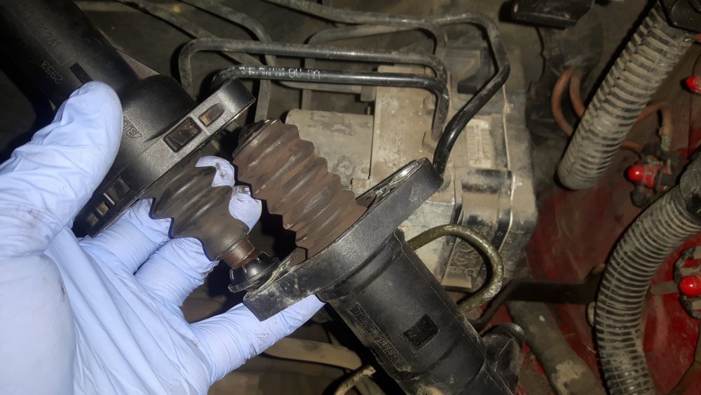

Interesting twist to this tale just now.
I bought a (recent) secondhand  slave cylinder of the part number superseding the one I bought at the time of the clutch replacement, with a view to maybe modding it as a workaround solution to the clutch engagement/disengagement point  being so low on the pedal.
So the one currently connected to hydraulics (dustier one on the right) is a genuine 6QE721261; the one that turned up yesterday for me to have a play with possibly extending is 5Q0721261.
Looking at the latter after its arrival yesterday, I had a nagging suspicion that the plunger/actuator seemed a shade longer at max extension than what I saw in the car last weekend, so here's them side by side:
There's a good 5 or 6mm difference there, which is ballpark what I was thinking of trying as a modification.
So maybe I just need to fit this other slave cylinder.
Stand by for the next installment over the weekend...😀
Edited by Wino
Strange how the lengths are different. Looks promising though 👍
