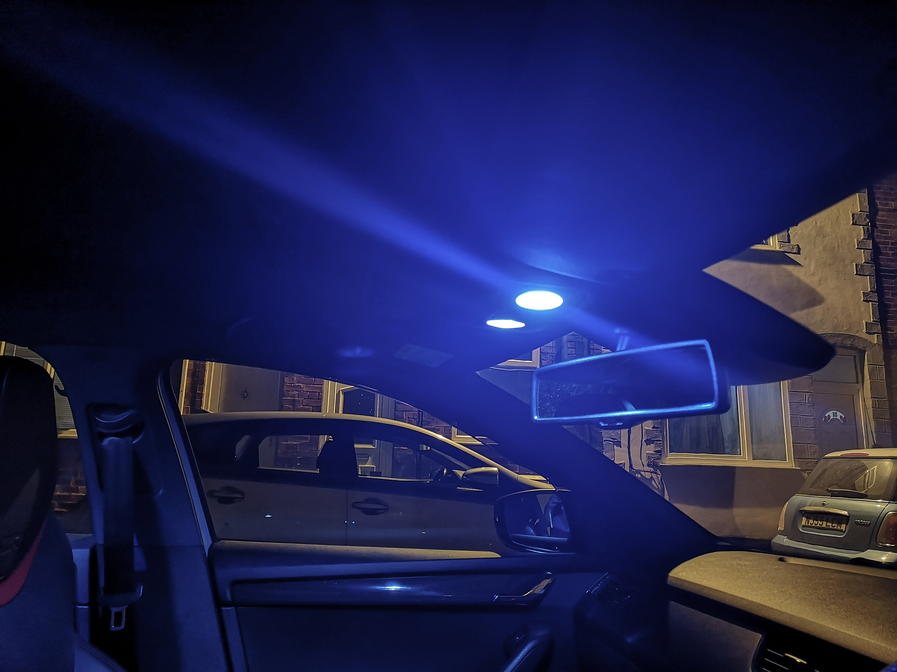

Mine came from ebay today fitted now front and back much nicer than standard
I've got some coming in the next couple of days too 🙂
51 minutes ago, Benz3ne said:
Are they as blue as in the picture? :)
No mate there not,phone cameras enhance colours just a slight blue white tinge to them much nicer and more modern looking than standard bulb 👍
It'd be the white balance rather than enhancements but got you. Cheers! 👍
