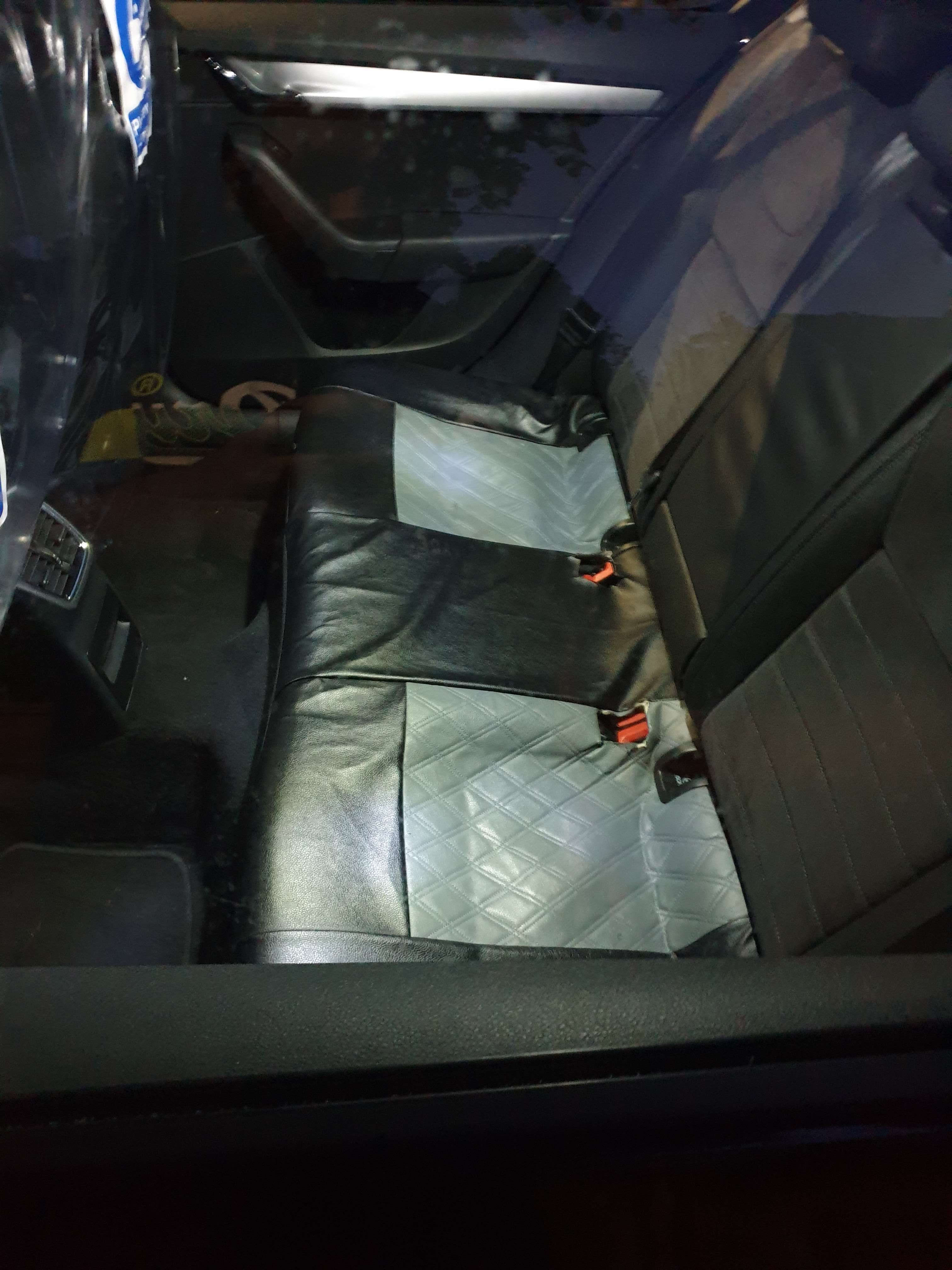

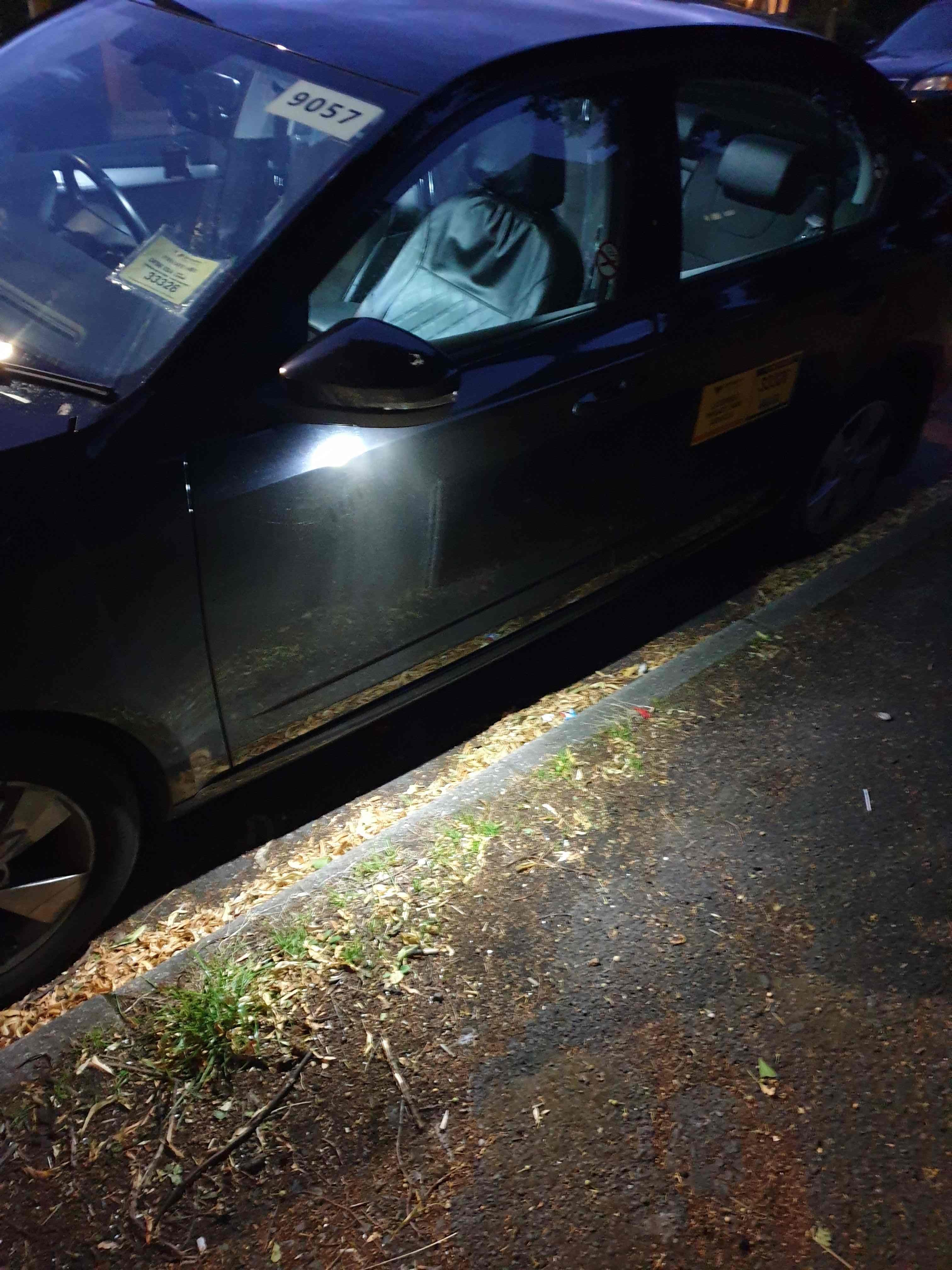

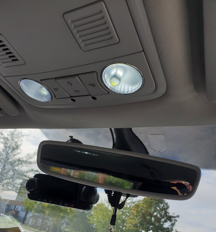

So the interior was boring and not bright. So i fitted some 501 leds. Mine takes 5x 501 LEDs. This is what i fitted
https://www.ebay.co.uk/itm/4x-501-Projector-Led-Cree-Smd-Canbus-Super-Bright-White-Reflection-T10-W5w-Bulbs/382010095554?ssPageName=STRK%3AMEBIDX%3AIT&_trksid=p2060353.m2749.l2649
As normal. Realy bright. No pics yet will add more in later.
First thing I did in both of my VRSs. Including boot, interior roof, glove box and footwell lighting. Easy to do and a huge difference from the yellow dull lamps they come with

22 minutes ago, Mickvrs220 said:
Were they easy to fit is it just the clear plastic that pops out to change bulbs .
ye easy as that. With these bulbs i had to cut the connector down and then file the front of the bulb glass down. Tight fit but well worth it

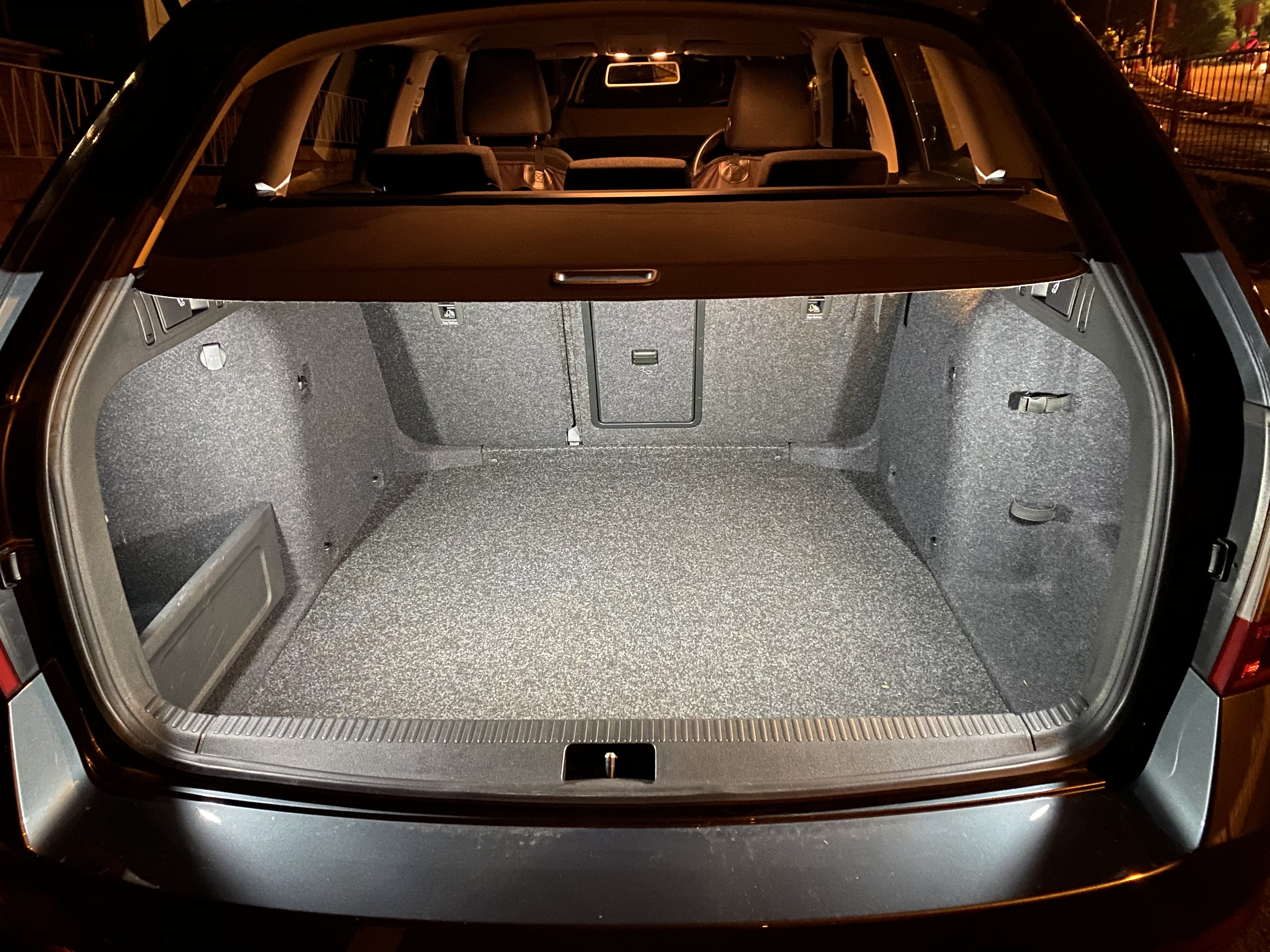

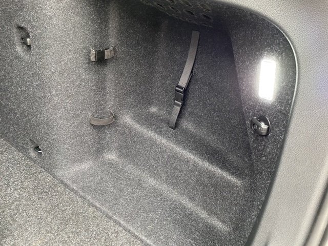

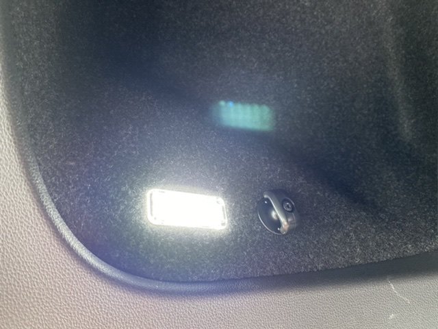

And boot lights I linked earlier from AliExpress arrived and have been fitted. 30 second job. Considerably brighter than OEM.

Evening shot
