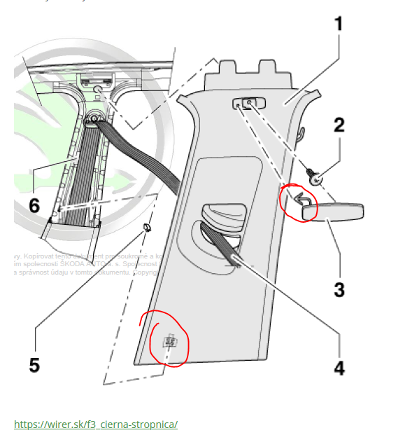

Thanks for the information - that's great.
Can you tell me what the circled arrow means? Does that mean to push this tab to the left to get it to pop off to access the screw?
I've got a trim removal kit - can you recommend the best tool / way of getting this off or does it just come off easily once the screw is out ?
Also, what is the other circled item, please?
it is a picture from the workshop manual. the part in the ring is just a "fuse" so that the part with the word airbag does not fall out
