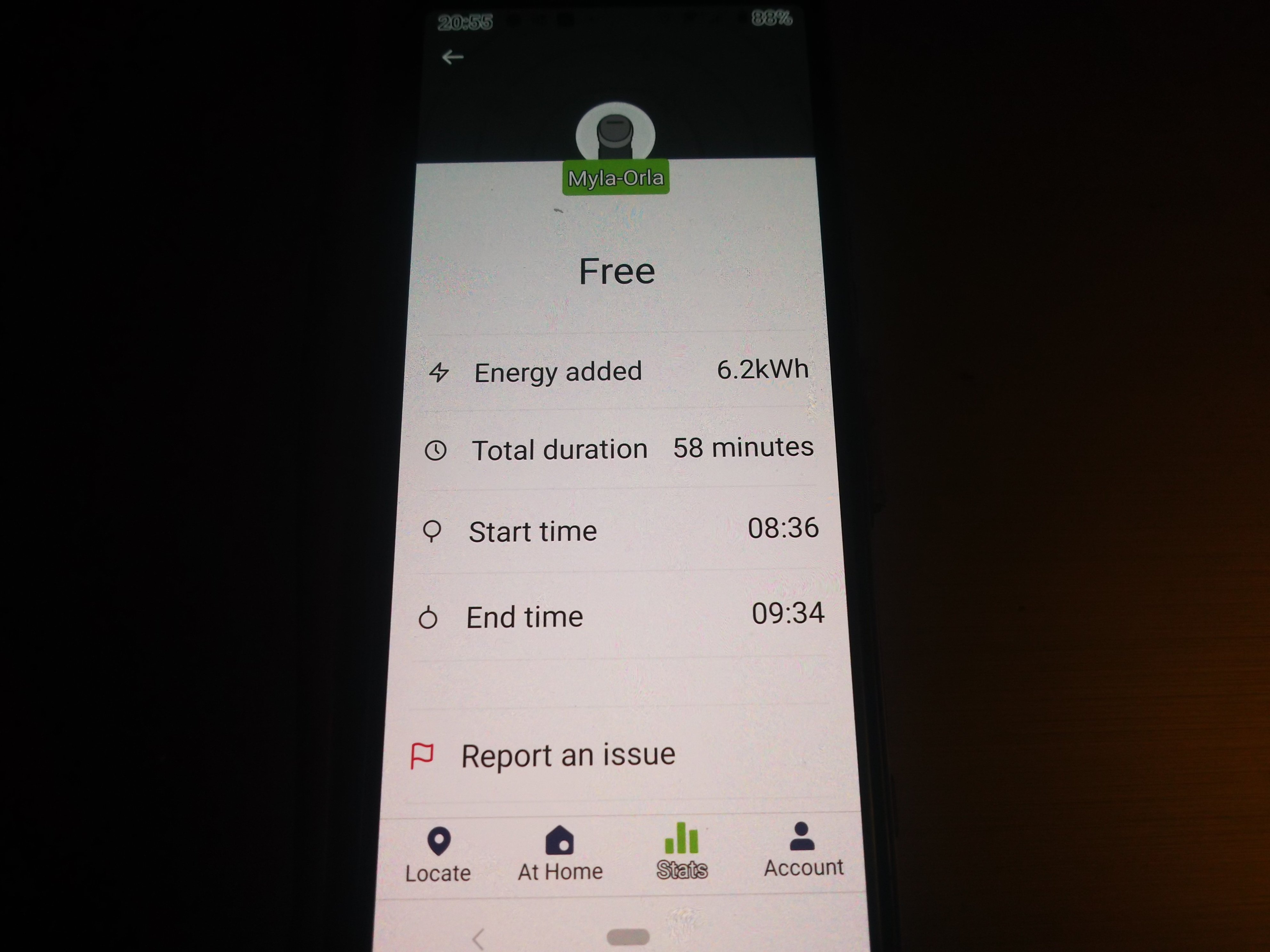

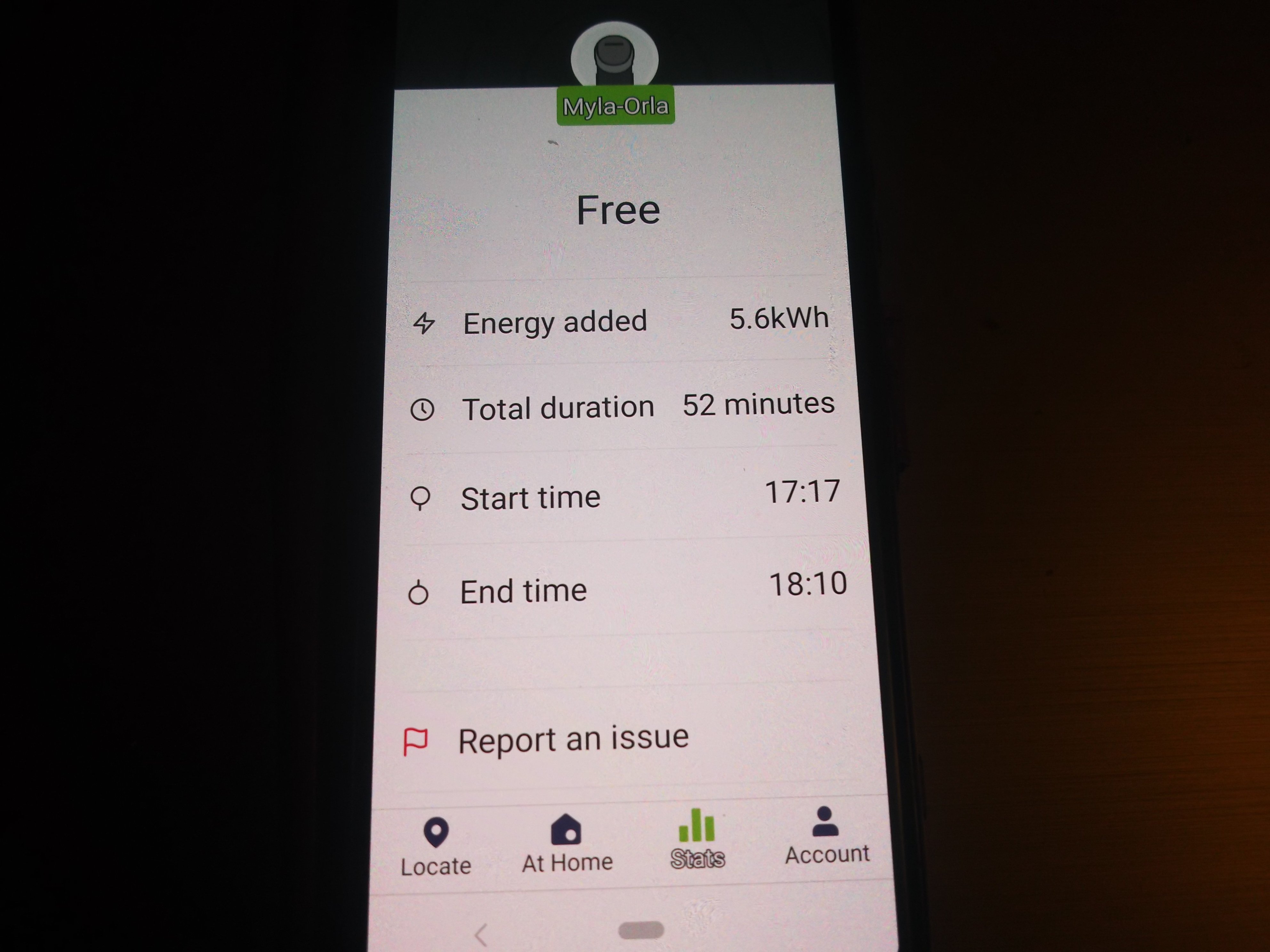

Most Skoda dealerships have 3-phase 22kW PodPoint chargers which will, when using the Skoda supplied (3-phase) cable, charge at 7.2 kW/h. The problem arises when using a wall box at home connected to a 240V single phase A.C. supply.
The problem definitely lies with the car. Mine has been back for a number of software updates, including one specifically for the charging control system. The issue I had was that the MySkoda app and Move & Fun app were both trying to control the MAX charge rate in an incompatible manner. I have created a video below which demonstrates the problem.
The solution in my case was to use only the Move & Fun app for controlling the charging rate, and I can now get the car to charge at 7 kW/h when using the charging plans (which Move & Fun confusingly terms 'Locations').
@RichardLP
Are you able to rock up to a PodPoint 7kw charger plug in your own type 2 and get a charge at 6.6-7.2 kWh?
Yes - using my own (not Skoda) single phase 32A Type 2 lead.
