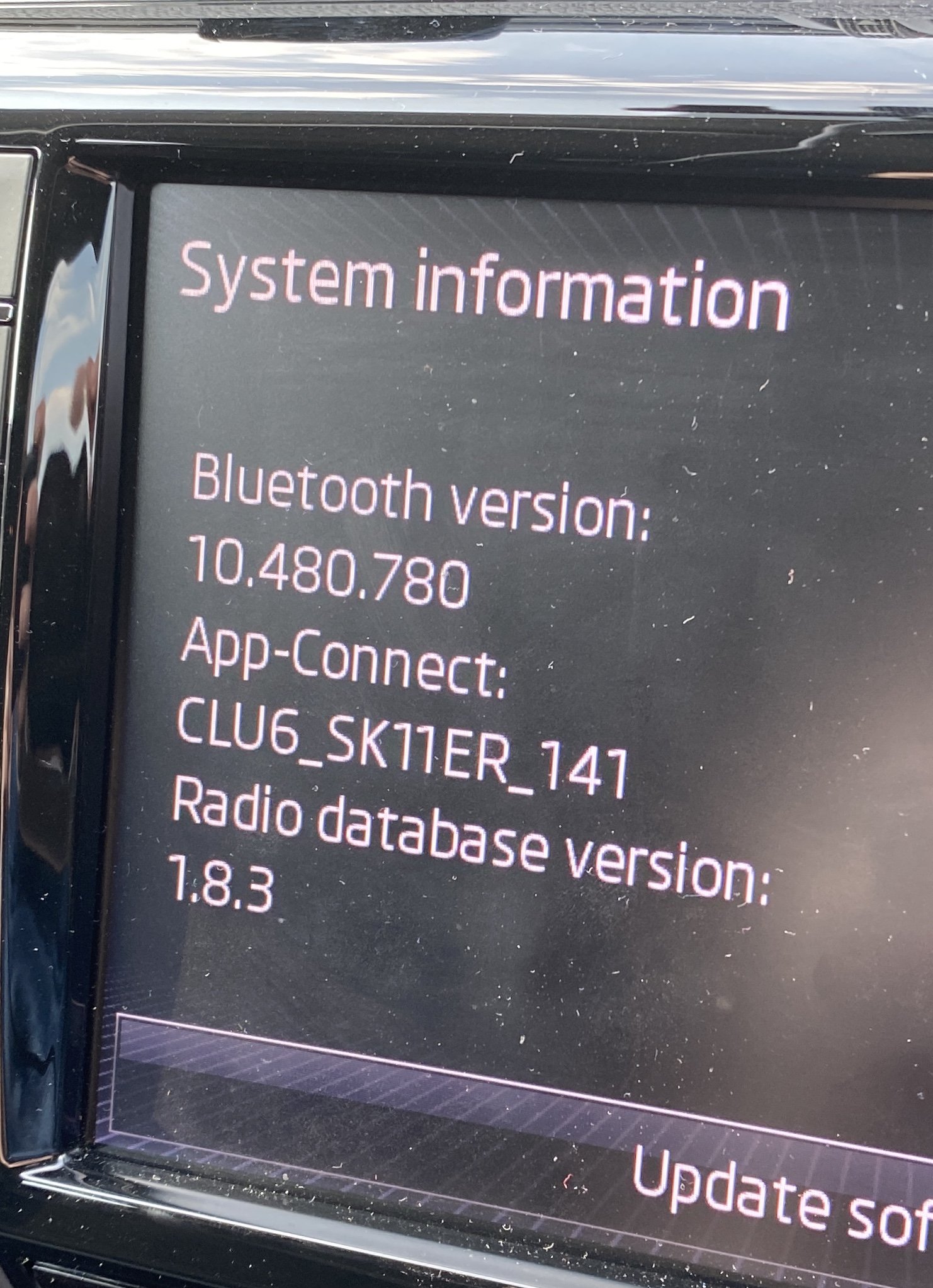

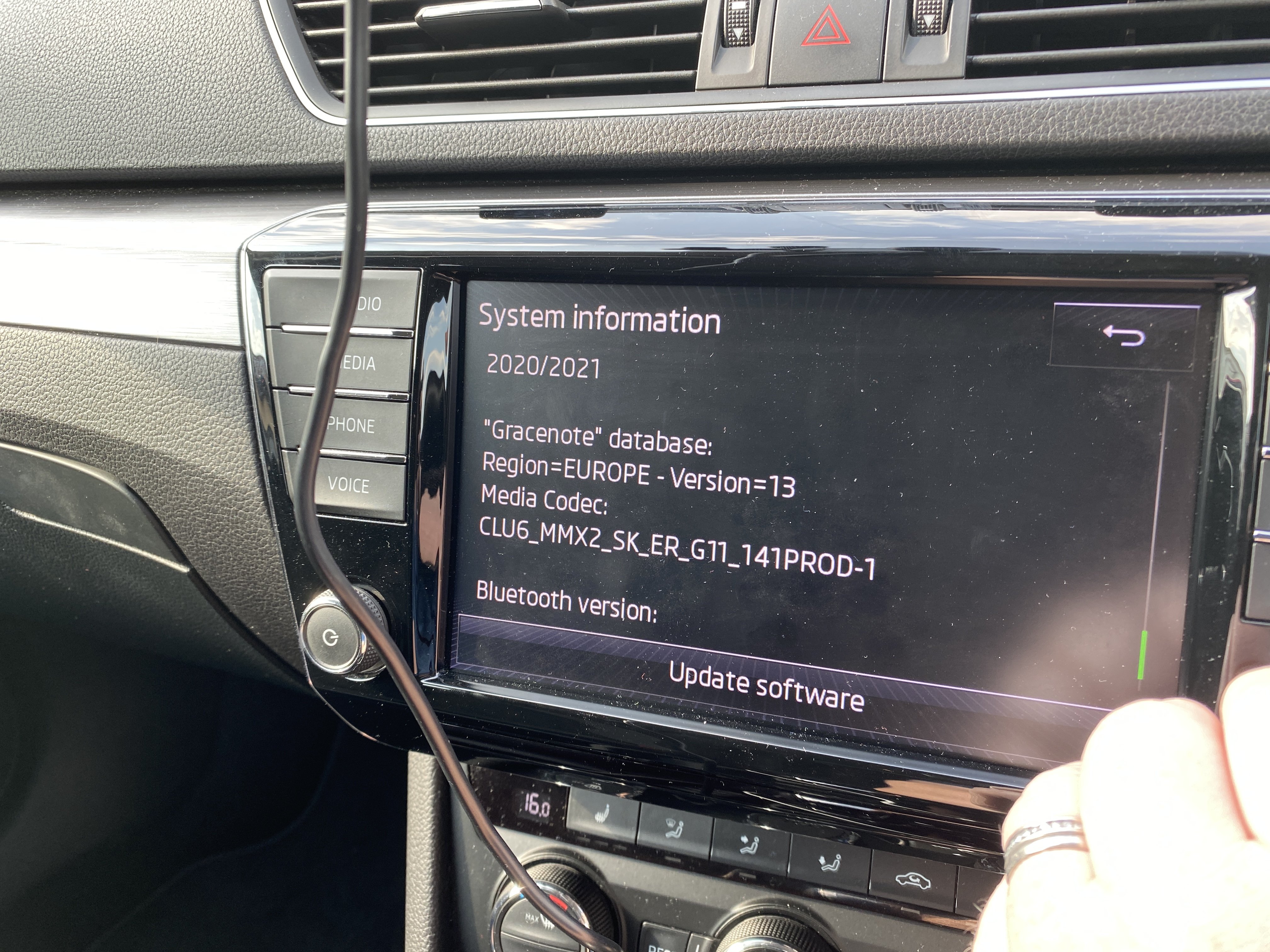

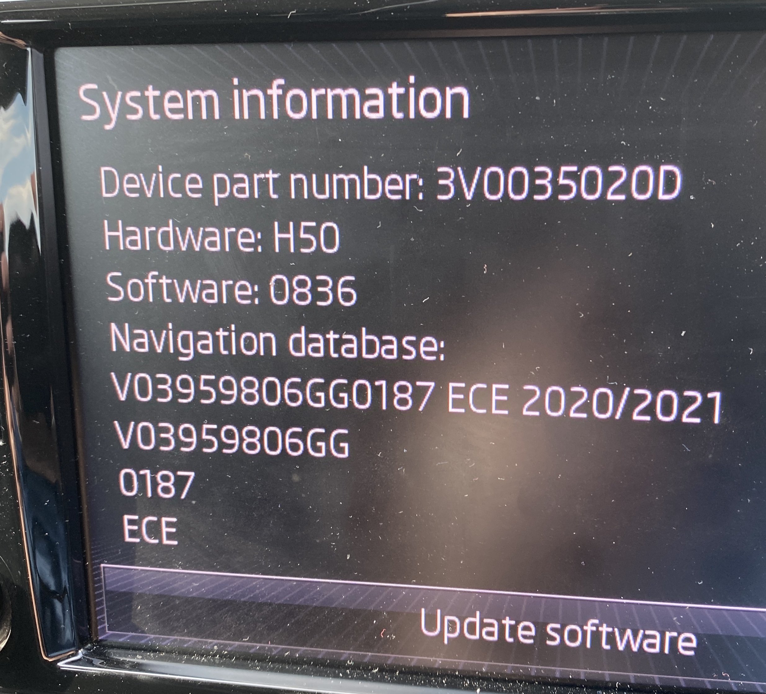

Anyone know the latest firm ware for the cars head unit I think it’s a MIB2. I’ve updated the maps already

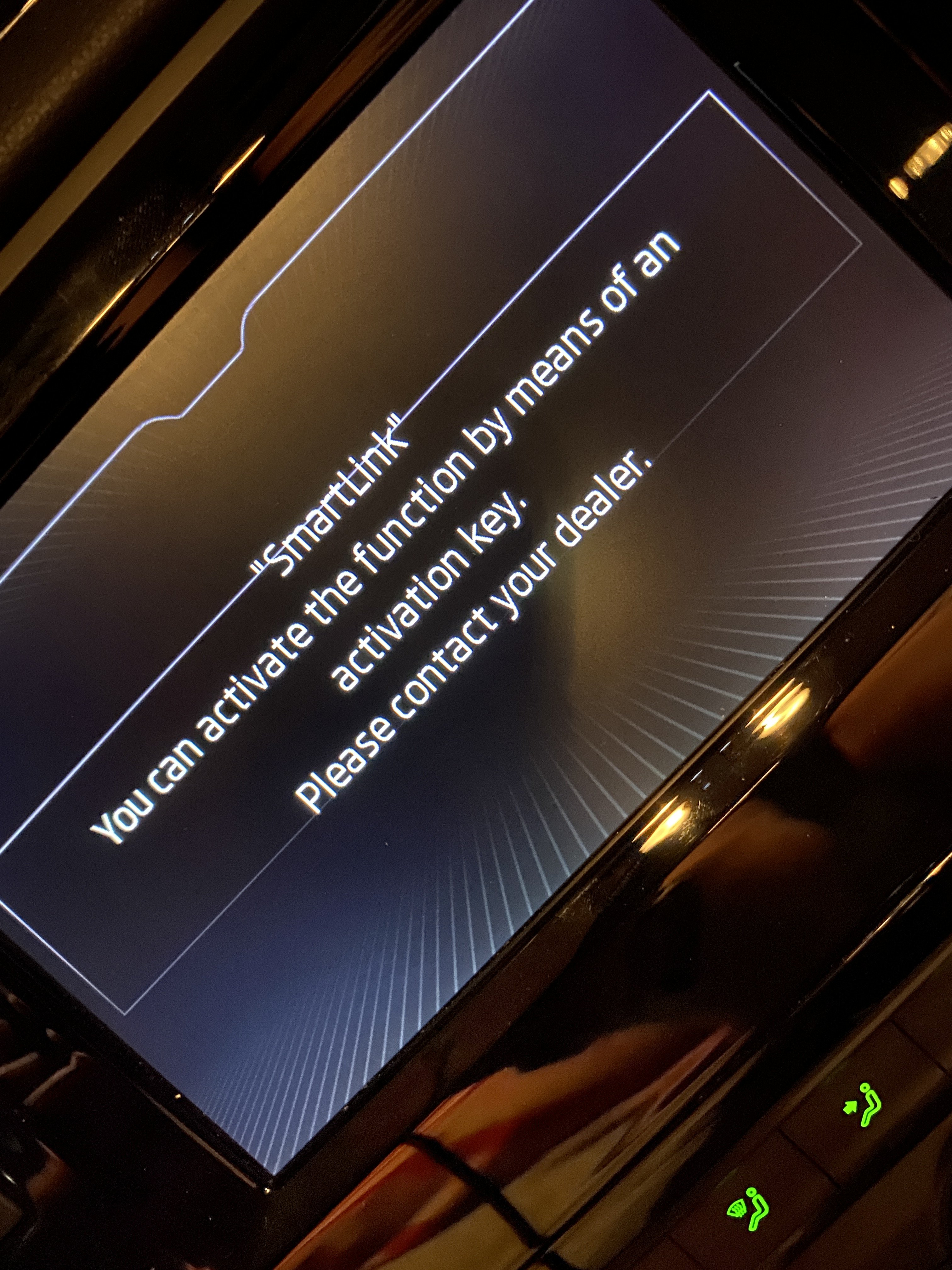

oh I did notice in the Octavia when I plugged in the cable this came up on the screen! What’s that about??? Shall be ringing the dealer tomorrow
Android Auto and Apple CarPlay was a chargeable option with the early cars!
