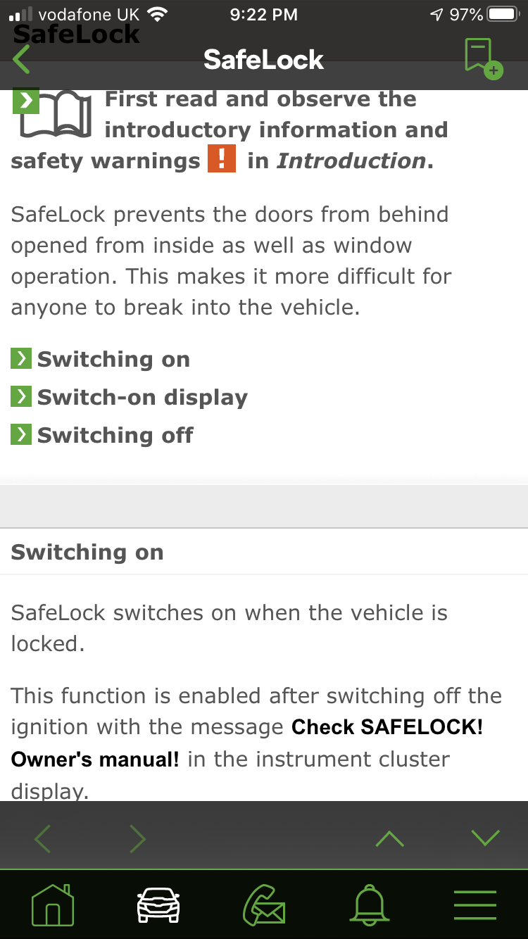

Safe lock is what is displayed when switching the car off?
I get this display when it fails to start ....  every time it happens starter does not operate and the display says "Check SAFELOCK! Owner's manual"
I am not locking the car, I am pressing start button.
I am not trying to lock the car.
