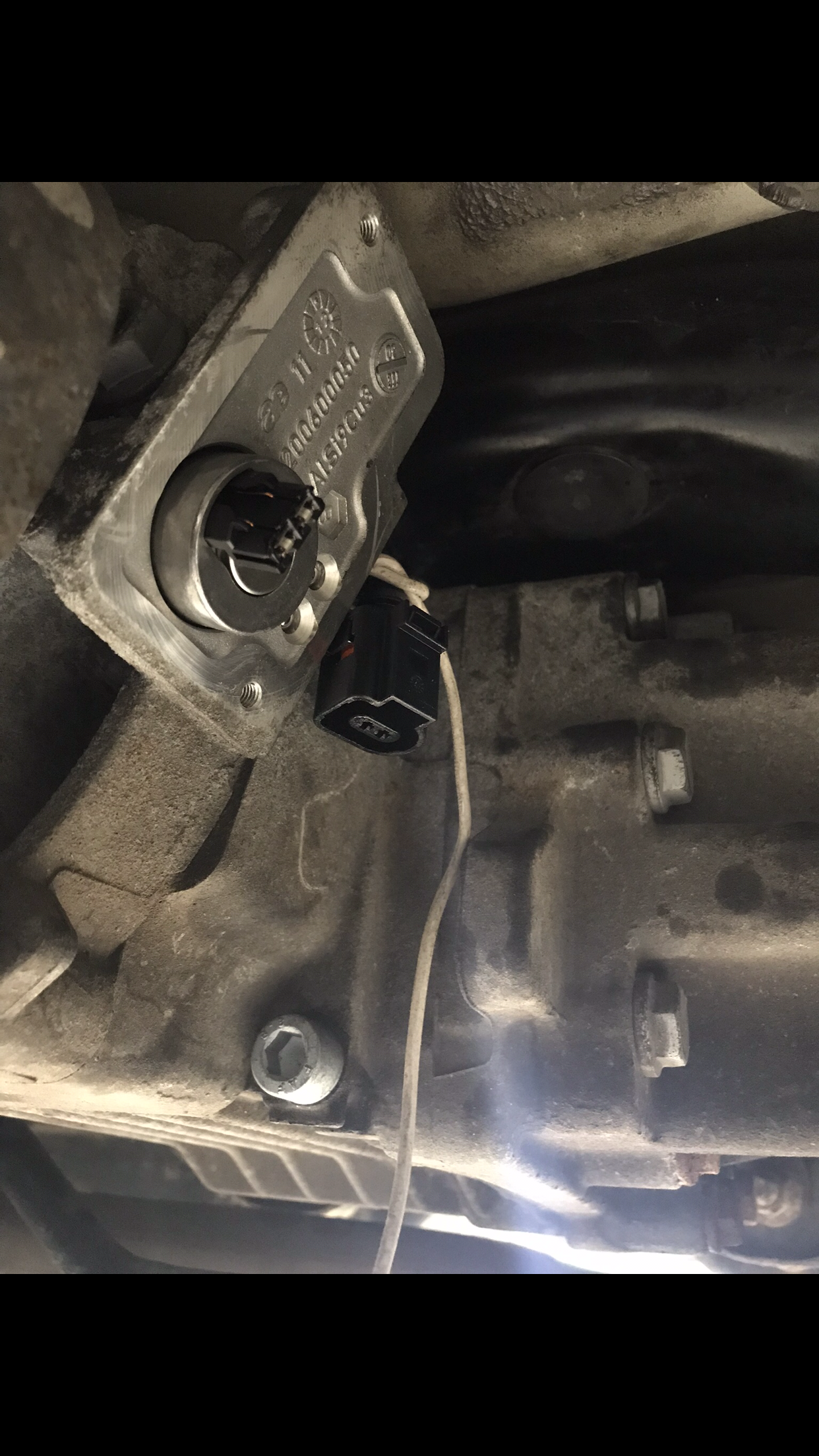

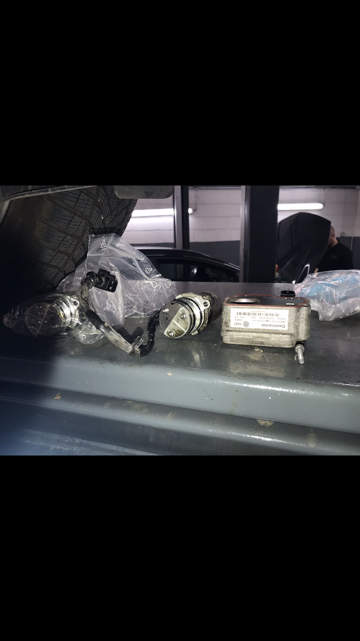

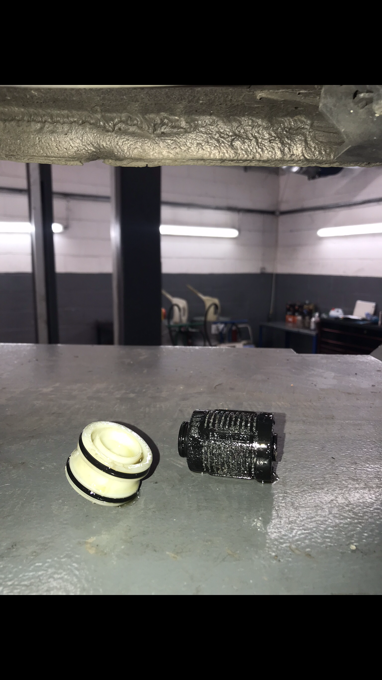

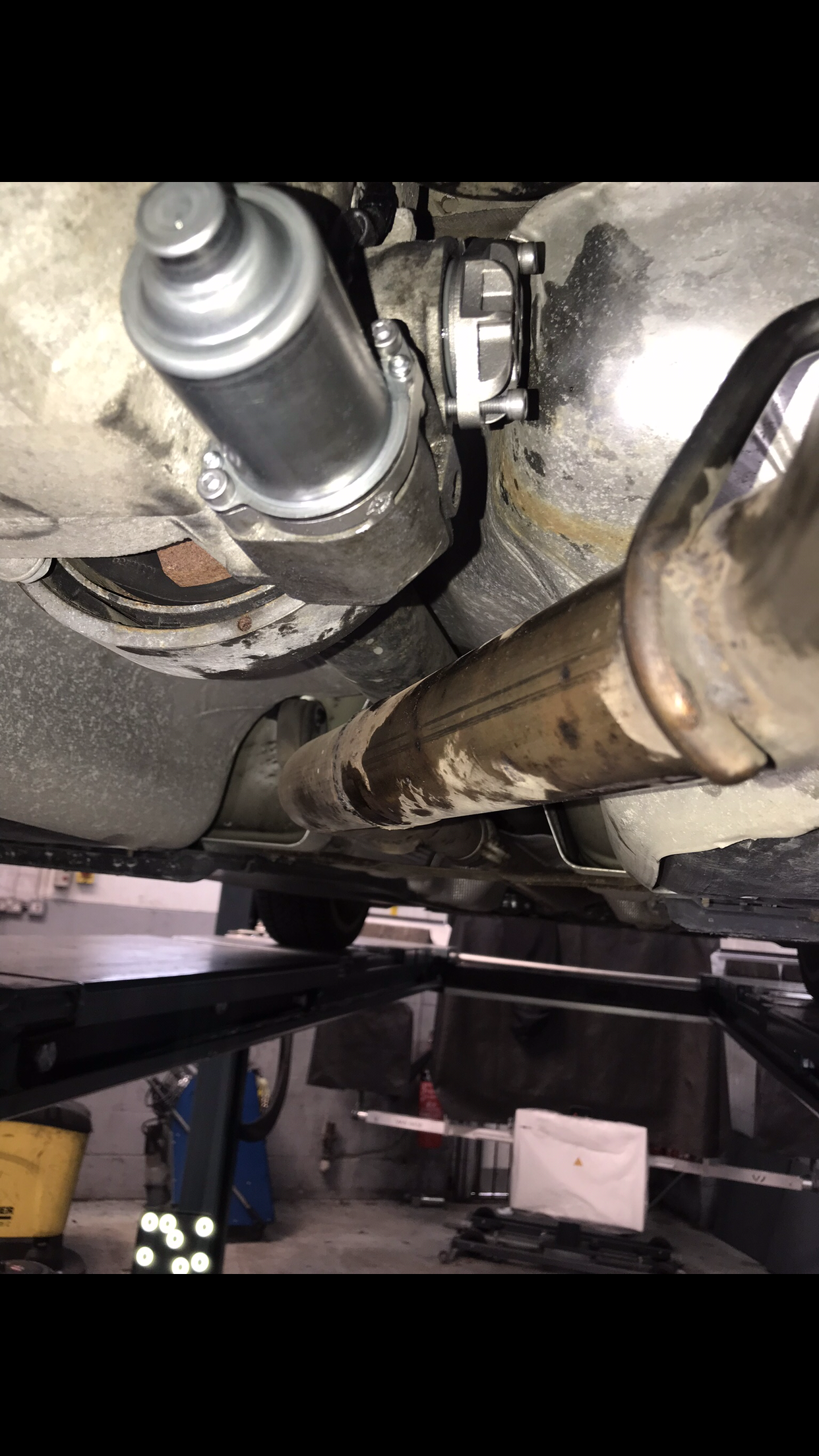

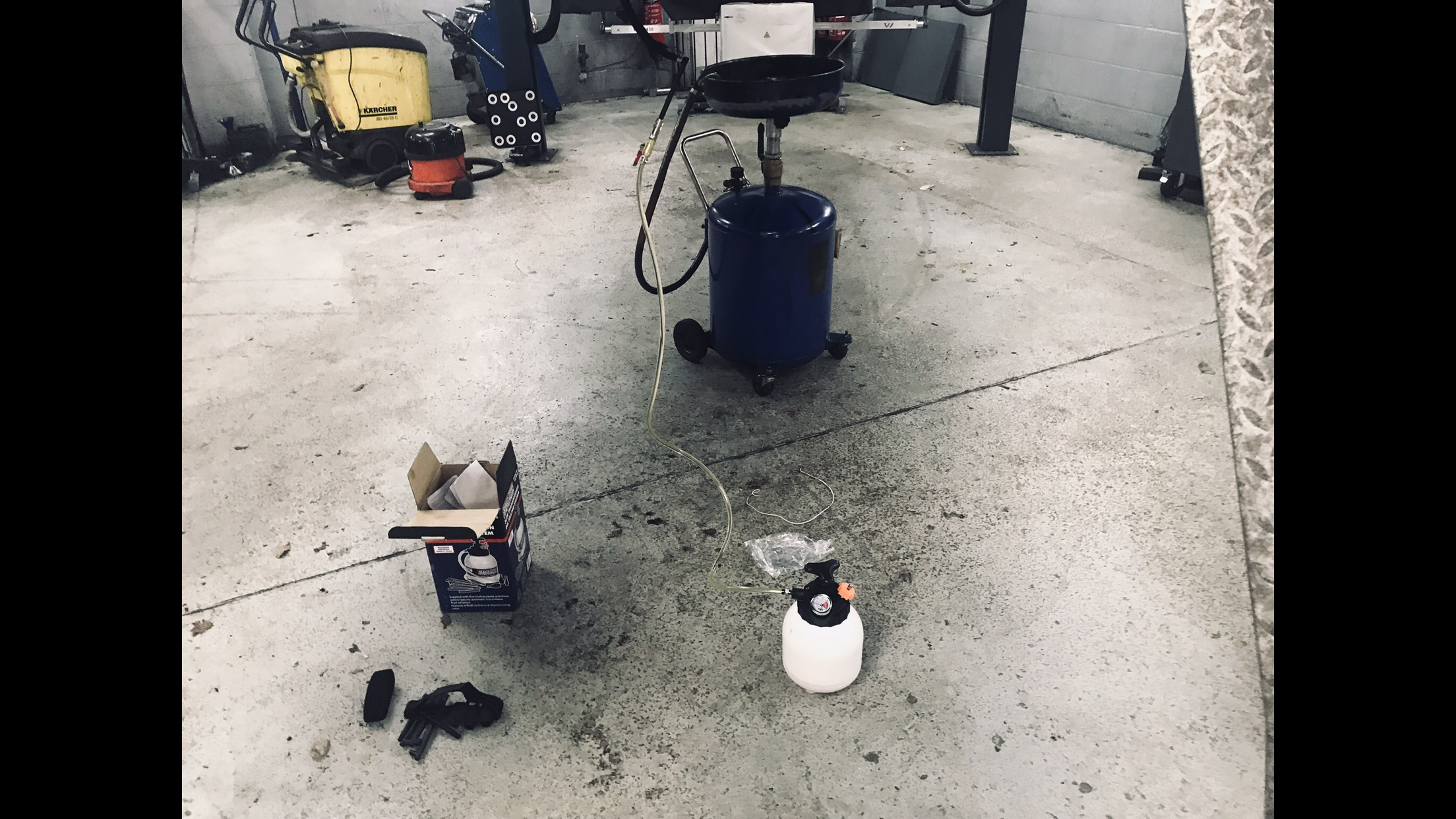

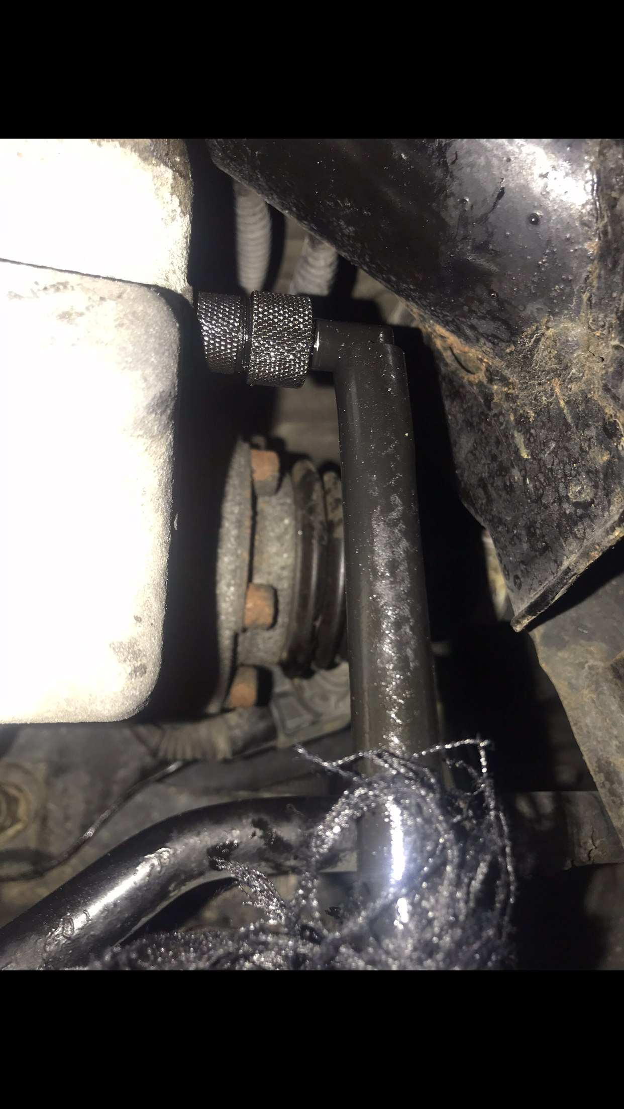

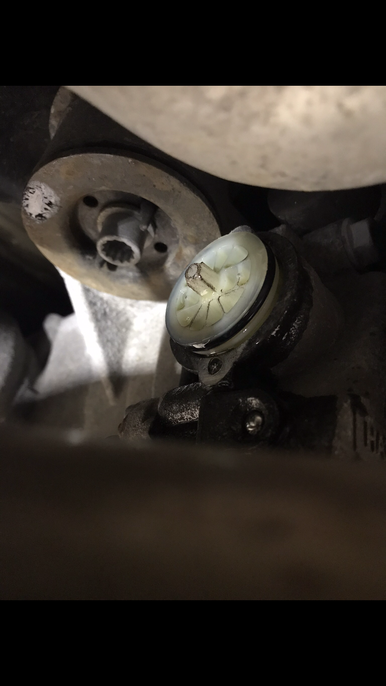

A few pics from when I replaced mine.
Friend let me use a ramp which makes it much easier as I’m old.
Tip for your mechanic, tie wire to the pimp plug, much less frustrating routing it across the diff unit.

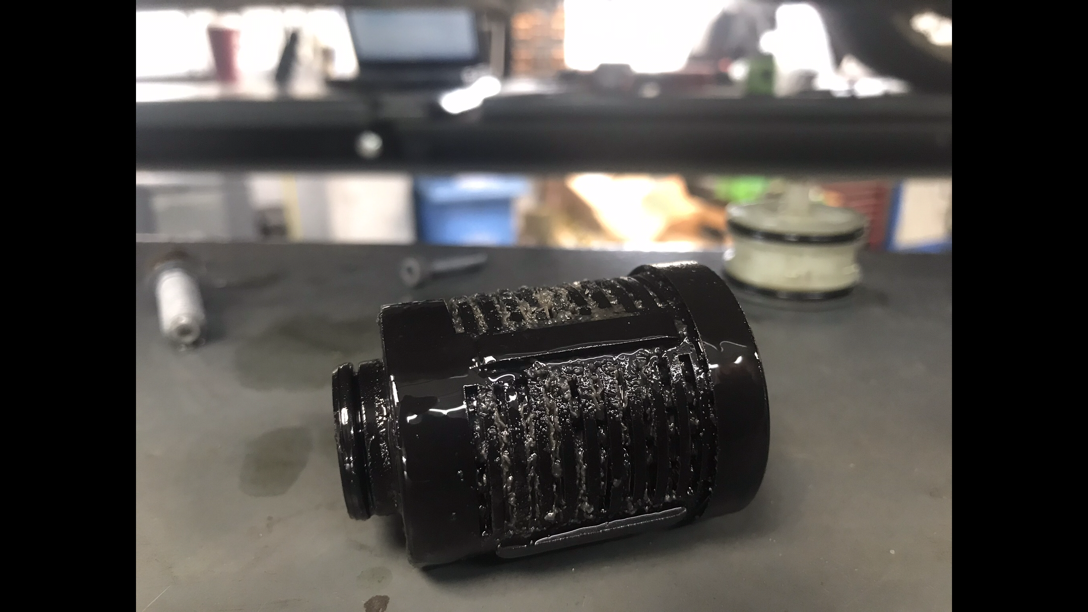

How does a filter get so clogged?
Great trick with the cord on the loom!

The filter catches the fibrous friction plate material when it wears off the plate surfaces during normal use, which when mixed with the oil, causes a sludge buildup. This causes the pump brushes to burn out as the pump has to work much harder pulling more current which heats up the carbon brushes which is why it's intermittent to start with but as the brushes wear further they no longer make contact with the motor commutator, the braided wires hold the brushes away until the pump body is lightly tapped then it will work again for a bit. I kept my old pump, at some point I will take it apart and replace the brushes and have it as a spare. But the filter will be getting replaced at every oil change, mind you it hasn't done 50K yet so may be a while as don't use it that much.
