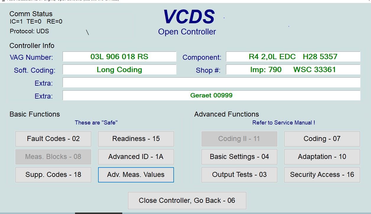

I tried to use the measuring block apporach, but cannot get into the measuring blocks in STG 01 as it is greyed out. Is there a way to make button 08 accessible?
Your ECU doesn't support measuring blocks. Use the adv meas values instead 👍
I did look through those, but I could not find a value with a similar name to block 011 - actuator, N75, Turbo actuator...- in the measuring blocks.
It won't have 'block 11' or any other block in the name - that's specific to the older measuring blocks for pre UDS ECU's.
