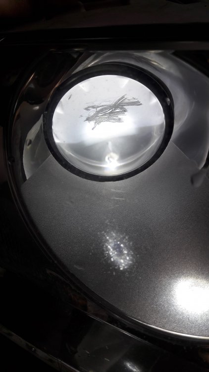

You could find the insides of the lenses quite dirty too, Micky.
This is a picture of mine with a torch shining through it from the inside before cleaning, just touched inside to show how dirty it was.
Edited by Tilt
How did you get the units apart? Or did you take a proctological approach to the problem?
Cleaned it through the bulb hole Mick. (no euphemism, Lol) As the units are so easily removable from the car, quite easy really.
Just a thick stick (even back end of a pencil) with a few pieces of soft cloth wrapped around it. Worth doing.
The reflectors would be considerably more difficult but mine looked clean.... but yes, logically they must have some crap on if the lenses have.
