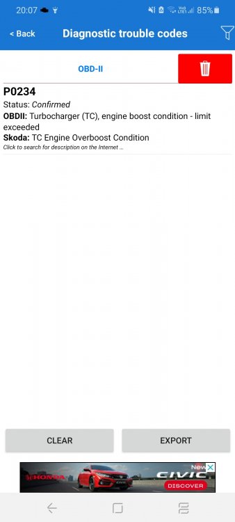

After connecting cheap OBD reader the code stored was P0234 turbocharger, engine boost condition - limit exceeded.
