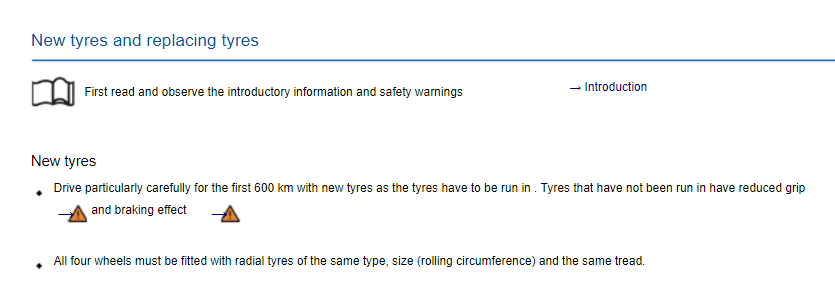

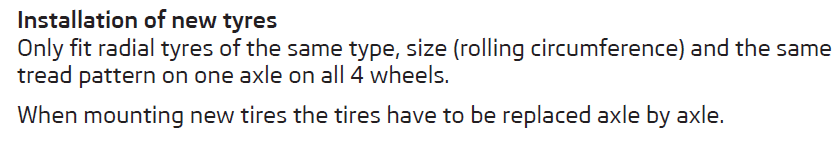

Where is this documented please.
From the owners manual

For reference this is what VW say for the Tiguan:
