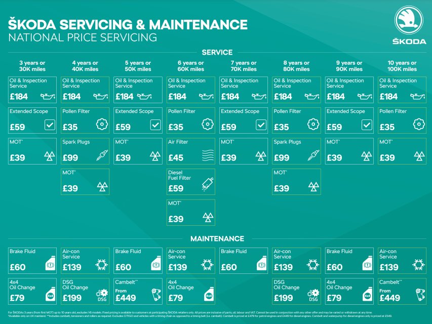

Spark Plugs changed could be 'Simply Clever' @ 4 years.  That was the scheduled replace time when it was Minor Major Service time about.

The Spark Plugs used to be replaced at 4 years / 40,000 miles (2nd Major Service).  It might be an idea to replace them before the 60,000 mile interval that Skoda have started showing.
