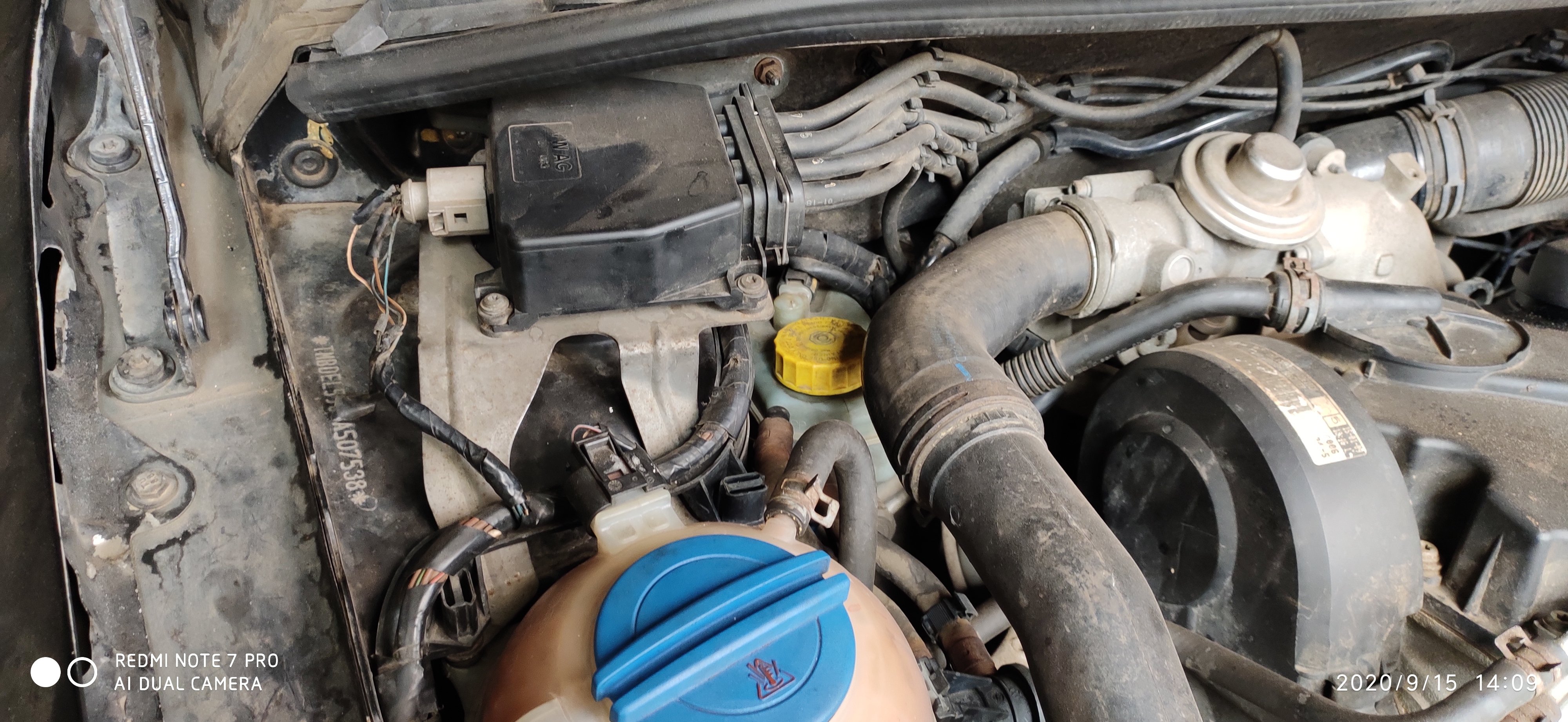

Need to know this module name.
What is the name of this black box in my fabia it's there?
Item 21 here so you know what it is, but no item number and car details assumed as you have not included any details:-
https://skoda.7zap.com/en/cz/fabia/fab/2006-453/1/131-131040/#21
Item 18 here but various numbers/versions.
https://7zap.com/en/catalog/cars/skoda/brand/17/0/Fabia/Fabia | (2000 - 2008)/Skoda/bGxRR1dmQXRRbDN1empZYmhDTUwxQT09--/6bbffde8b5b8077d2d0a5796da6eea3c:4605b9fa9f58b89615257f1a0f7ac42d/manufacturer/9/225906000::906000

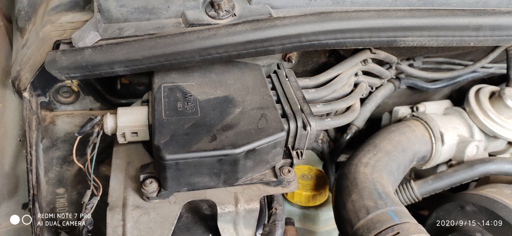

If those photos are of your car, are you sure it's not a problem with the wiring rather than the module?!
Valve block is its official title, but quite often refereed to as the vacuum box.
Doesn't look like a MK1 Fabia.
  • Sponsor
Good spot> Think I'm seeing 5J in the middle of the VIN, so a mk2?
So probably one of the two item 18 part numbers here: https://skoda.7zap.com/en/cz/fabia/fab/2008-608/9/906-906000/, depending on engine code.
But please check that wiring near the box, it looks like it must be improved.
