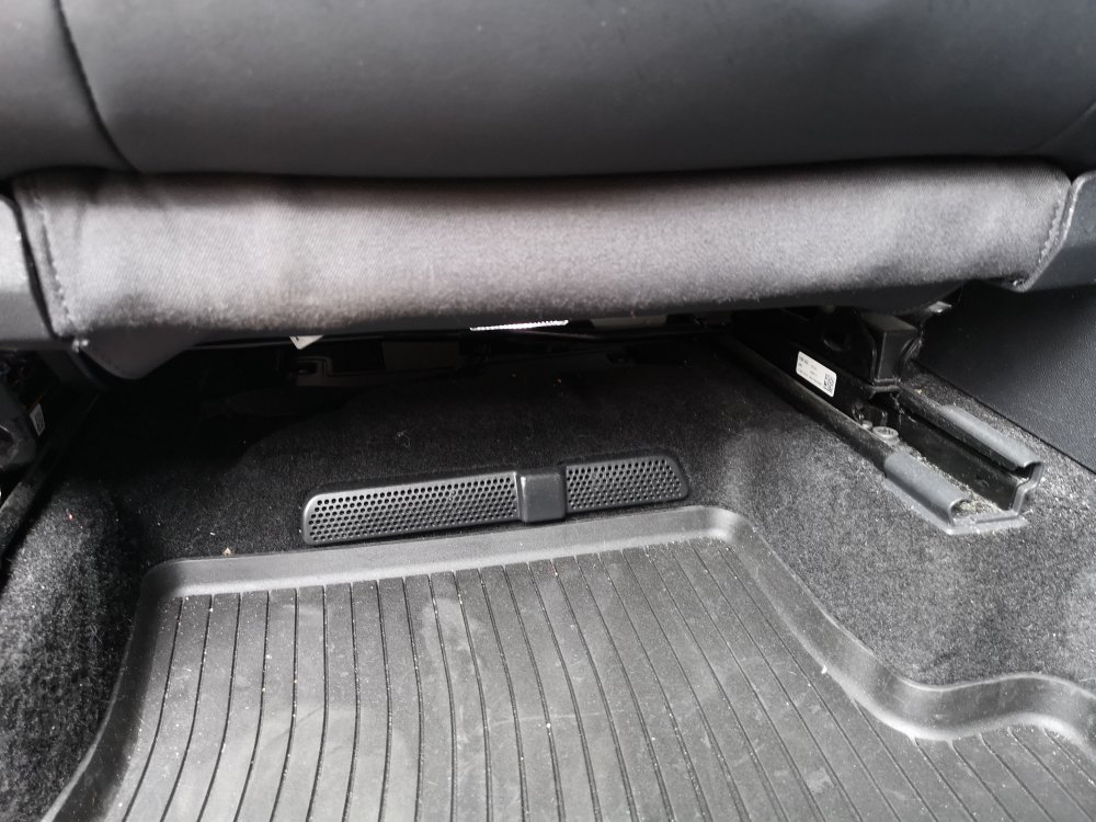

Here's the backside of the front passenger seat. Start by removing the two small plastic clips on holding the plastic covers on either side of the seat. Do so by pushing the pins in the middle all the way through, then you can pull the clips out.
