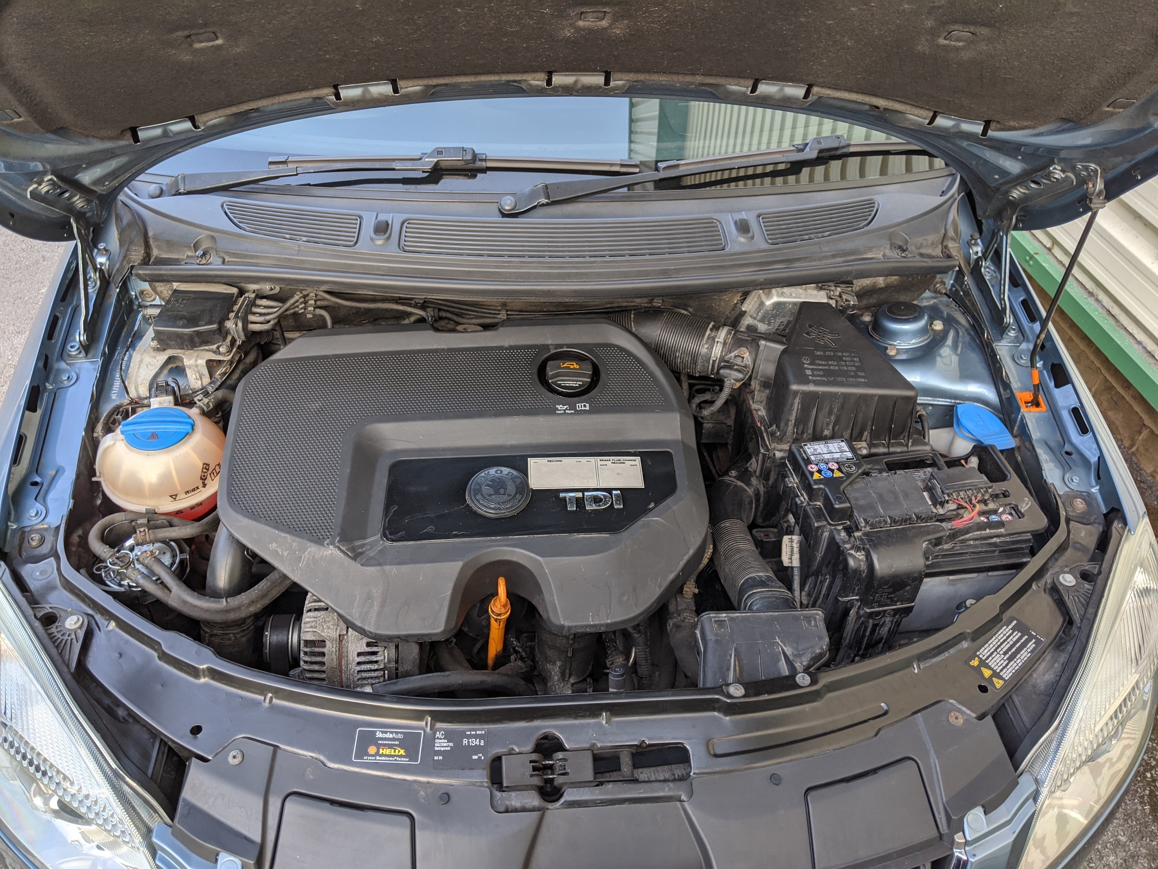

I gave it a go (20 minutes or so of a job) and it came out quite well. I powerwashed the metal at the sides and took the engine cover off and sprayed that after applying some Elbow Grease degreaser, and it came up really nice. I just used a moist cloth to wipe gunk off after I'd degreased everything, it certainly looks a lot better than it did on the surface, but it's far from perfect down below. I'll try and get a picture up
Once its dried spray all the plastics and hoses etc with 303 and let it all sit and dry in. will make it look even better than it does now, and its quick and simple.
Here's a picture! As I said, not perfect but not too bad at all
