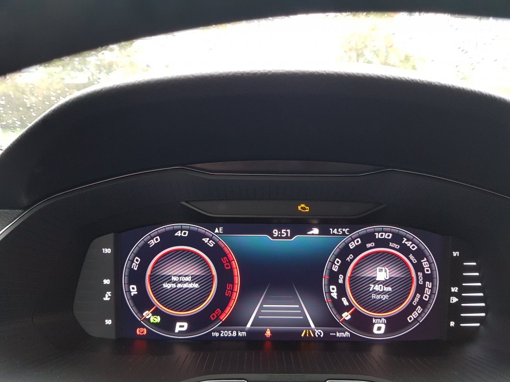

  • Hello  Finaly i have done it  with the help of Vagguide. https://m.facebook.com/vagguide/ My car is 2016 version , i had to change BCM and GATEWAY  so that everything was functional. I had t
Does anyone know what is the correct part for the trim below the cluster in my case 3V0857053NF8 or 3V0857053ANF8 to be used with virtual cockpit ?
 NF8 is the correct color but i don´t know if i can use the trim i currently have, it seams it has to be diferent.

On 02/02/2021 at 16:03, Camarao69 said:
Hello
My car is 2016 version , i had to change BCM and GATEWAY  so that everything was functional. I had to replace the trim under the dashboard  was well .
This retrofit depends on the MY of the car , after MY17 i think you only need virtual cockpit.
looks great!  Is this the VC from ali? Was it an original part?
I did buy it from ALI it is original one but maufactered for China market, it will have another part# but it is fully function and has absolutly the same features languages etc as part for EU

Hello , yes i buy from ALI, it is a original part from China, but it works the same.

i really want to go ahead with this, but my dealer is unwilling to do the needed coding via odis. How was your VC coded? Was it done remotely? What were the cost?
I had my VC coded remotely using a vas5054a. It was the immobiliser, key pairing, odometer and component protection.
I tweaked the lcode and adaptions afterwards to get things working perfectly using VCDS.
It'll depend who does it but I'd expect it to be less than €100...
As my car is a MY18, I only needed to add the MOST optical cable, replace the under dash trim and replace the steering wheel buttons (view button) to get the factory fitted feel 👍
