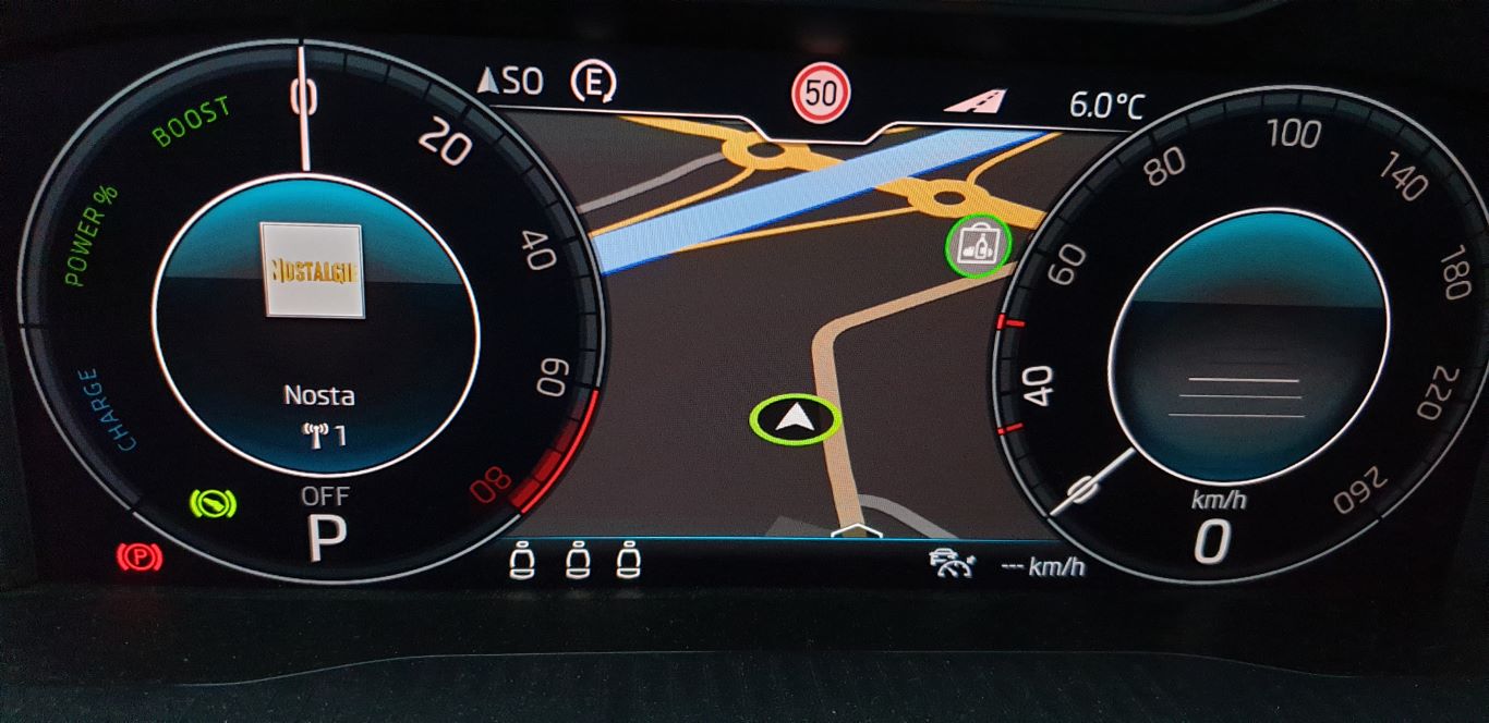

3. Is it possible to get navigation data on retrofited VC (see photo below)?
I appreciate all kind of help, because this is not a cheap adventure, and please respond questions respectively for better understanding.

On a 2015 you'll probably need a new gateway and BCM as mentioned here: https://www.briskoda.net/forums/topic/485142-virtual-cockpit-retrofit/?do=findComment&comment=5500623
Not sure if you need a trim piece on a Superb?
For the navigation maps to show, you'll need a MIB2.5 headunit and add a MOST (optical) cable.
Ideally, you should also fit MFSW buttons with a 'view' button to get it working 'as factory'.
Yes, on a new VC you can program the mileage to match. On a used VC, it can be increased but not decreased.

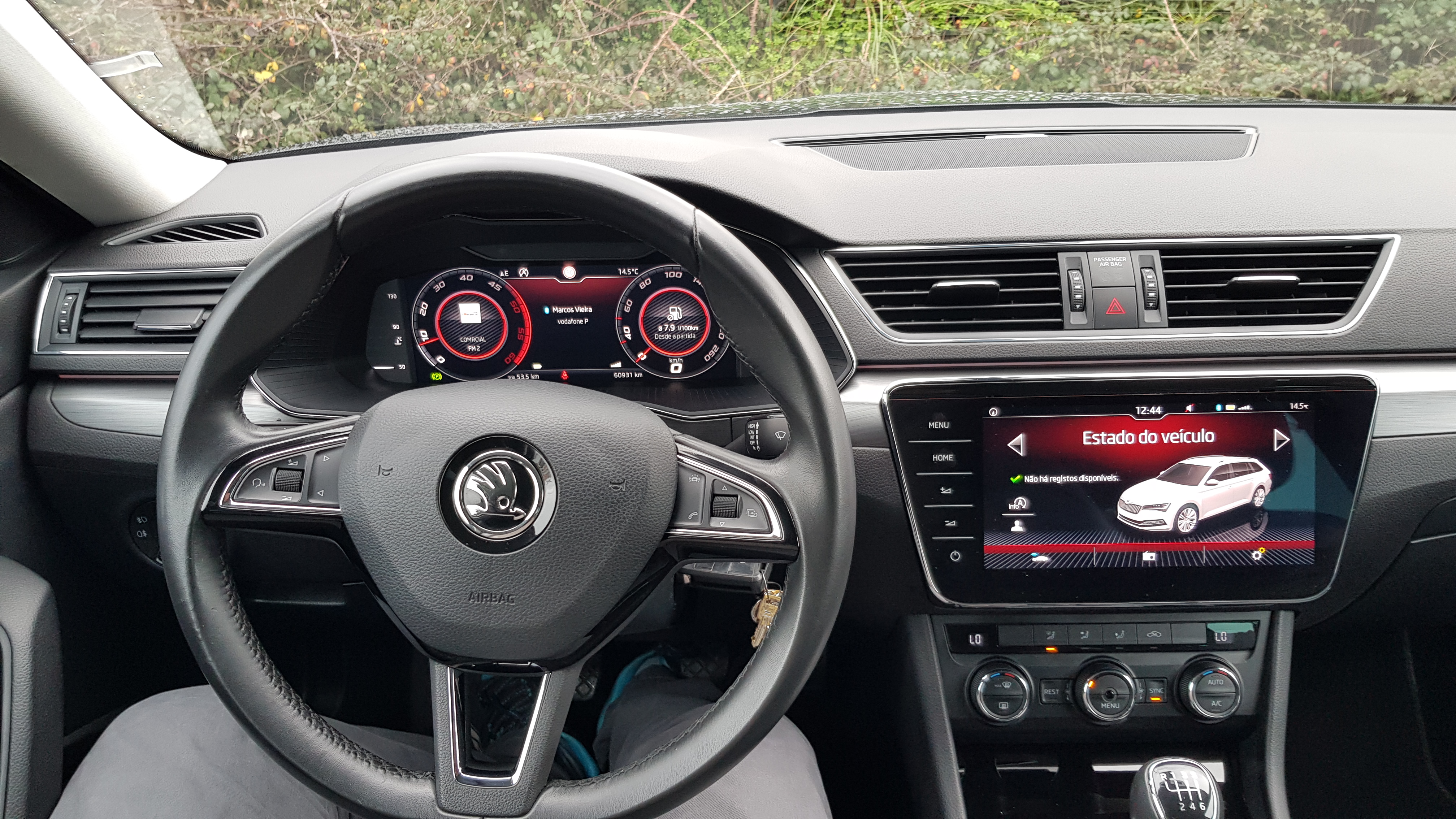

Hello,
The graphic look is different in my superb IV sportline... yours is better! more sport!
Do you think it's possible to modify it?
Thanks

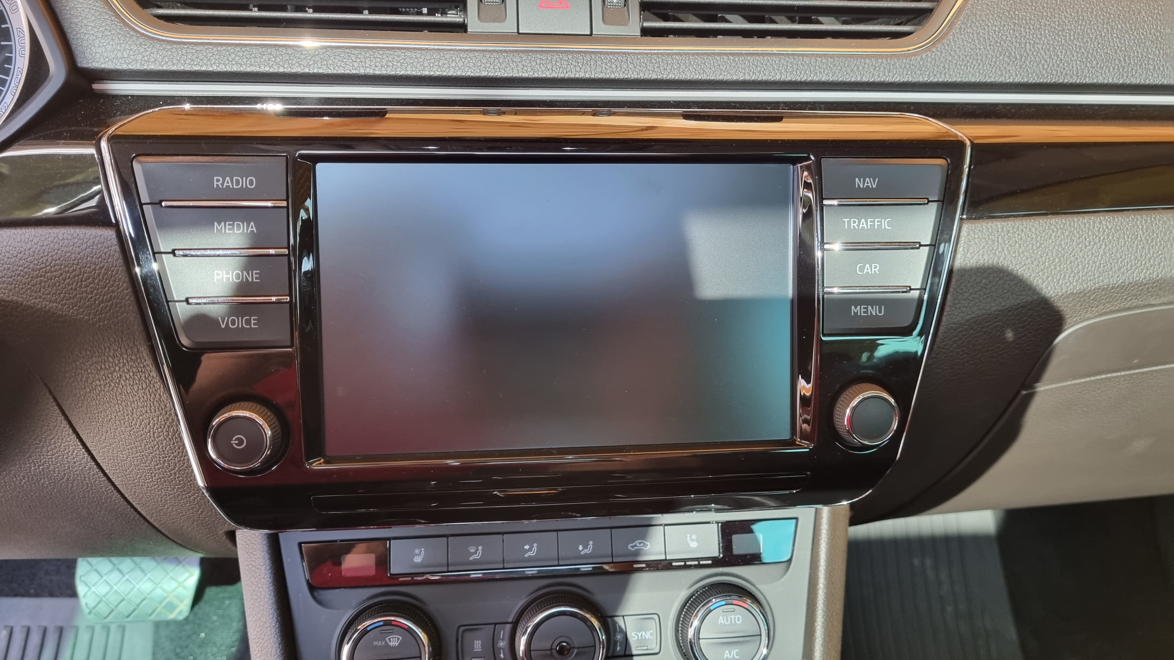

Is it necessary to replace both touchscreen display and unit for mib2.5 or just display?
Does toucscreen display from mib2.5 fits in place of mib2?
It's the headunit that needs to be running MIB2.5 software.
I believe you can rework a MIB2 Amundsen into a MIB2.5 Amundsen and keep the original screen.
You can also rework a MIB2 Columbus into a MIB2.5 Columbus but you'll need a new 9.2" higher resolution screen.
By "rework", do you mean the glove box unit can just be firmware updated from mib2 to 2.5 if you have the 2.5 screen?
Yes, I believe that MIB2 glovebox units can have the firmware updated to become MIB2.5. This is not 'just' a firmware update, I think it's more involved and involves rewriting parts of the EMMC directly. @pab567 knows more :)
I'm pretty sure a MIB2.5 Amundsen can use a MIB2 Amundsen/Columbus or MIB2.5 Amundsen screen.
However, a MIB2.5 Columbus needs the larger 9.2", higher resolution MIB2.5 Columbus display.
