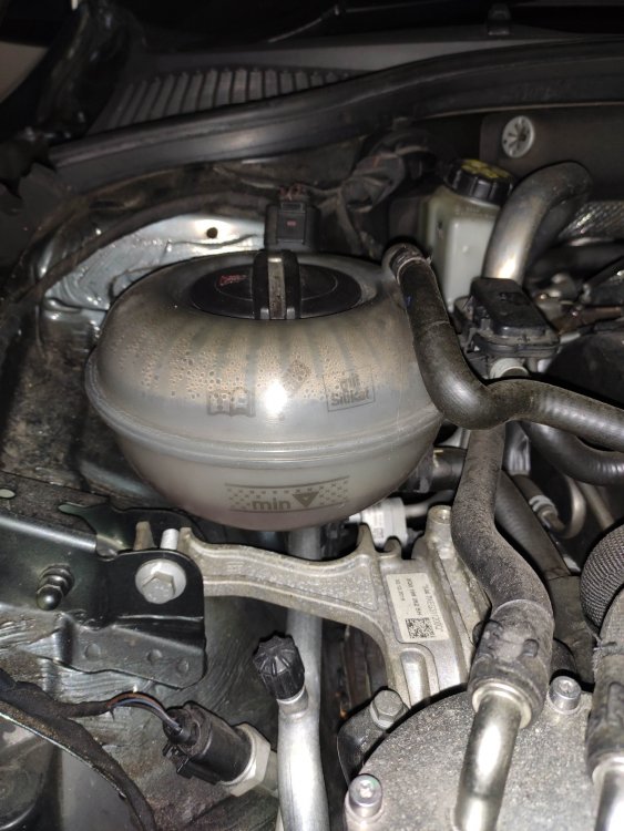

I am driving a 2016 1.6 TDI.
I have been losing coolant slowly over 2 months. The low coolant red warning light comes on.
Seems to be hitting below MIN level every few hundred KM.
Never had the over heating temperature warning.
Pressure test was ok
I don't see any puddle below the car either.
Is this typical of the common failing water pump issue?

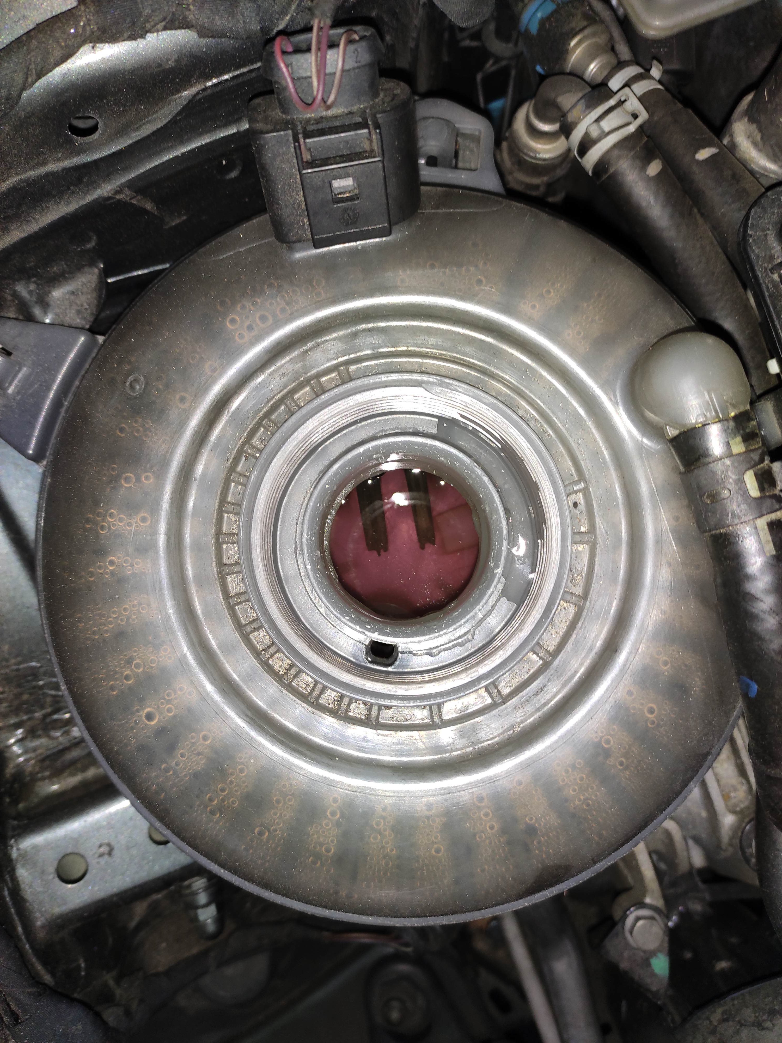

I took 2 photos of it cold and engine just started.
Edited by lab4games
IF there had been a lot of bubbles in the coolant header tank, that would suggest a failed head gasket or possibly a cracked block.  If the water pump seal fails you should see a puddle under the car after it's been parked a while.  It sounds like the OP's situation - a leak that starts when the coolant system pressurises as it gets to normal operating temperature or perhaps when the engine is worked hard and the coolant gets hotter still.  It could be venting as steam but in that case I'd expect the temperature to be above normal ie 100C plus

Managed to locate the leak today after another round of low coolant warning. Took a video.
I think is the water pump?
Sending in to the workship.
