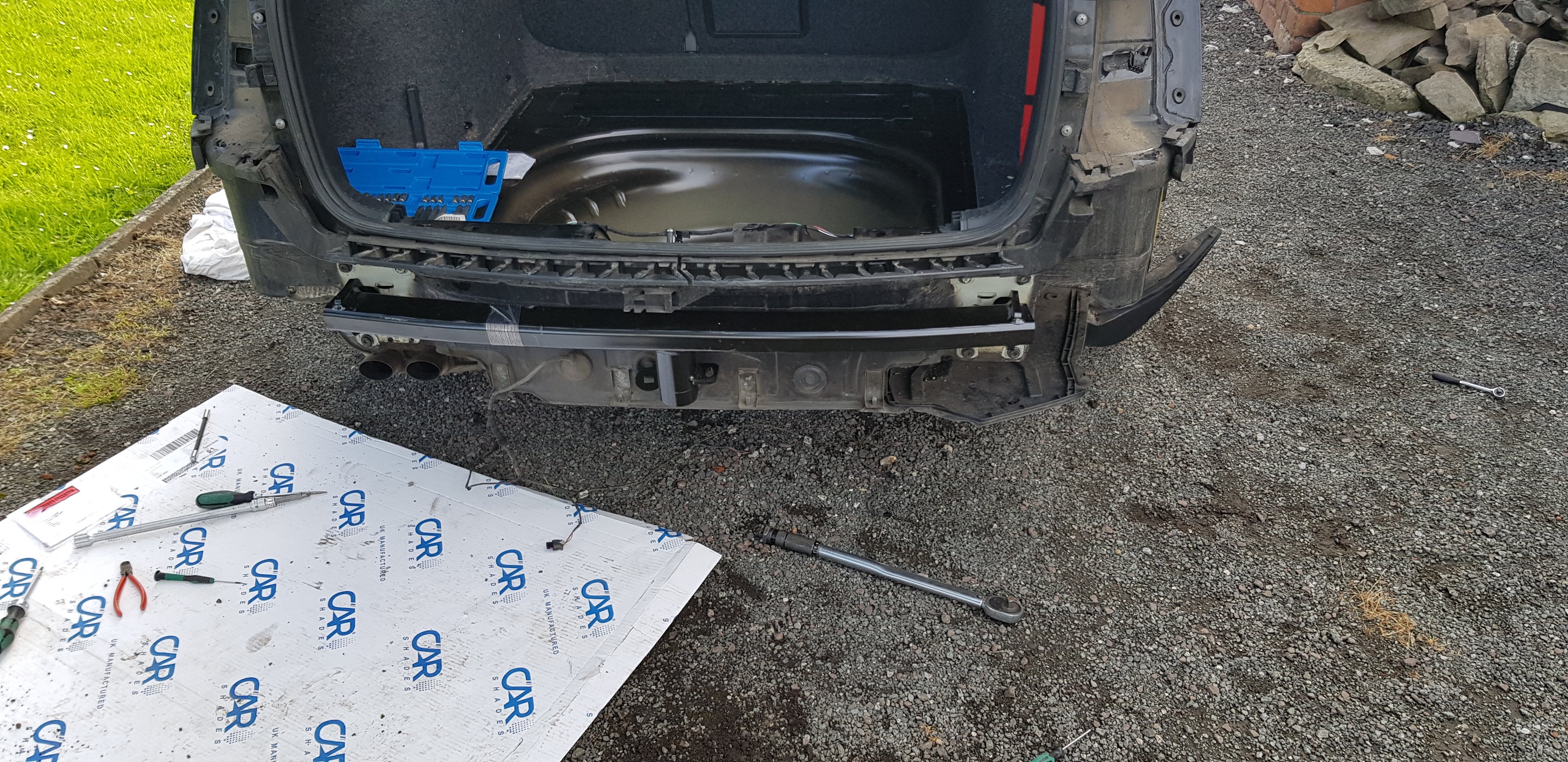

Obligatory pics attached..
More from the other side..
Zero access to install bolts through or into side of chassis rail.
Other point of note us that the crash bar mount on the left (passenger) side has only 3 mounting bolts, 2 on top but only one on the bottom. There us no facility to fit a fourth..
They will be there, not easy to see but go by feel. Use your finger and prod along the under seal, you will feel the patch covering the holes. Peel back, it comes away like a sticker.
This may sound silly, but have you had a good poke and prod at where the bolt holes should be?  As I read your post I had a vague memory of being similarly bemused once - it may well have been with my Octy - only to discover that the holes had been gunged over and painted so well that they were perfectly camouflaged.
Also for the side with the exhaust, I found it easier to drop the heat shield and use a 12in extension for socket on torque wrench to tighten the bolts.
Good luck

I took off the bumper again this evening and  felt along the length of the chassis leg. I found 2 areas where the body seal felt higher, used a screwdriver and scraper to remove body seal in those areas and to give a good prod along the full length.   Nothing.
On the passenger side I cannot even see the chassis leg, let alone get my hand in to feel it.
To do so I would have to remove the heat sheild and to do that I would have to remove the back box from the exhaust.
I even got a second pair of eyes to give it a look over.

I did my vrs towbar install not too long ago, I felt the same as you but the holes were there.
Measure the bolt holes on the towbar legs then measure the same distance onto the chassis, use finger not a screwdriver and you can feel the softness where the hole is covered.
I would be surprised if skoda stopped putting the holes in but you never know.
Did you have to remove the exhaust back box on the passenger side ? Or  did you find a way to get access and remove heat sheild ?
I dropped the exhaust off the rubber mount then unclipped the heat shield, it was tight but enough room to tighten bolts with a 12 inch extension on torque wrench.
Will take off the bumper again in the morning. (3rd time lucky)..
If I have to I will remove all the seam sealer on the leg . Either to find the holes or to confirm 100% they are not there..
Fingers crossed for you.
The stickers covering the holes were square if I remember correctly, 1inch x 1inch at most.
Look inside the chassis leg from the end with a torch, you will soon see the holes if they are where they should be.

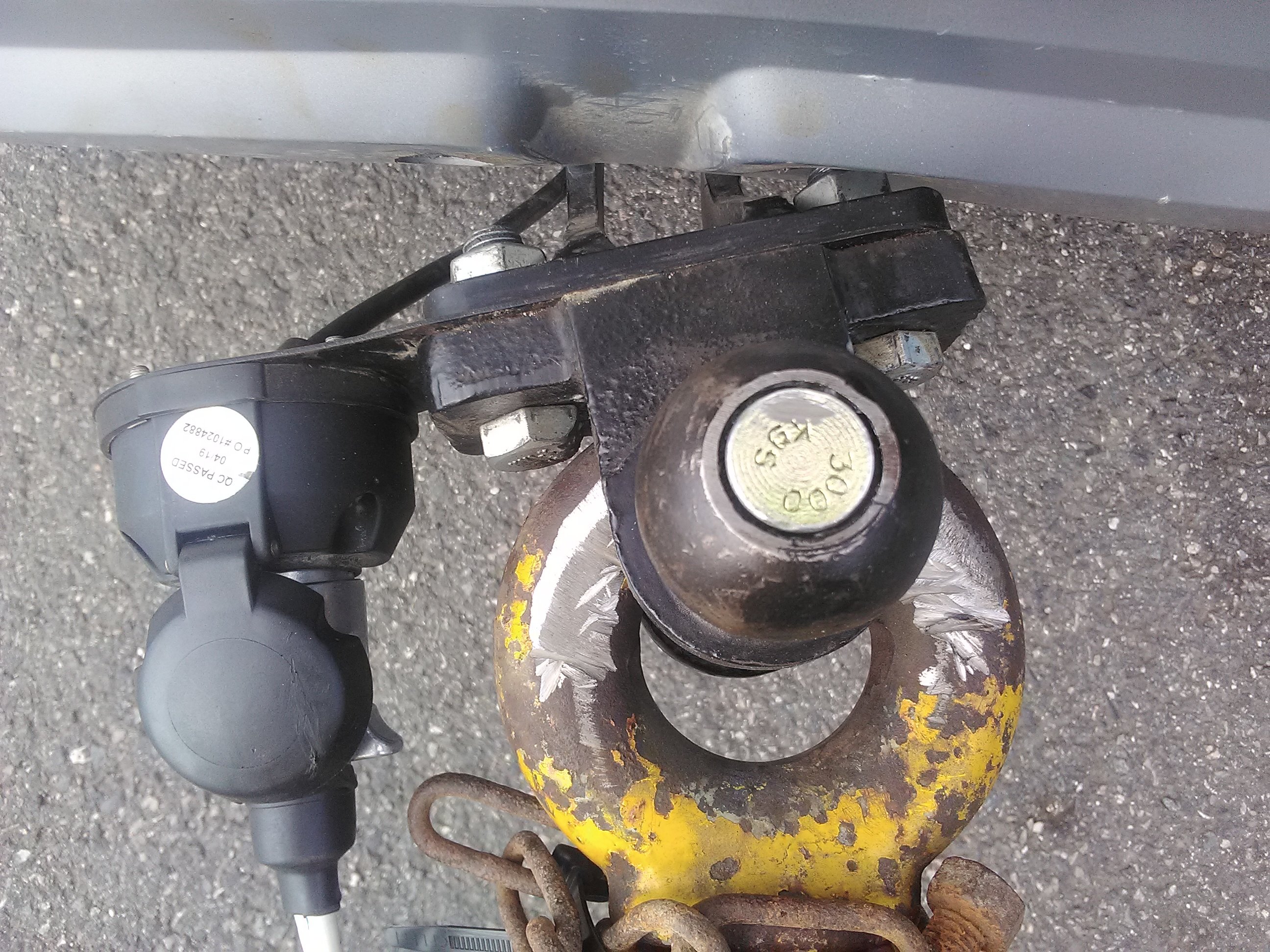

Then the side bolts may come loose and also on a flange fit like mine the bolts where the U shaped extension plates bolt to the centre of the bar, I usually end up having to weld the lot solid but I do push the limits a bit when towing as this photo of the recent disaster shows :sadsmile:
Edited by J.R.

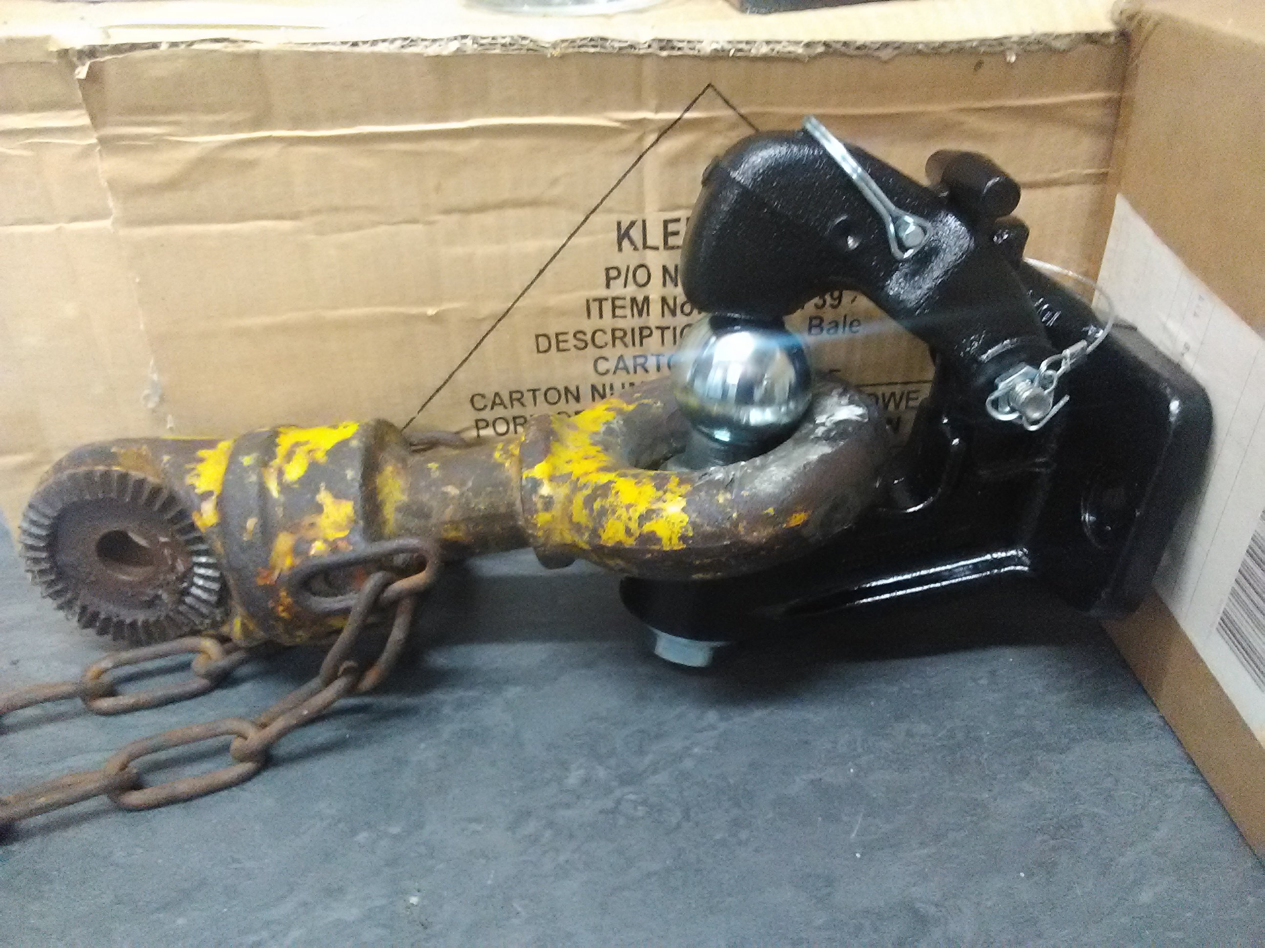

To explain I had travelled 100 miles to a Paris suburb to buy a 45 year old site trailer the same as one I already have, or so I thought, it had stood bogged down on a site since 2003 so I took along 3 good wheels & all the spares I could think of, what I didnt know was that the eye on the drawbar was a larger cross section than my existing one that tows fine with the coupling towball that you can see in the picture and it would no enter into the jaw far enough to get the pin in place.
To return with a proper NATO type jaw coupling would have meant an additional 300 miles and at least a weeks wait, the guy had a small angle grinder and one disc only so I set to work to the eye, the towbar bolts & even had to put a flat on the pin (its being scrapped anyway now I have the proper Nato jaw coupling), it was tight but it did follow the car when I did some lock to lock turns so I set off home. I hadn't however tried reversing :sadsmile:
Stopped at a Lidl for refreshments and tried to reverse and could see that it did not want to go so managed to do a U turn, I stopped just before the autoroute to tighten all the wheel nuts again, check the trailer board etc and saw the damage that I had caused, i took the photo then in case it was no longer attached when I got back :D
My hydraulic press for straightening the bracket is in the UK so I got it back pretty much straight by doing exactly the same thing but reversing in the other direction :thumbup:
I will in time weld some stiffeners between the two plates that buckled, I have to remove it anyway to weld up all the bolted joints that were shaken loose, the bolts that hold the extension plate to the crossbeam have almost as much clearance as the chassis rails and had already worked loose once.
This kiddy should do the business!
The shaft & eye are 40mm diameter forged steel yet according to the tare plate the gross weight of the loaded trailer is equal to the unladen weight of 499kg :D
