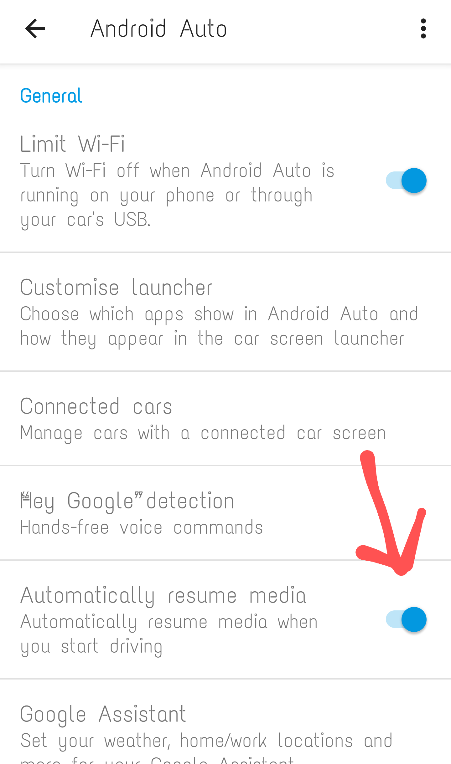

Out of curiosity autoplay music is using native android auto or something like tasker?
It's in the settings for Android Auto.
See image below.
Do it via ur phone.  U can't access the settings through the infotainment screen.
Mine will resume playback with Spotify.
1329439297_Screenshot_20200923-0831272.thumb.png.dd9d4a253a556215c2e016e5aa1e99ca.png
