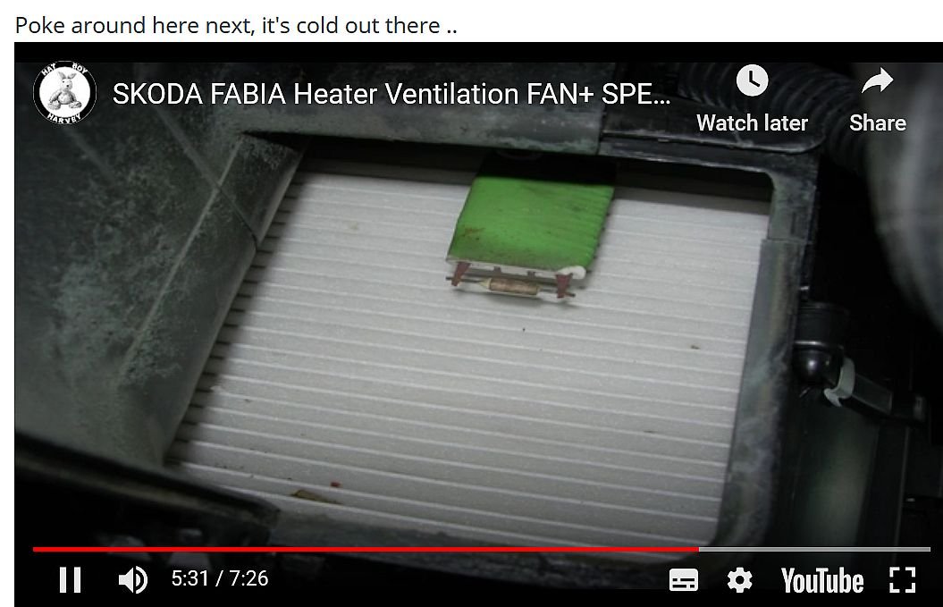

Poke around here next, it's cold out there ..
Quote
Noticed sensor NOT visible as shown ! But it is inserted from the top! I think it must be behind the filter (which is visible ). But I can't pull it out far enough to take it out ?
Should this filter be periodically replaced ?
