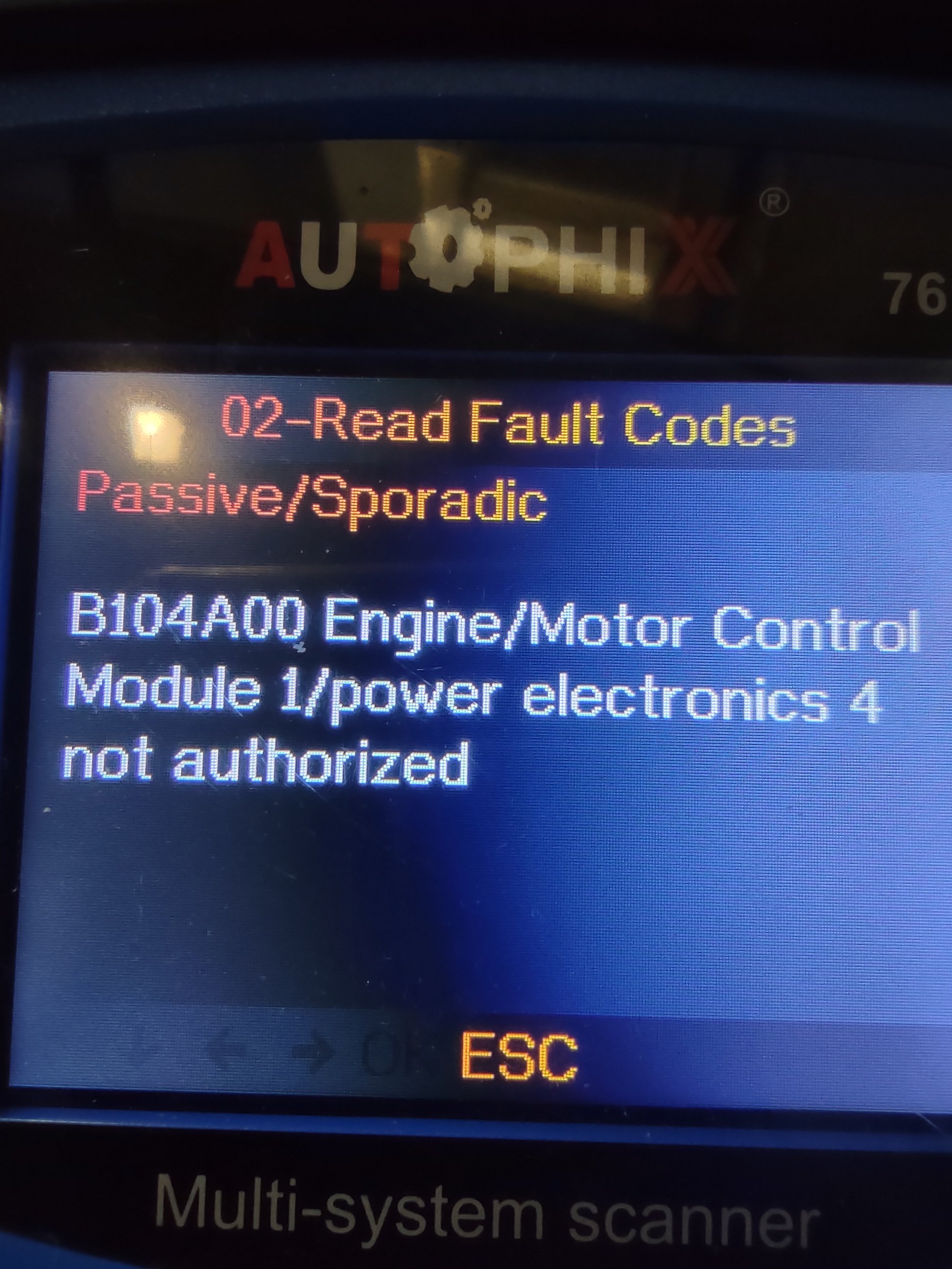

As to the car there don't appear to be any relevant codes showing up on my AutoPhix 7610 scanner which I updated at your suggestion first.
I did however, again try the fan on full blast and changed from External to Recycled air and there soes seem to be a bit more air coming through.
Does anyone know where I can find a definitive explanation of all the Skoda Kodiaq codes?
There are codes showing on the scan but none of them seems relevant - except possibly this one. (see photo). Anyone know what "not authorised" means?

Potentially all codes might be relevant and some or all can be unexpectedly related. Error codes can be from low state of battery charge (car, scanner), disconnection/change of battery, change of car part(s), 'coding' programming errors or incidents, computer brain-farts car or scanner programs, perhaps low battery in proximity remote(s) (never have a "spare" key have all keys used in some sort of alternate rotation use).
See my answer above and look up B104A00 on the web again bearing in mind my answer above.

I believe that fault code is usually associated with a key coding issue or immobilizer issue. I'd be tempted to clear it and see if it comes back.
That could be the case as my key battery went flat recently. I'll try clearing the code as you suggest as there is also a separate warning about that.
