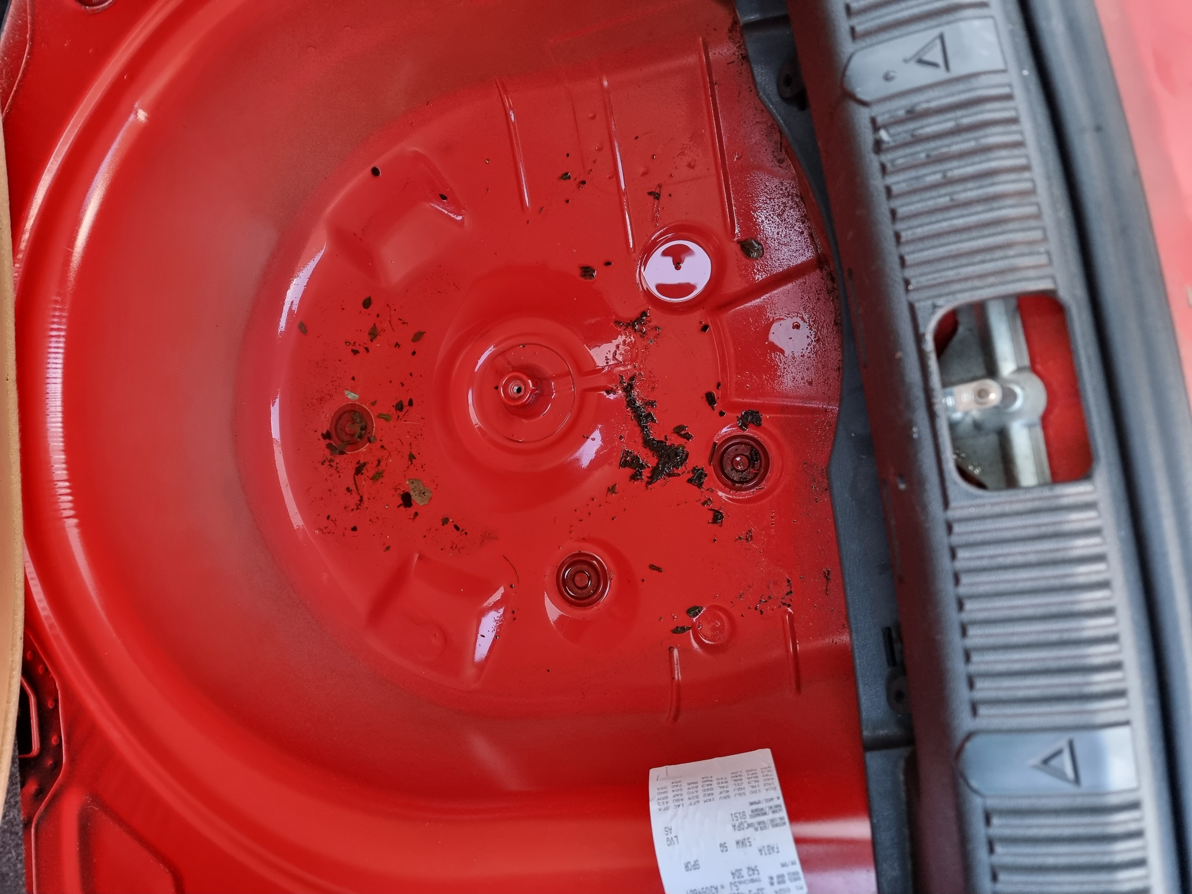

Check your spare tyre well, see that there is no water in there. Check the spares tyre pressure while at it, and that you can get the wheels / bolts off if you have a puncture.

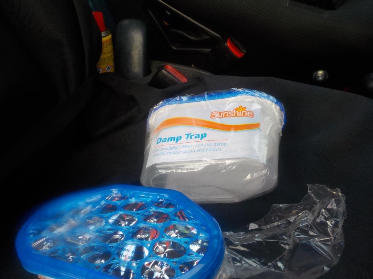

Maybe put a damp trap in the boot and in the car.
post-86161-0-82219400-1478954465.jpg.5e94362310d27e2e6f802ee21543284c.jpg.862aa2914147220385f1a8525223f55e.jpg

I found quite a pool of water in the spare wheel well of my Fabia. A judiciously drilled hole in one of the plugs solved that.

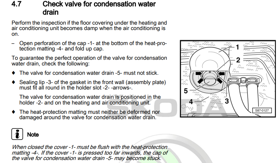

Engine bay side of firewall, hiding under the insulation, next to the heater matrix pipes.
Diagram shows  a LHD car, your drain will be on the other side of the pipes, I think. Look for a bump in the felt.

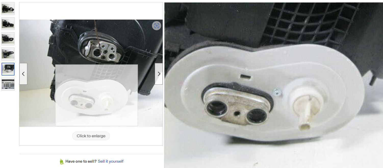

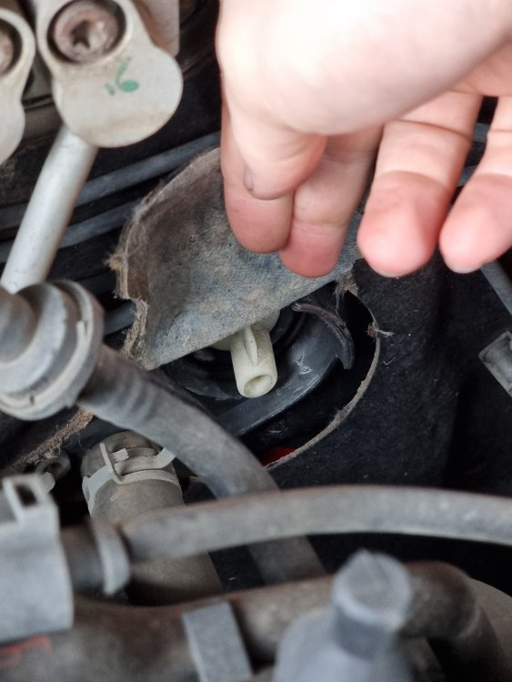

Just had a look at my condensate drain as I do think this is likely a problem as well. I never notice any water under the car in the summer and I do notice mist occasionally from vent.
My photo shows what I could see, is this the drain itself or is that somewhere else.
How would I know if it is blocked?
Yes that's the drain, more or less directly out of the bottom of the box the aircon evaporator lives in. Here's the view with whole thing out of car:
1236348349_Screenshot2024-01-2414_23_38.thumb.png.c097ed7c5be2c700ec6c14f6e5128212.png

In a bizarre turn of events it would seem that I may have located the source of the problem.
I was going to get my air compressor out the boot of the car today and noticed as Jocko previous mentiones it was sitting in a pool of water. Strange as previously it was bone dry...
