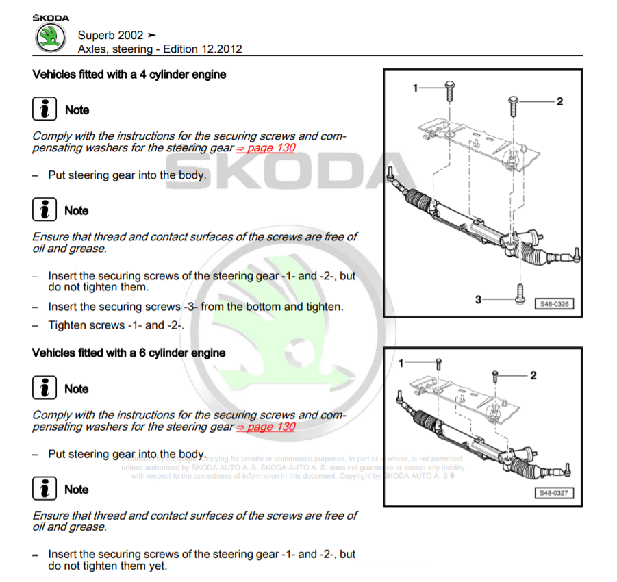

Steering rack bolts loose? There are a total of 3, Two visible from the top (one under the battery, need to remove) from memory they are 12 sided 10mm bolts (get the right socket and extensions to reach) and one from underneath.
Google loose steering rack bolts Passat B5.5 and you will get some hits.
Thanks for the reply, the steering wheel doesn't move past a quarter turn each way now - I'll have a look at above and do some googling tonight also at the Passat issues.
Thank you for sharing that!
One of the top bolts got a full turn on it, unfortunately the steering is still f**ked. Doesn't turn so trying to find a way of getting it to the garage.
Think the rack is gone.
