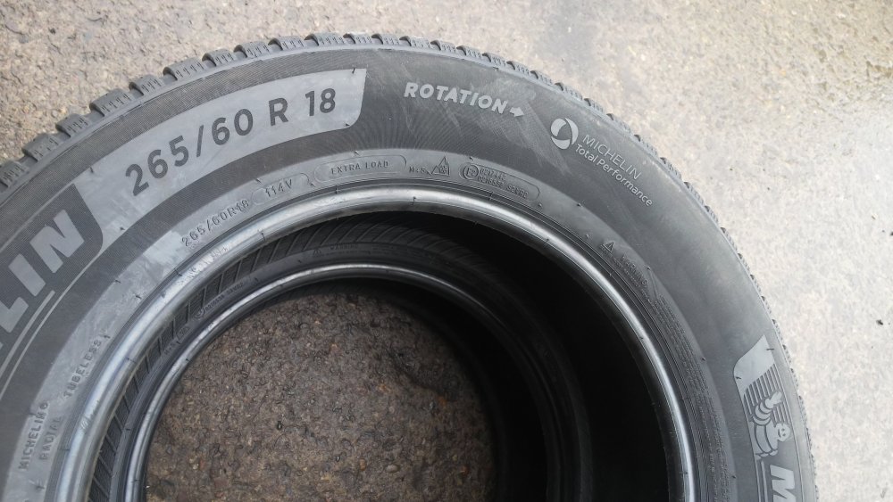

If your considering doing this think about ordering extra load tyres, usually labeled XL. They will have a higher load index number which means a reinforced sidewall. They will resist damage from potholes and reduce body roll a tad - but can actually be cheaper than the std load equivalent.
VRS_White-Hatc :  presumably though the reinforced sidewall  makes them a slightly harder ride then the std load ones ?
Exactly, and unless you plan on carrying huge loads in excess of designed capacity stick to standard load tyres. No point in changing to 16" to gain better ride then compromising it with stiff sidewalls!
Expatman: - precisely - that's why I queried the VRSWhite-Hatch.  Most of my load carrying will be just me ! with daughter + 2 kids very occasionally
A 95 compared to a 97 load rated tyre wont make much difference to the ride, but it might actually be cheaper. Higher sidewall tyres are generally a higher load rating than low profile anyway, as long as your tyres exceed the axle weight your vehicle can carry they will be legal and fine. I was just offering advice on something to consider when browsing tyre sites. Your tyre pressures will have far more effect on the ride than the load rating.
