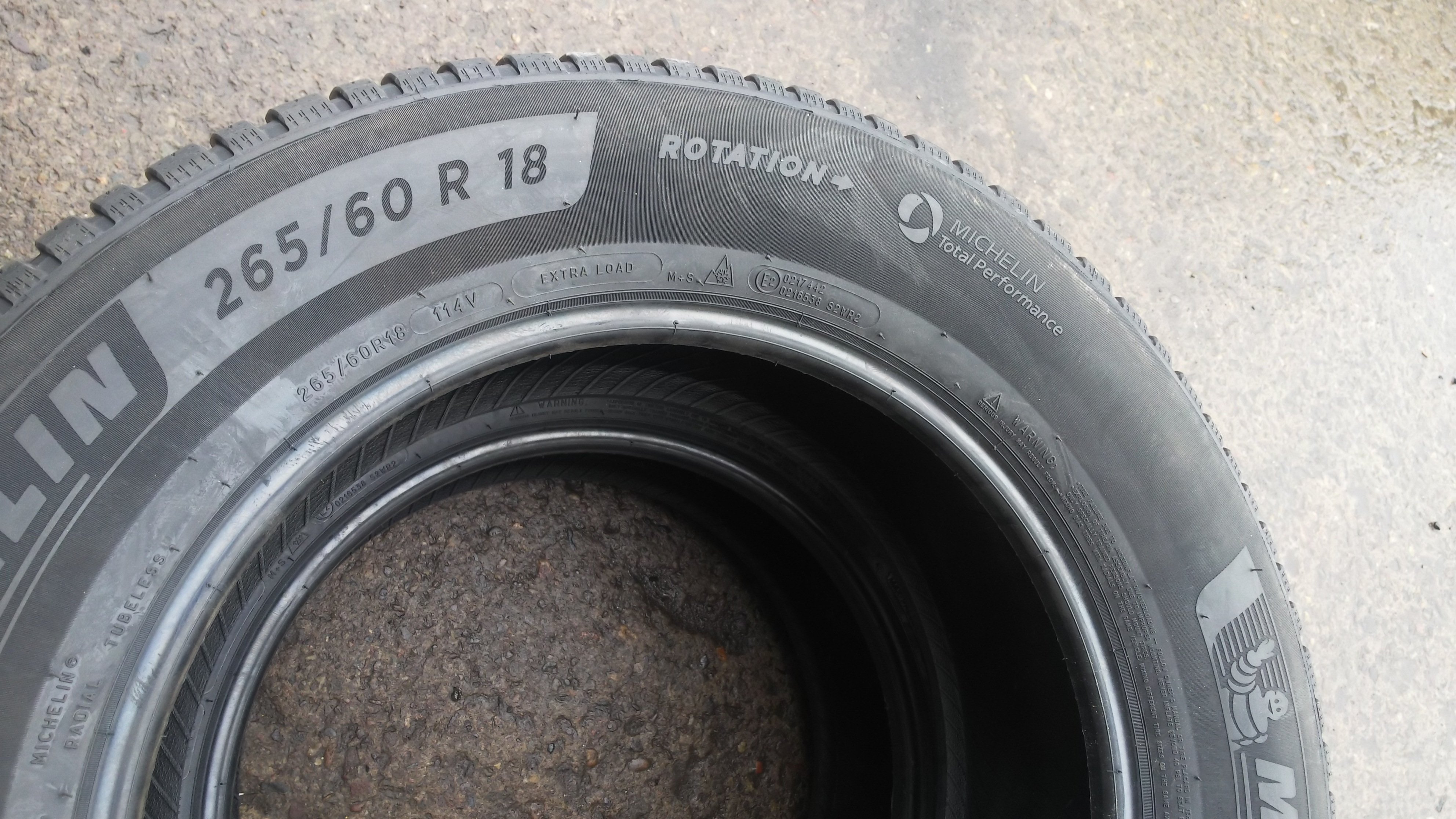

You keep going on about conditions. I can tell you having run many type of tyres that the Narrower is better like for cutting through snow and getting grip is not always the answer.
I have 265 wide CrossClimates on my Shogun rather than the standard 285's,  but on Snow the 265 is not superior to the 285's and 235's or 225's would not b better again in snow,
or on roads that have compressed snow on them.

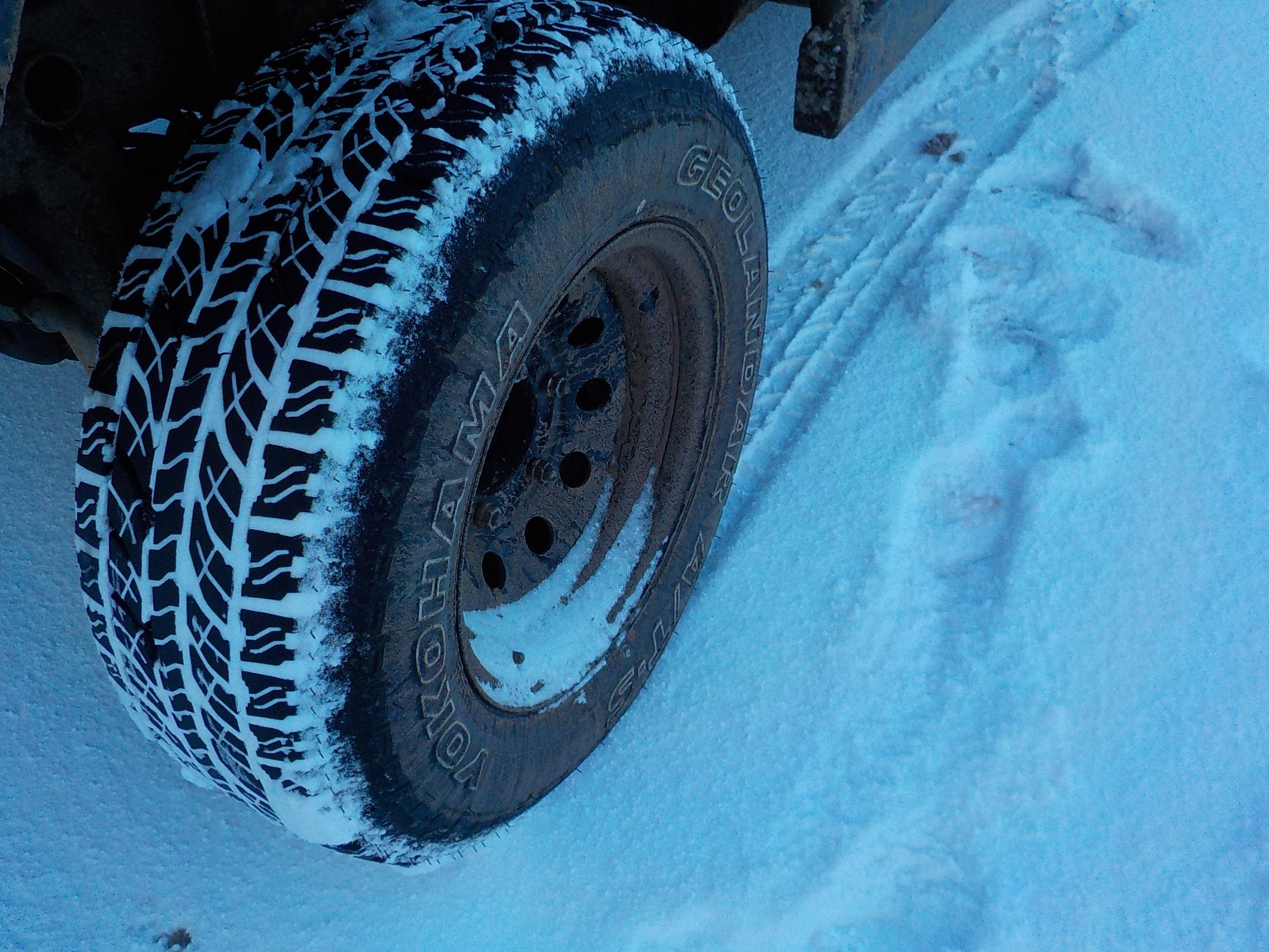

On Jimny's for over 15 winters instead of 205/70 R 15's i have used All Terrain, M+S or 3 peaks in a 225 or 235 on 15" or 16" rims.
Reason being they worked and worked well on snow & Mud and wet.
When someone in the  UK maybe doing a few hours driving or miles on slush and snow there will be black top again and no snow or slush.
Mixed conditions and mixed weather and temps are part of driving in the UK.
*When roads are covered in water then narrower might reduce the chance of aquaplaning, that is if not using good wet weather tyres.*
225 width tyres on something the weight of a TDI Yeti or even a TSI are not some crazy dangerous fashion that is bettered by going narrower.
Nobody is fitting 'narrower studded tyres'.
Bottom are 3 peak 235 15's on a Jimny.
Travels on snow well and better for grip than if there were 205's on.
1405516931_DSCN3645.JPG.ce5d86818560f2ec082d560037023b7f(2).JPG.dc4fc8a52fdb94ce45c913f6843ed4bf.jpeg
2053124383_DSCN3659.JPG.cd97dc6e8c02b8ba91706dd13bcb6e0d(1).JPG.2916558c8c8f7656f07895fdc4033bf3.jpeg
Both TDI's so heavier than a 1.2TSI's.
