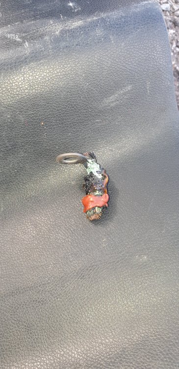

Thank you to all the people who have posted, I've finally got round to looking at the earth points today and found one very corroded contact and wire, looks like some water has got in at some point. Cut that out and replaced and everything is working well. I would say the rear wiper has more power now too.

That is not corrosion but a bad contact that has overheated and melted the insulation, someone has bodged the connector in the past as it should not have the wire cores sticking out under the ring part.
The solder is a giveaway that someone has messed with that previously :)
Glad you figured it though!
