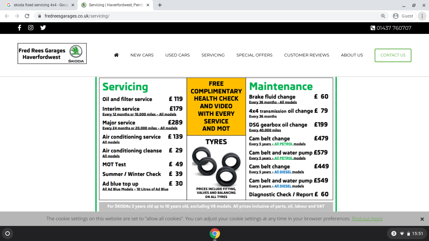

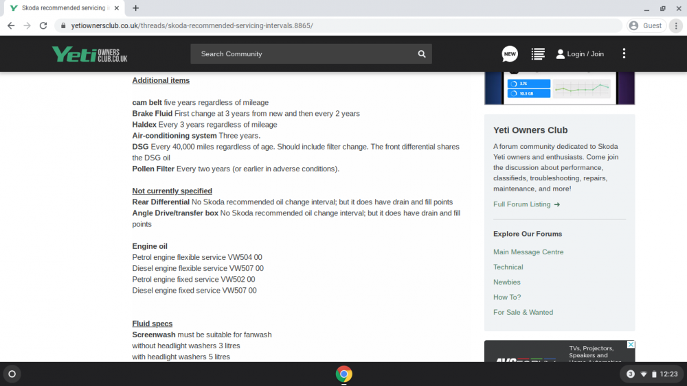

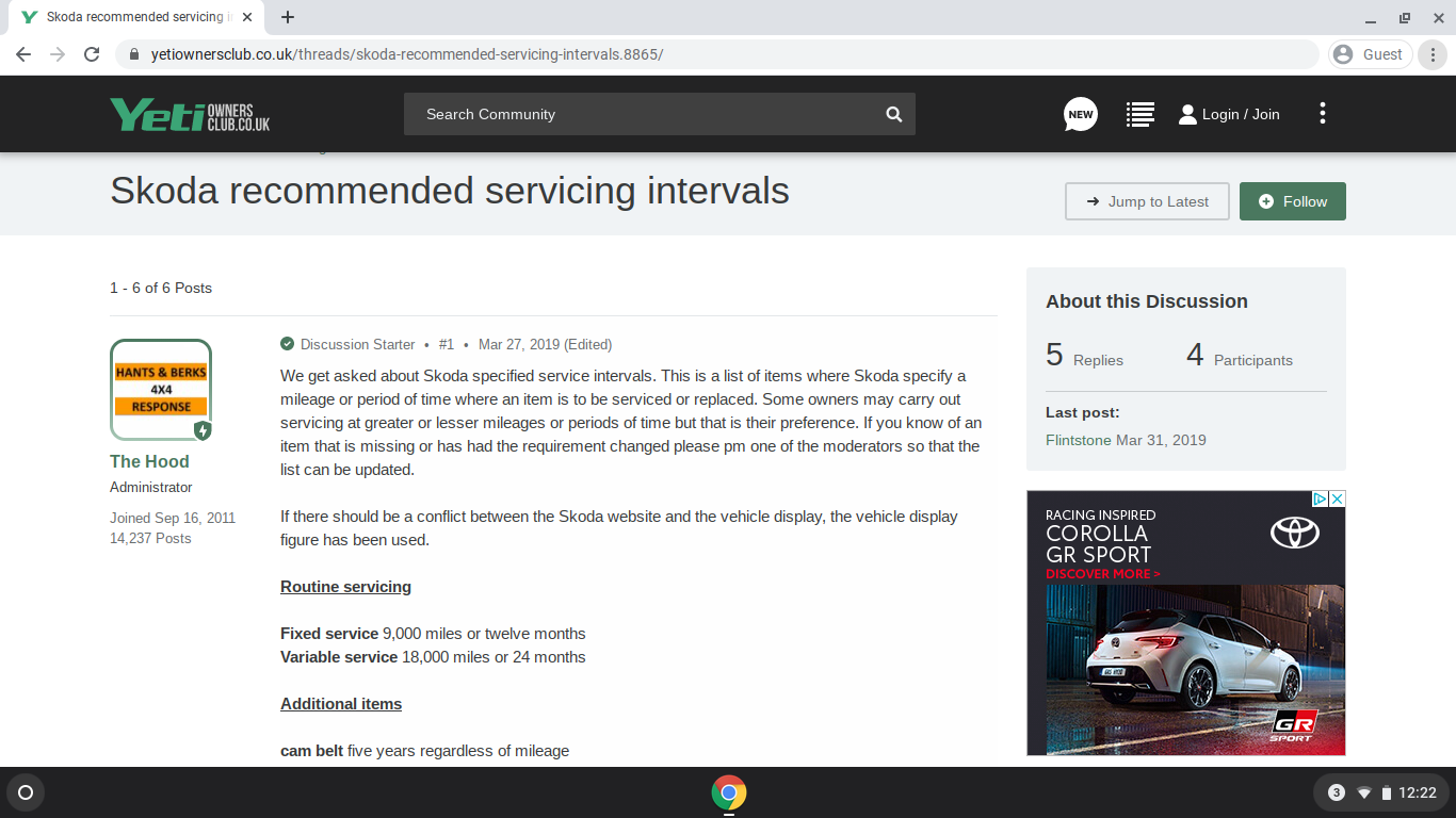

Fitting a new pump every 30K miles sounds like a nice little earner.

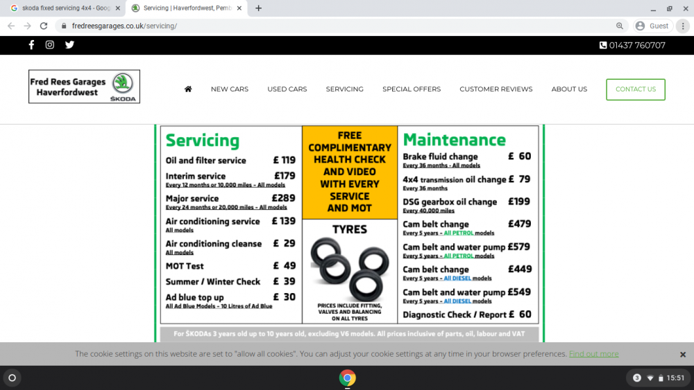

My dealer quoted 70 for oil change and 120 for oil change plus filter wash.  Car is 3 years old but only 23,000 miles
£69 was the price @ Participating Dealerships until the price went to £79 and some might well charge less.

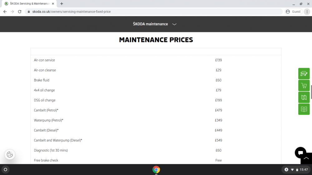

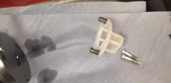

You can't replace the filter on later Yetis as it is part of the design, it does need opening and cleaning though.
I would ask for before and after photos to prove it has been done as easy not to bother, and just change oil..
You could replace it as it is just screwed on, but, normally, a clean will make it as new.  My garage videoed it after cleaning, but not before !!!!  Grrrr!

The filter is a plastic mesh on the fifth generation Haldex.  Volvo have a part number for it but it just needs to be 'washed' clean.
This is a still from the video the garage sent me.

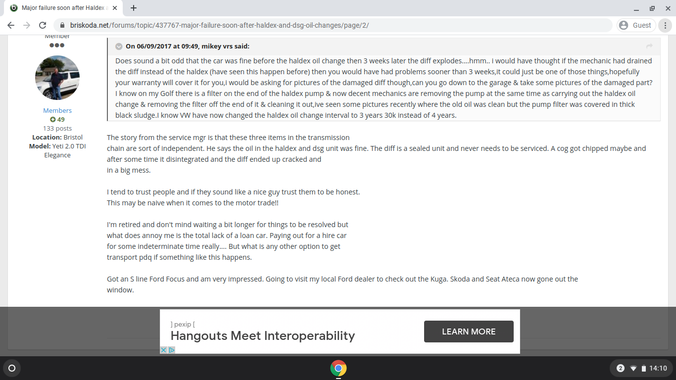

They drain the rear diff instead of the Haldex.
http://briskoda.net/forums/topic/437767-major-failure-soon-after-haldex-and-dsg-oil-changes
