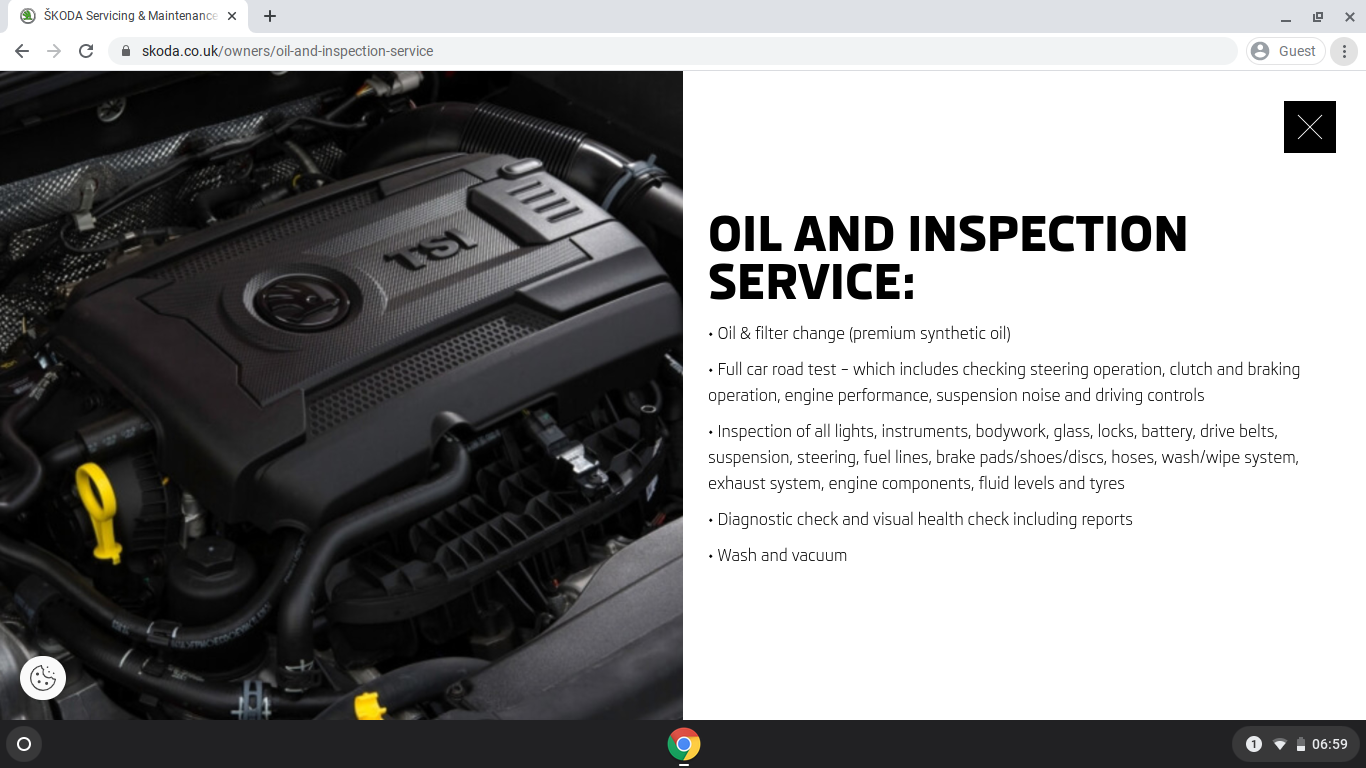

Main Dealer Servicing with Skoda advertises as 'Free Brake Checks',  and Major Services or the Extended Scope now has remove wheels and *check brakes.*
This is only a visual check, *Check brakes* means something different from Visually Inspect Brakes.*
but then since the car has been MOT'd as well there was the Brake Test carried out.
