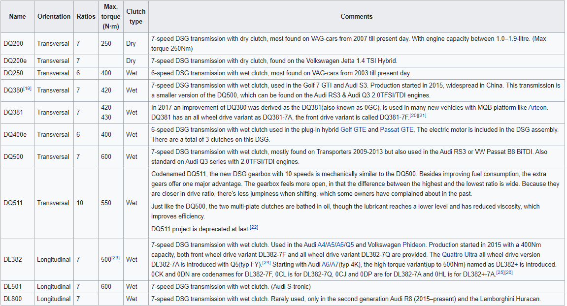

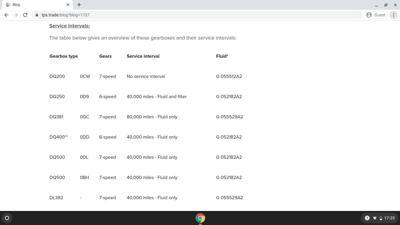

FWD 1.2 or 1.6TDI CR's  (under 150ps) will have a DQ200 7 speed DSG (Twin Dry Clutch) that does not have Service Schedules / Guidelines for Oil changes.  It has 2 oils, box and MCU.
The 6 speed Wet Clutch DSG's used in the AWD's or Yeti's over 110 ps in a Yeti ( 150ps)  (192ps) in other models, need Oil changes.
They have just the one oil.

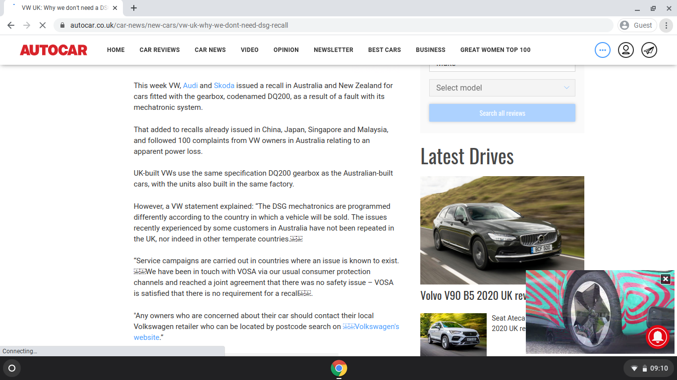

It was not a case of not lasting in hot climates as VW said, hence your UK car was part of Service Campaign '34F7',  it was the chance of Internal Corrosion.
After the change of Factory oil then a Sofrware update was needed and that was '34H5' started in 2027.
Since 2015 there have been Clutch Pack issues hence the TPI's.
Now with ones since the WLTP came in more TPI's and Software updates.
**VW Group were the ones that said "no Recall" was required in Europe / UK because of different climates / humidity etc.**
Then they had to start the Service Campaign and change the oil from 2014 in 2009-2012 DQ200s.
European weather can be just as in New Zealand and the vehicles and components and Software was just the same and cars built in Europe went to New Zealand, Australia etc.

By the time a Wet Clutch DSG car gets to over 120,000 miles there should be 3 oil changes done, so that is about £600 spent.
There might be 3 or 4 Haldex Oil changes carried out so £400 to add on for driving the vehicle that might be exactly what you need or want.
