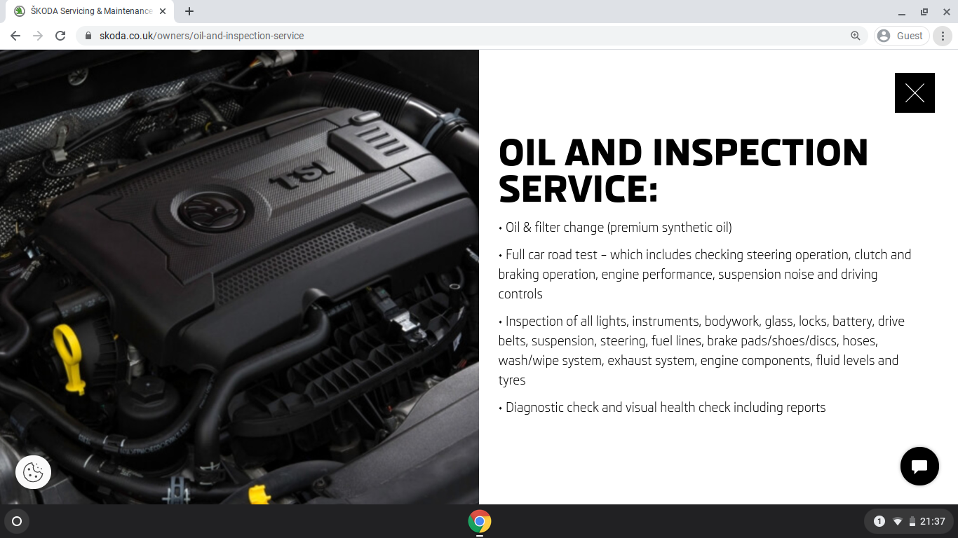

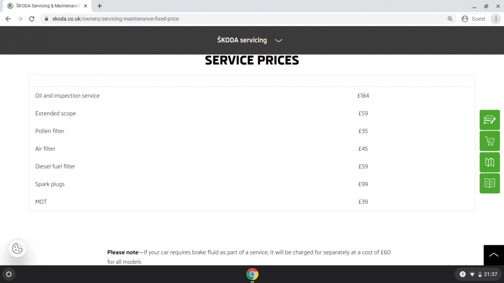

Overpriced by far too much.
First off there is no 'Oil change' required on a DQ200 DSG that a 1.4 TSI has.
*So no £199 DSG Oil change required.*
You could be on Variable Servicing so the Oil changes / Services would be each 2 years 18,000-20,000 miles or sooner, so not needed every 372 days / 9,400 miles.
Brake Fluid change is £60 at the time of a service.
First due now at 3 Years, so be sure they have it done before buying.
The next one is due in another 2 years if doing by the Manufacturers Recommendation / Guidelines.
