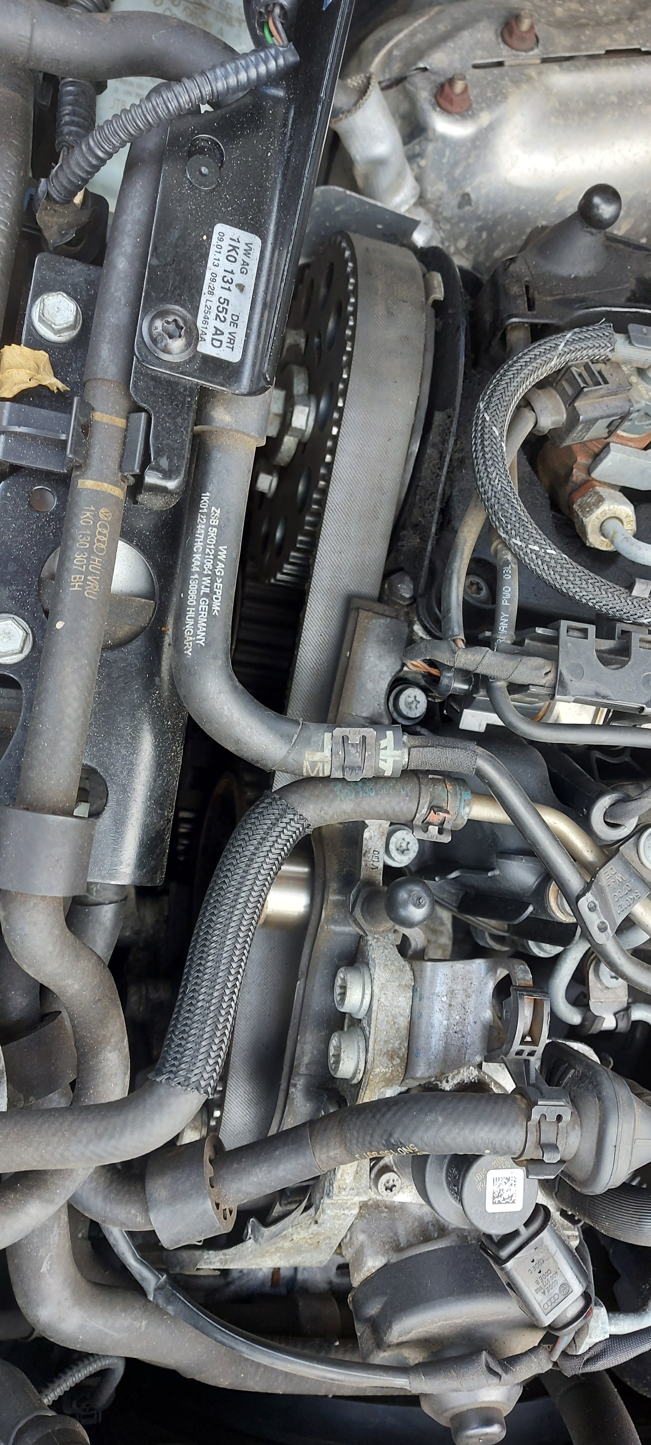

Today I took the cover off and the timing belt is there and tight. The engine starter turns but the pulleys on the timing belt don't.

Is the timing belt tight (I'm wondering if there is a tensioner that has failed)?

The only way the engine can turn but not the cam pulleys, is if the crank pulley is not turning with the crank. Unfortunately that would result in the pistons hitting the valves, so a major rebuild would be required.
Hope I am wrong.
How much slack is on the belt? If a tensioner had failed the belt would be easy to lift off from the pulleys.
