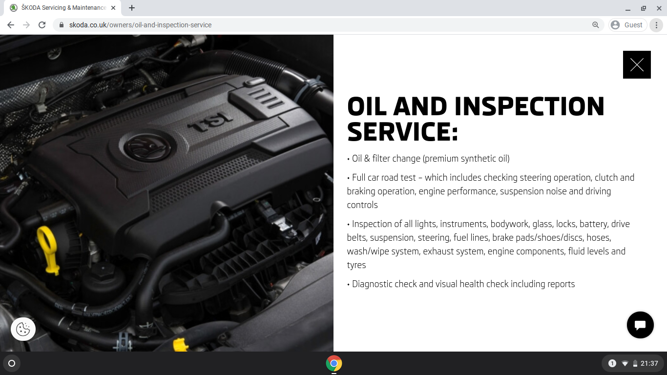

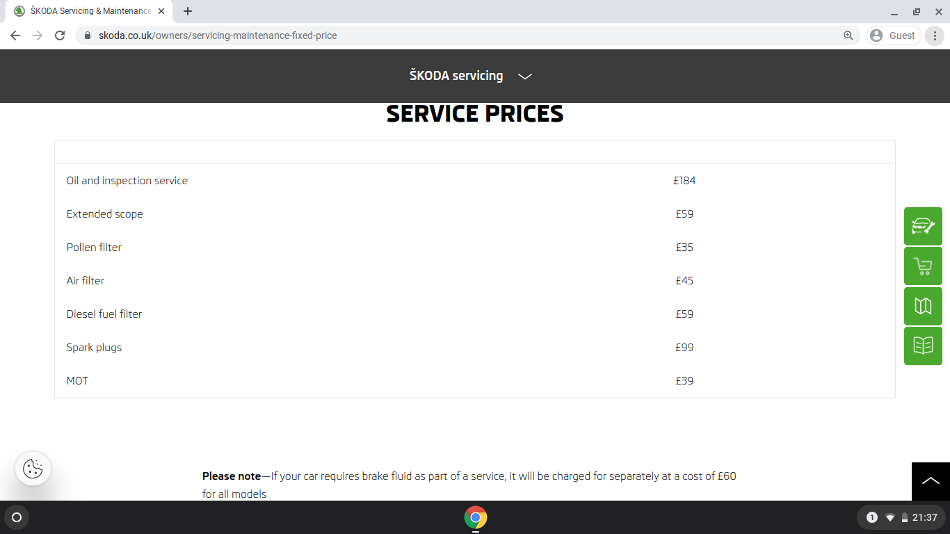

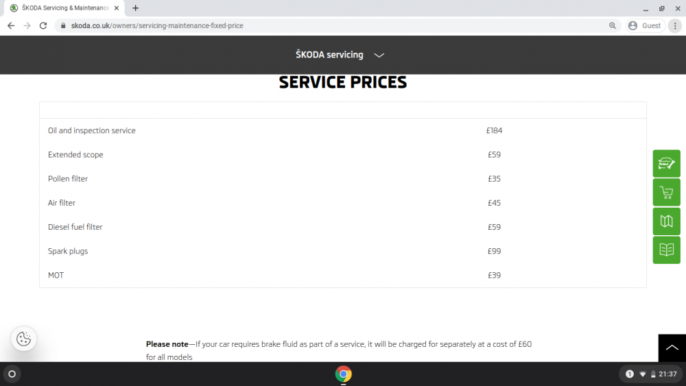

Do you mean on a Variable Service Regime, rather than Plan?
 A Plan is you having paid monthly or in advance to have services or part of the purchase of an Approved Used Skoda maybe..
Skoda UK dropped the Minor/ Interim and Major Service names.
Now they are Oil & Inspection Services, and Extended Scope Services each 3 years.
So get the servicing the car needs if the last 'Major Service' was @ 2 years, and was just Oil & Filter & a Pollen Filter.
If you just want an Oil & Filter change and a Pollen filter just get that.
But the Brake Fluid might not have been changed if no service last year.
It is first @ 3 years then each 2 years.
*Maybe get an Independent Specialist to Service the car, Service the Brakes etc, because Skoda Main Dealerships do very little actual Servicing.

OK thanks for the info. Still a little confused as I've spoken to them again and it was last serviced in 2018 so now requires oil, pollen and spark plugs but no mention of air con service. Maybe enquire with an independent specialist.

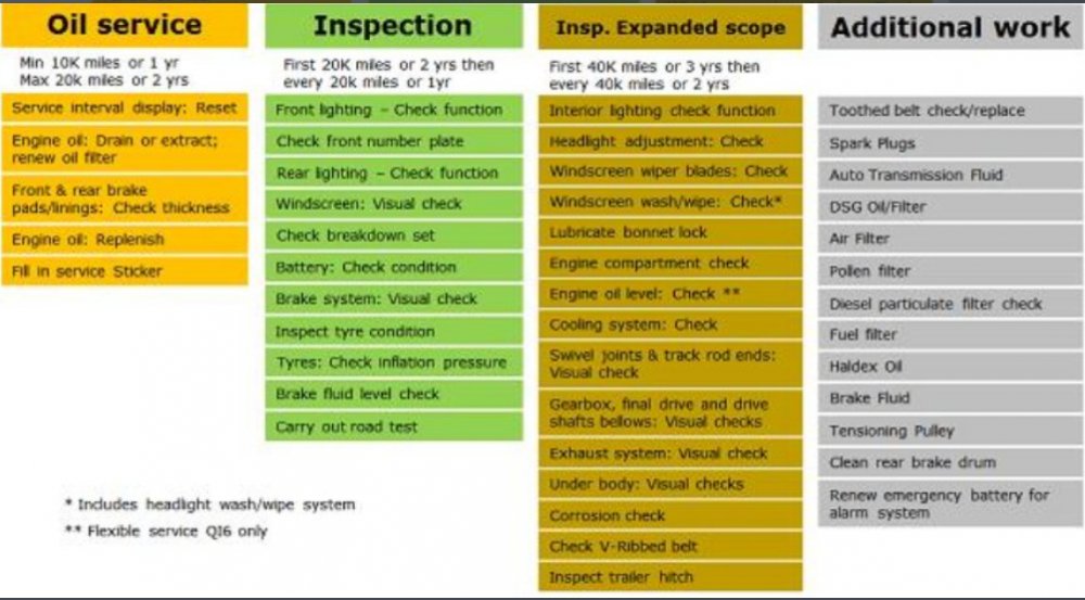

@Gav23
Really you need to ask the person you spoke to to get a Professional Technician to talk to them.
The Spark Plugs were at the 2nd Major Service which was 4 years / 40,000 miles, a d some Service Staff would say that was at 60,000 or 65,000 miles.
You paid the same for a 1st and 2nd Major service and might or might not get Plugs, Air or Fuel filters.
So now some at Skoda dealerships have the plugs at 60,000 miles in their Guidelines.
 As it is i would not pay them £99 to supply and fit them.
Nor £35 for a Pollen filter or £45 for an air filter.   Or their Oil Service & Inspection and extended scope prices.
Bottom, and Skoda are showing plugs at 4 years / 40,000 miles again.
Pollen Filter every 2 years, and they have put the Air Filter to 6 years / 60,000 miles.
I would be checking the Air Filter every year and replacing if needed, as they are a location location location thing on how dirty / clogged they can get,
or damp.

So.  You need an oil and oil filter change minimum.  If it is due the plugs (what is the age ?) £99 is not ridiculous.  The plugs part cost alone at a dealer part dep are £40 to  £50.
Same with brake fluid and extended scope checking. Yes, it will be cheaper if you can do it yourself but the prices don't look insane. I do brake fluid change but you have to jack the car up, buy a pressure filler or have an assistant, deal with stuck nipples etc. Dispose of brake fluid. It is not a 5 min job.
The Aircon service does look very eeeeexepensive. There are lots of places that can do a decent job of this, for a lot less money. I usually pay £30 to £40.
