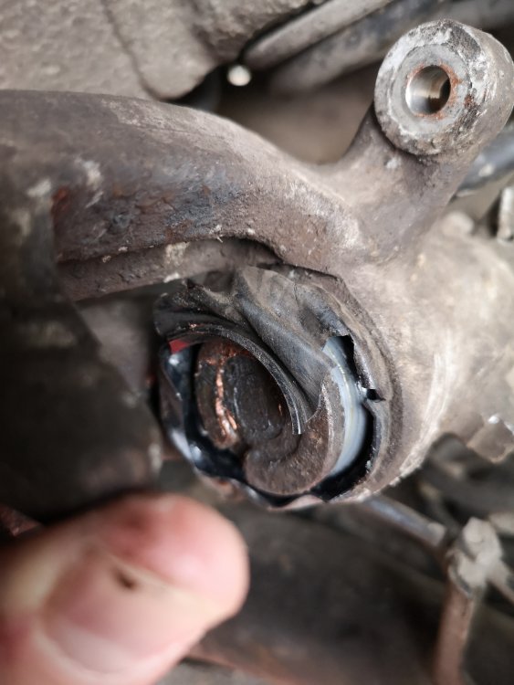

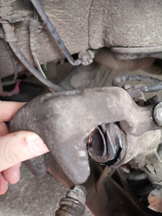

Rear caliper rubber seal.
Anyone know what to do about this.  Felt burning rubber smell while driving pull over saw smoke out og my wheel.  Dis entall everything and this is the cause.  Should i Just complete remove the rubber.  Or do i need a New caliper anytimr SOON?
Or any guide lines on how to fix this would be Nice :)
It will need to be replaced ASAP as it prevents water and other crap getting to the brake piston. Corrosion can cause the piston to stick on...... I've changed this seal on several front callipers, but one on the rear TBH, but guess it is a similar process, depending on the type of calliper is on your car. EG is it operated electronically or by cable.
its an 1.6 tdi dsg  whit manuel handbreak , do you maybe have a link or any sugestions on how to do this ?
my qustion is do i need to remove the whole rear caliper , to install a new seal ? = )
I don’t know of any guides that you can follow, but the calliper will need to be removed to replace the seal.
As it’s a manual handbrake, the piston will need to be wound right out and removed so the seal can be replaced, then wound back in. Again, this is an assumption as I’ve not done it on a rear calliper yet,  it do have two that I intend to strip and rebuild at some point (from a MK1 Octavia vRS)

Everyone is missing the elephant in the room, its not the ragged seal that is causing the brake to drag, the caliper piston is siezed with road dirt ingress and rust, the caliper must be stripped and refurbed.
Do not just fit a dust seal and hope for the best, you are risking not just yourself and any passengers but other road users, pedestrians etc. Imbalanced rear brakes will at best cause the vehicle to not brake in a straight line, at worse to lose control.

I eluded to a sticking piston in my first reply :)
Soo basicly i need to replace the whole caliper??
I would price up a seal kit and new piston vs a new calliper, assuming you have the tools to do the work yourself.... but potentially, yeah, calliper may need replacing
there i brought the tools il keep you guys update on the progress , i want for the rebuild the caliper option , never done it before so yea wish me luck =)
I was the same, hence why I rebuilt my front calliper rather than buying a new one. You'll need to check the condition of the piston and the hole it sits in for a buildup of rust. If there's too much in there you may have to buy a new calliper anyway. I hope you've caught it in time so all you have to do is give them a good clean with a wire wheel on a drill :thumbup:
