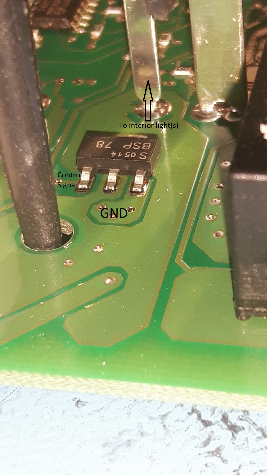

  • The interior light 'controlled ground' connection is done by this device, I've just seen: Datasheet here: http://www.farnell.com/datasheets/1651292.pdf   Can be just on/off in ter
Can be just on/off in terms of grounding the low side of the lights, and/or can do fancy stuff like fading out gradually.
hi.thanks.can you send picture from the whole unit?
This image is inverted compared to when it is mounted in the car. The red arrow is not relevant here.
Edited by Wino

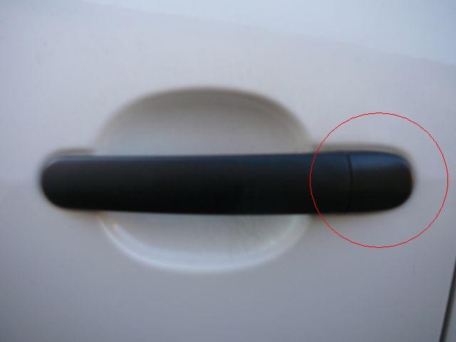

i have problem with my door clyinder too.it has broken inside,it just turns 360 degrees :(
as far as i checked it,its the newer version(2006 year car) so its the non rebuildable version.i have managed to drill the pins out,it has been disassebled but the broken part inside is different than the other version from the rebuild kits..
do you have any solution for this?
IF not,my other idea is to replace the cylinder to a blank plate like this on the picture since im using the remote to open it anyways
but in that case,what is the way to get in the car if the remote dies?
You can fit the blank instead of the door lock, but then you are royally fudged if the remote stops working.
