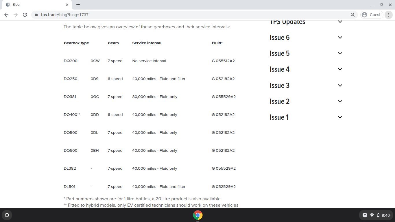

For those with a DQ381 note @ 80,000 miles and not the 40,000 the other are due to be serviced qt with the exclusion of DQ200's (7 speed twin dry clutch DSG's)
Our workshop schematic was showing the dq381 as a 40k interval same as the the dq250. For the sake of an oil change, I’ll not be going beyond 4yrs-40k with my own.
