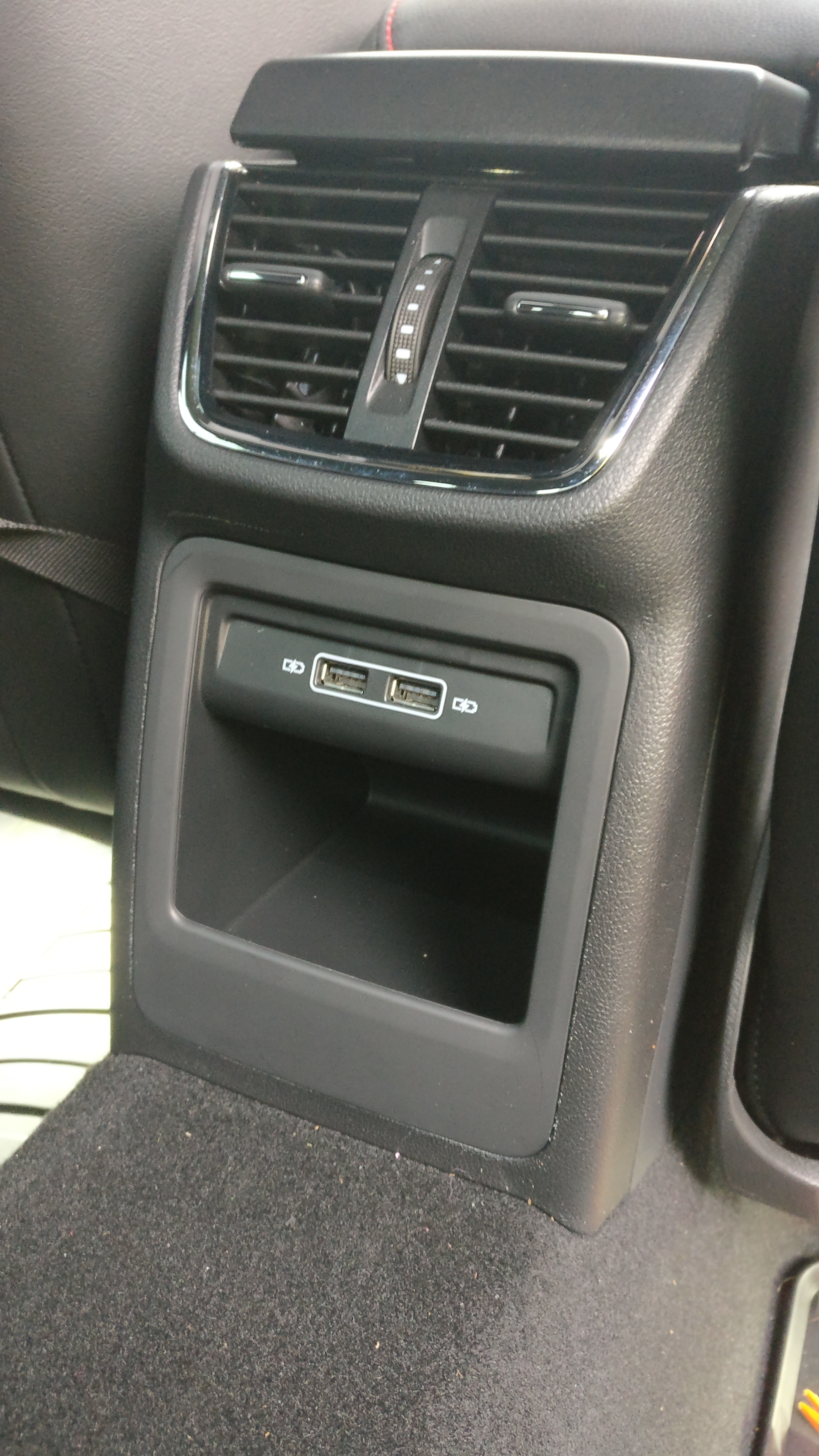

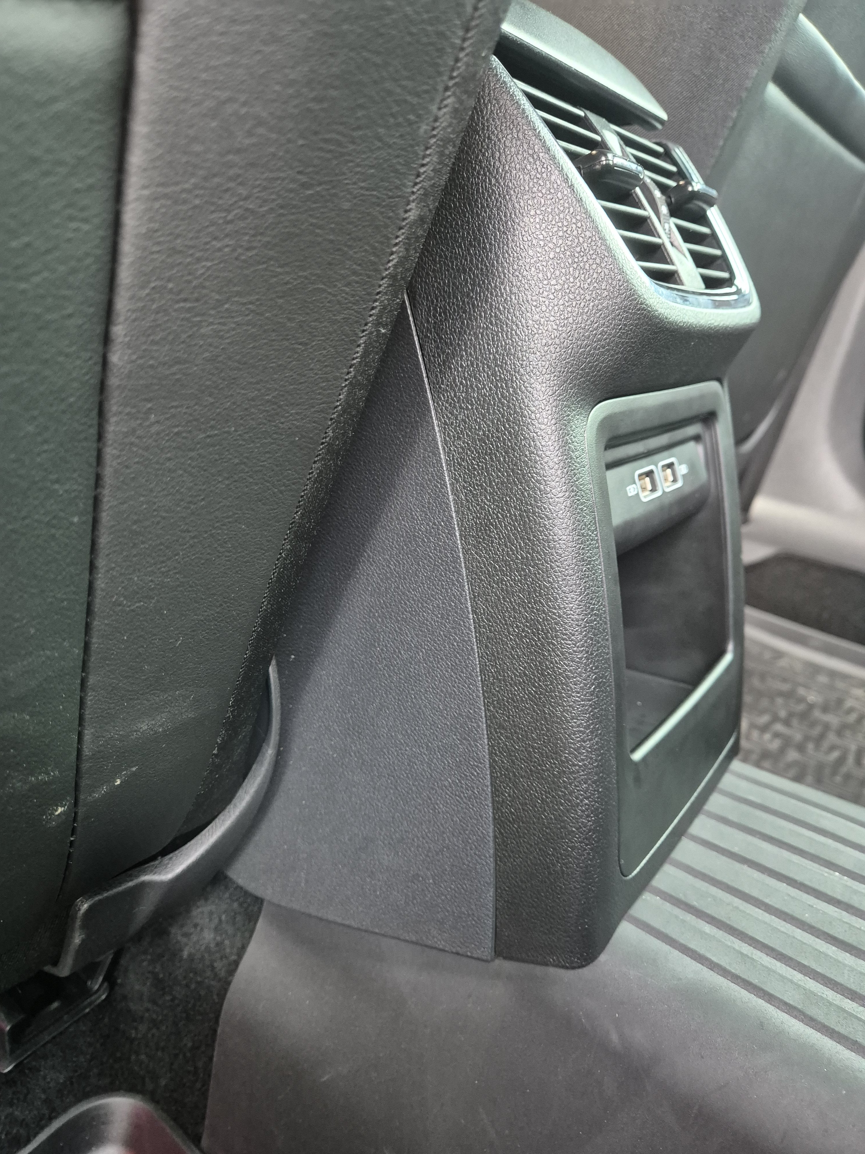

Just did this one myself. As above cigarette socket was a pain to remove.
Kit fits well, only two observations, the biggest is the difference in colour, it bugs me like mad.
Kit is black and car is a dark greyish colour.
Other than that the bottom two torx screws have to be left off as the insert is so well secured can't get it out to fit them. It's still held well though as top ones go in fine and clips in also.20240413_100832.thumb.jpg.7b8257c3ea500fcbbf46aa53d03282bc.jpg
