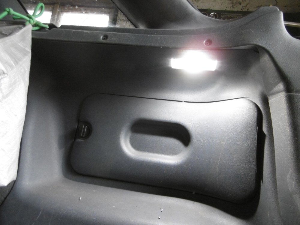

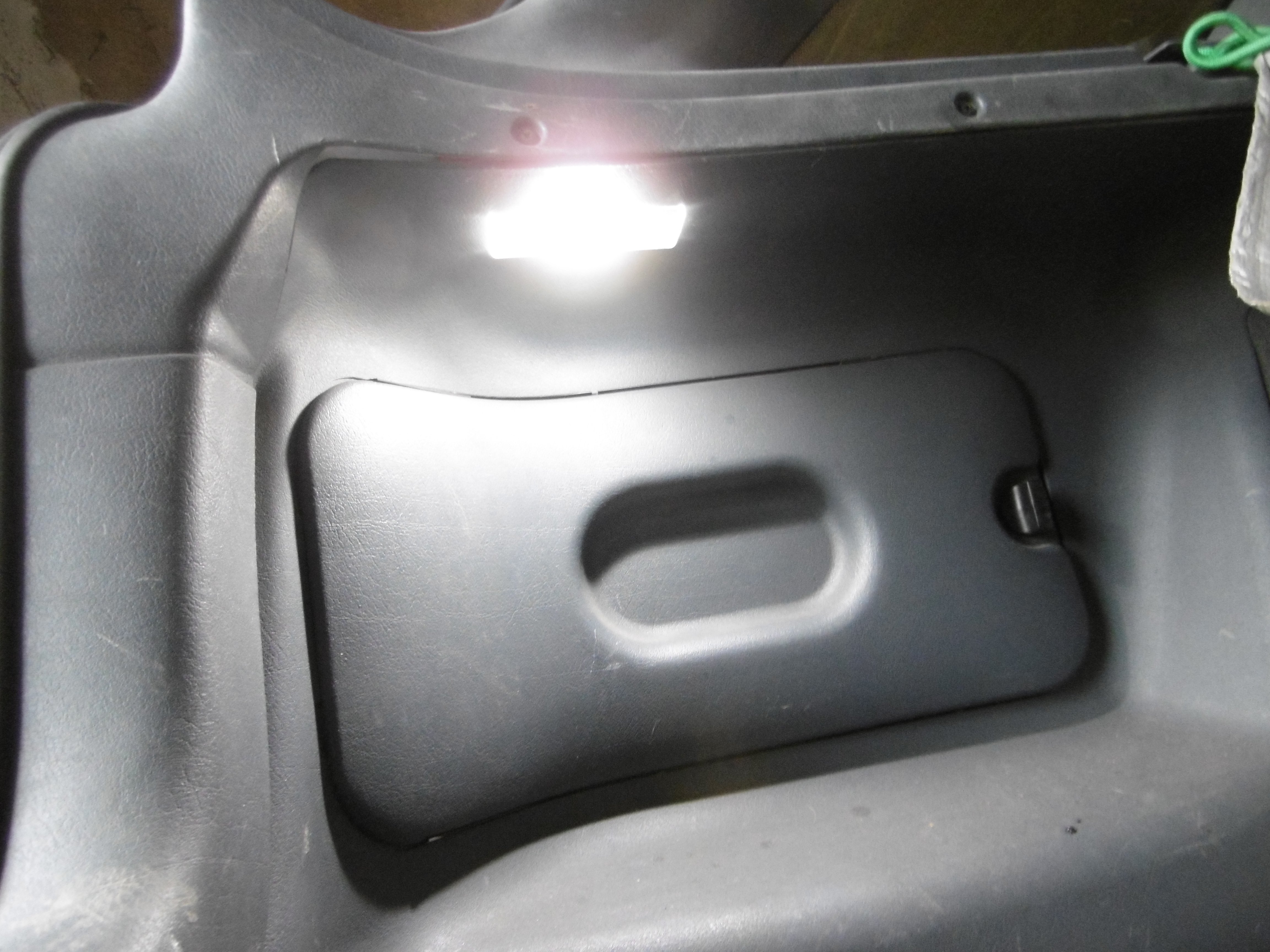

Installed that lamp, mirroring the original one on the left side. Just had to make a more-or-less correct size cutout in the plastic, popped in the lamp i got from the local ebay, installed the two LED fastoons, and voila, I have a lot more light to see in the boot during the long dark winter months on the countryside. (closest streetlamp is 200m away,  so it get's properly pitch black in the carport)
ran a cable from the original lamp to the new one right next to the original wire loom under the boot doorstep, so all looks decently original.

Your Boot light is awesome and looks ''factory'', may years back when i installed mine i din't had that idea and now i regret it a llitle bit.
