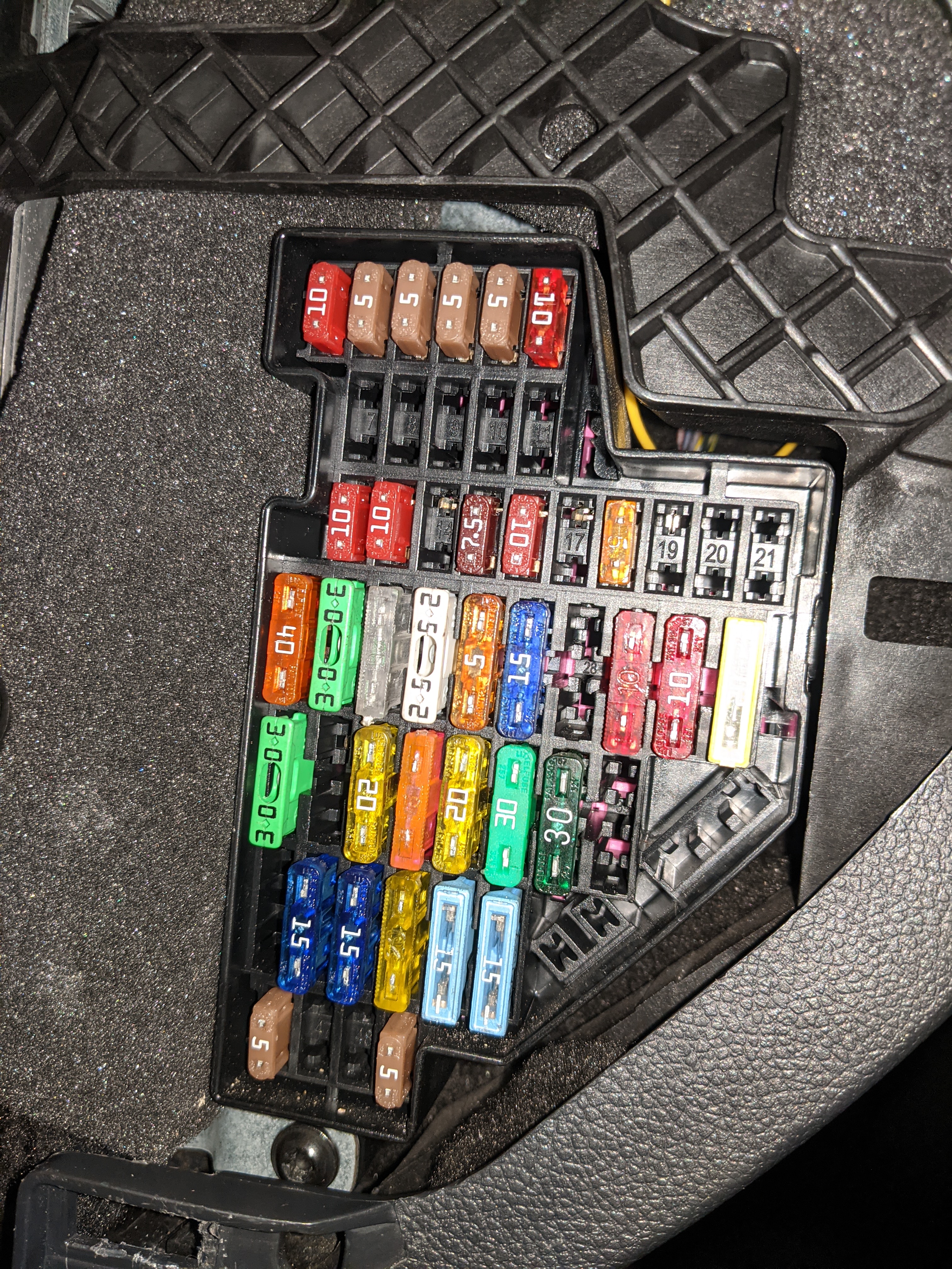

A quick visit to the fusebox reveals I have no spare unused slots. I took a multimeter to test all empty slots and they're all dead... what to do?

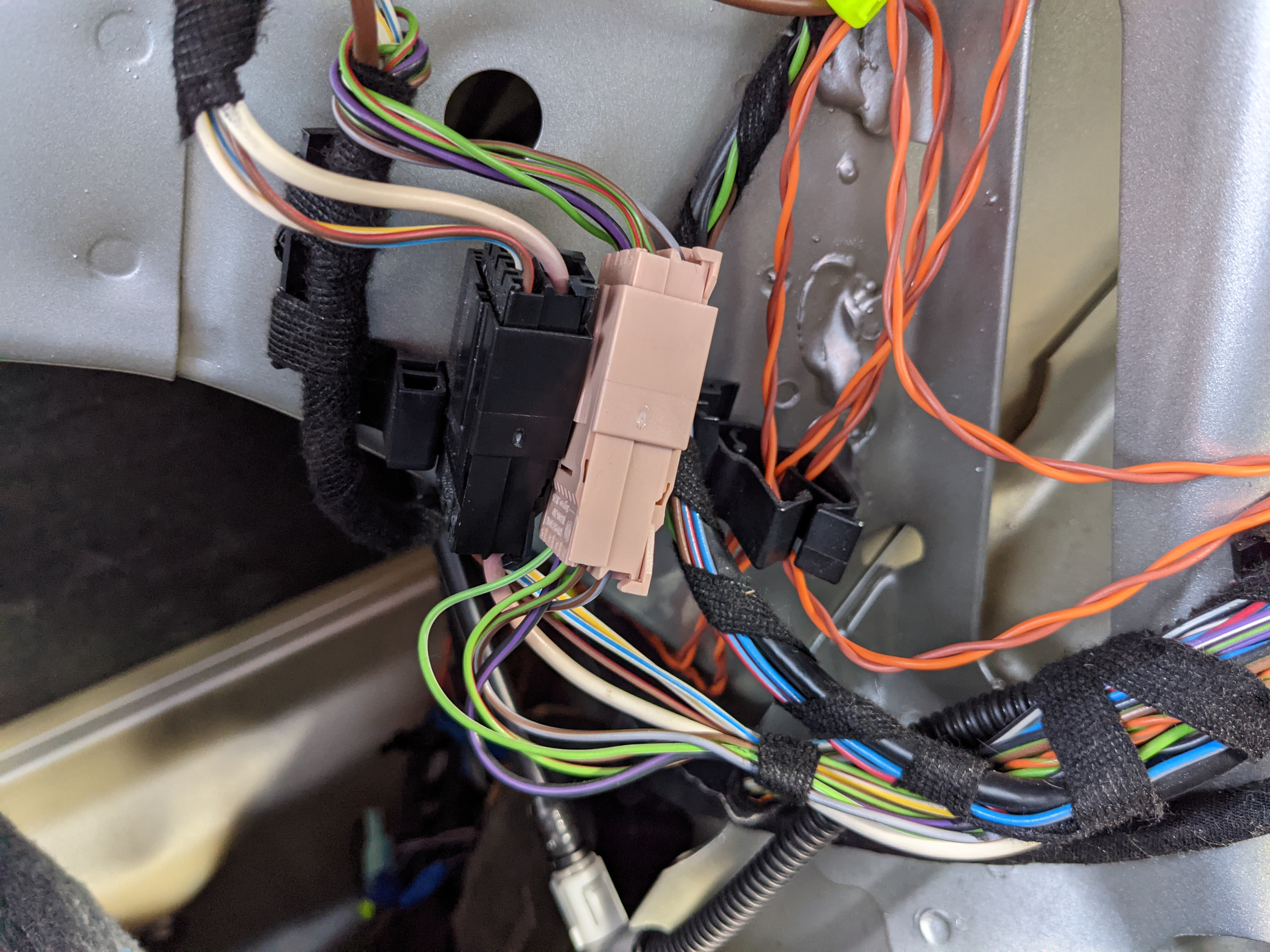

I managed to tap into the 12V feed for the rear wiper. You can find that in the beige connector just above the left wheel arch. It's the purple/black wire. For convenience, the connector can be removed from the bracket by pulling it upwards.

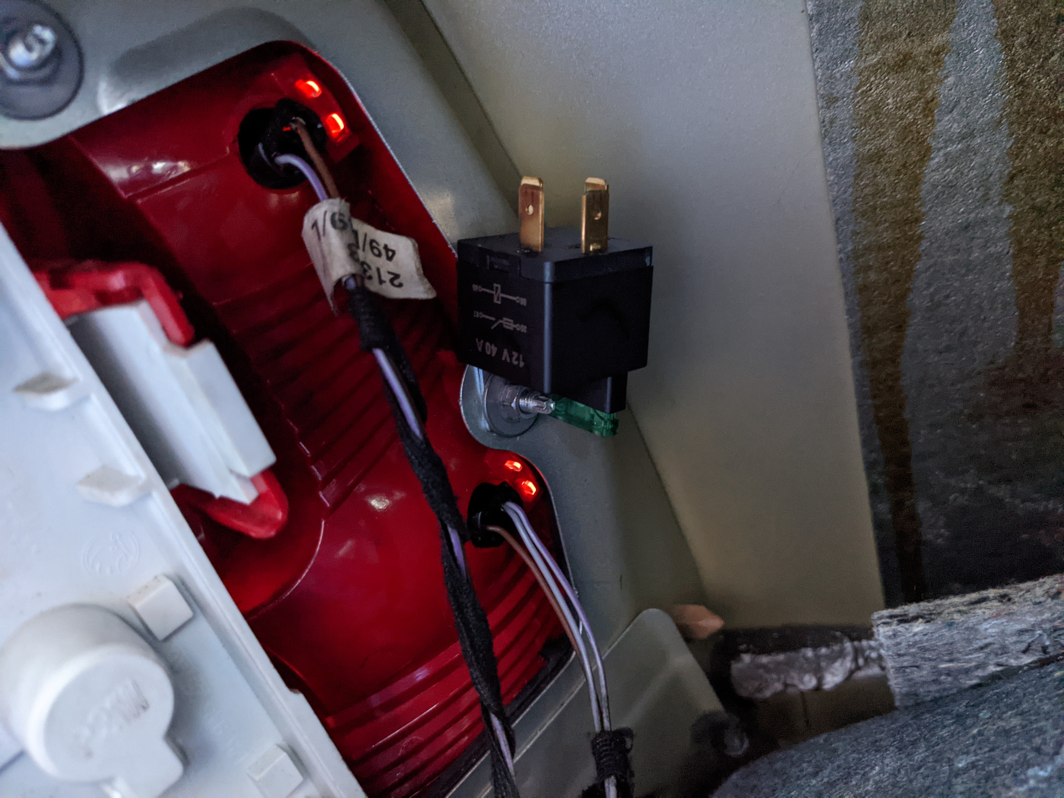

Then, for the relay - I managed used its built-in bracket to screw it on one of the taillight unit bolts like in the picture below - nice and snug :)
Overall I think this location for the relay is much better than inside the boot lid because it can be easily serviced (should you ever need to). It's much harder to remove the inner boot lid plastic cover and fit it back in without replacing some metal clips.

Hi. Could you please explain
a. How you managed to feed the power cable from the camera to the rear wiper 12v feed above the left rear wheel arch. I have tried with no success to feed it down the d pillar with a small poly rod after getting it through the conduit from the tailgate.
b. How you gained access to the area above the left rear wheel arch. How much trim needed to be removed and how did it come off?

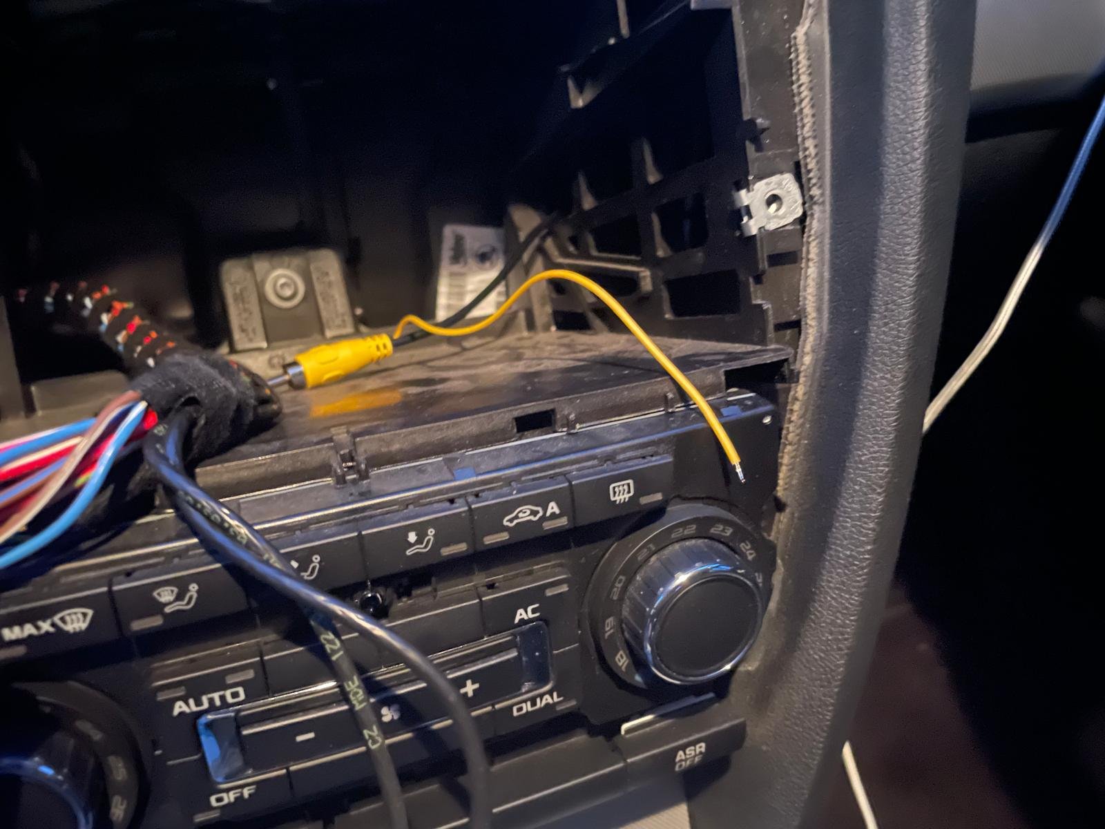

2009 Octavia with rcd unit my head unit supports r cam and I have wired it in the back with power from reverse light and ground but I don't know what to do with this cable coming off rca input do i put this into a fuse or tap into one of the cables next to it? Thanks
Edited by Abzman
Normal you Take KL30&KL31 and Yellow RCA is the Reverse light
sorry what is kl30? is it possible for you to provide a picture please?
