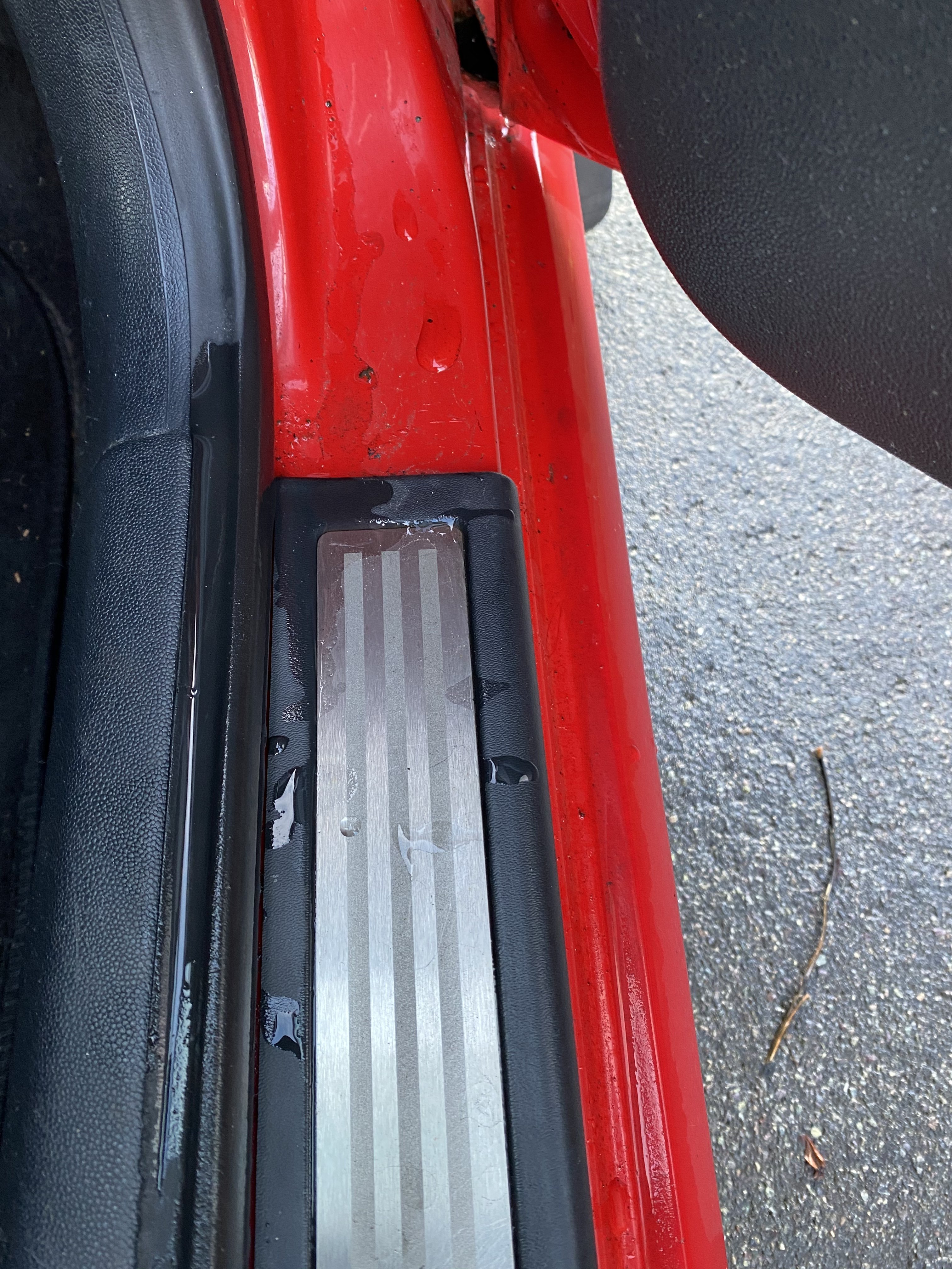

There is slight water on the sill of the driver door (pictured below) and a bit of water on the inside of the rubber strip which maybe the issue? However I had this last winter with no condensation/mould issues as doesn’t seem to drip over in to the actual car. Does anyone have any other ideas on what this could be or could this be from not driving it properly for 2 months?

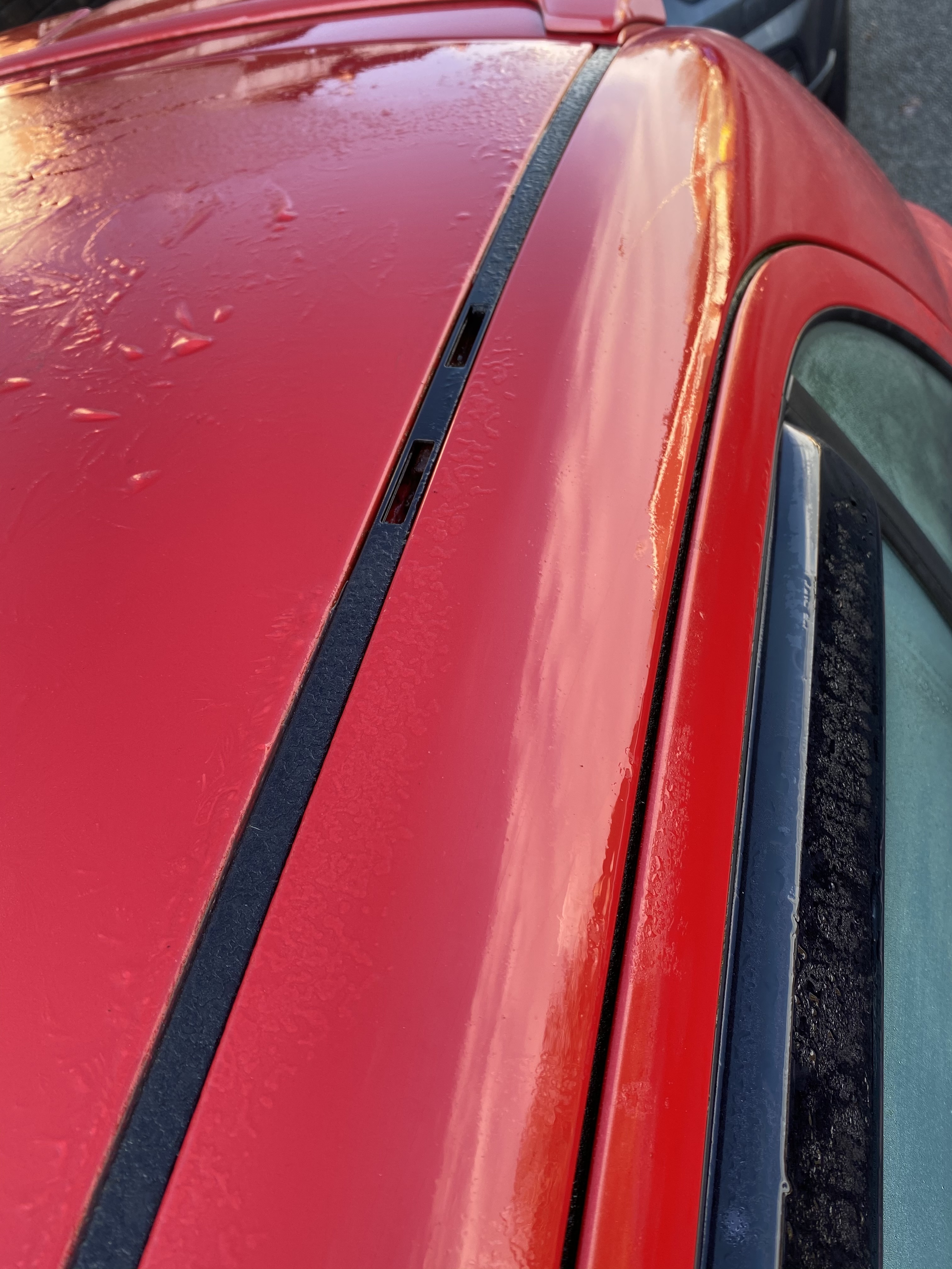

I noticed on the two strips on the external roof there are gaps where it looks like a roof rack once was. Should there be some caps on this or are all Fabias like this? (Pictures below). I thought maybe this was leaking through here and down the pillar where the front seat belts are situated.

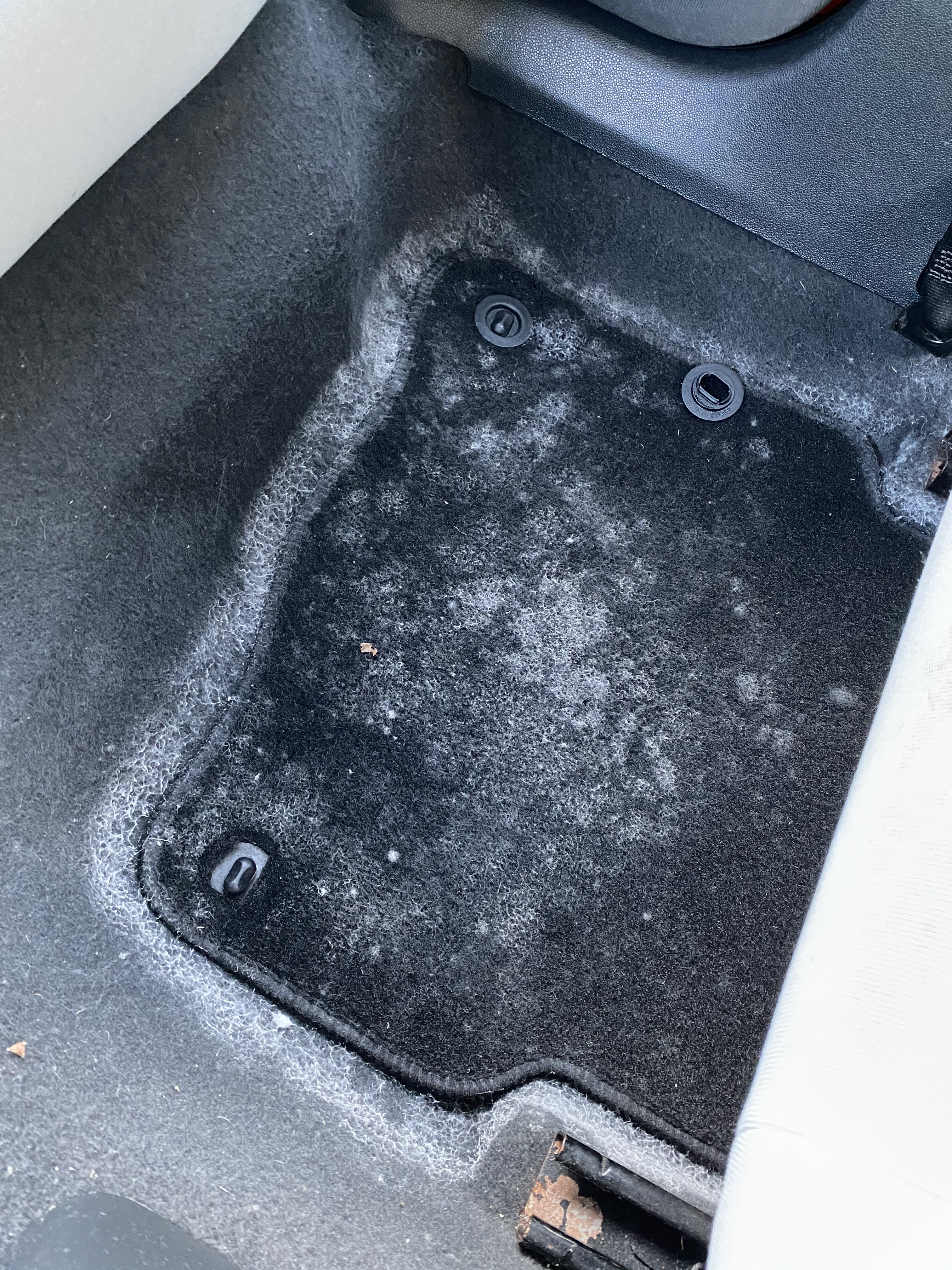

Also this is the rear passenger footwell  😳😳😳
Water sitting on the seals at the bottom of the door is a sign that the metal internal door cards need sealing, possibly once more if not done properly last time. It would be worth getting the interior decorative door cards off for a poke around at the bottom of the door card seal. on my car, the rear door seals had gone mushy and were soaking. My car has the annoying rivets holding the metal door cards to the door frames so I could not get them off, however 15 mins of poking around pulled out the mushy seal. I let it dry out then resealed with a product from Screwfix called the Dogs Bo*****s. It is quite expensive but is sealed it perfectly and so no more standing water on the rear seals which then overflow onto the carpets. I have noticed that if I park the car at an angle leaning over slightly, I get water sitting on the front door seal of the higher side, so in due course, I will tackle the front doors. My son uses a moisture absorption product as shown below. I am going to get one as well to prevent our TT misting up in the winter. It will hold 800ml of water before needing to be dried out and then reused.
Careful using a mould killer with bleach in as it may discolour the carpets etc. Those roof slots probably just had clip on covers and so would not be watertight. I may be wrong but I would not think water is getting in here. My car is an estate with roof rails so nothing to compare. Normally these plastic strips just cover up the channel where the side of the car is welded to the roof.

The cover caps for the roof trim are part number 6Y6 853 140 D (hatchback). However, it can't leak into the car through there.

Does this mould look too excessive for just being ‘stood still’ for 2 months? I have googled mould from car stood up and there did seem a few results of bad mould but think that’s very positive thinking!
Yeah, it's very wet in there.

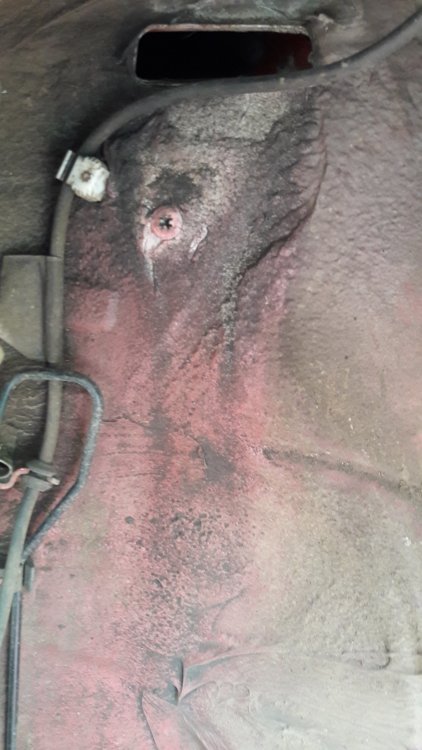

It's worth checking if the bulkhead drains are blocked as it's quite a common thing. If you remove the front plastic arch liners you can access the drain holes under the wheel arch.....
Weirdly, when my fabia was sat outside for a year, the seats,belts,headliner and steering wheel were coated in mould but the carpet atleast looked to be bone dry. My car leaks from everywhere though even on the top part of the windshield. You may want to take the interior apart to fully get rid of the mould. It'll soak into the padding under the carpet and will lie in the ducts of the climate control system. On the other pic, there should be a drain on the bottom of the door, most likely just draining onto the sill from there. Car plan upholstery shampoo and Car plan Powerful odour eliminator are both decent products for the price and I've used them with good success, you can get them in Asda for cheap.
Is that part number correct TMB as im after a set of these as someone nicked mine lol but its not finding that part number.
Ahhhh cheers mate thats great to know i can get these thanks 👍
Hi, I know TMB has given you info on the roof rack trim caps but I carefully removed the whole roof trims from a scrap car as it had the four bungs in good condition, two on my Fabia are pushed in and bust.
The trim was quite a tight fit as you would expect, held on by rubbers on the trim its self , it bends very easily though as well ,if that's any use.
