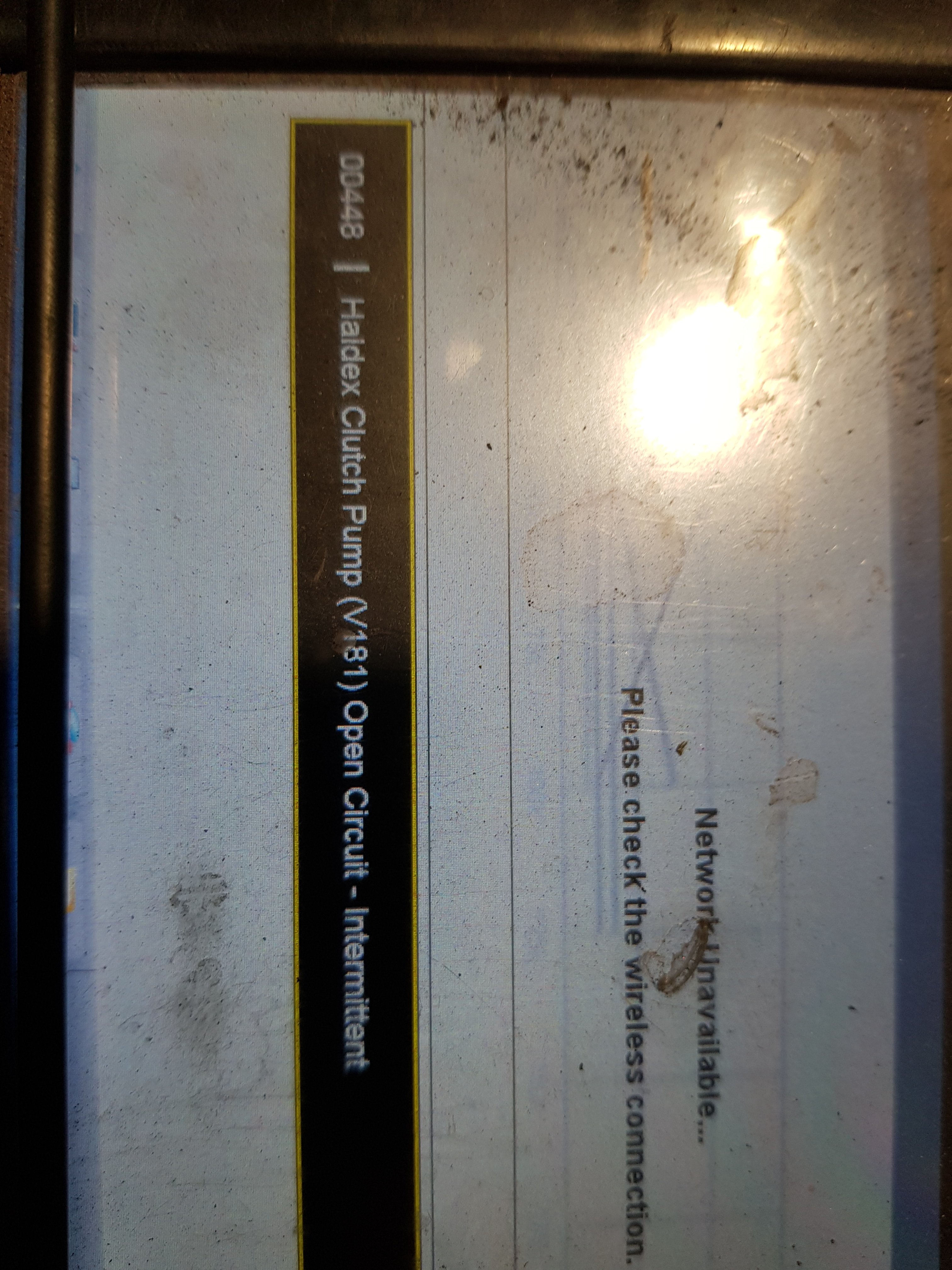

I have a 2011 Superb Elegance 1.8 TSi 4x4 118kw 158bhp (Reg: AF61 YCG) vehicle.
My Haldex AWD feeder clutch pump is showing an intermittent fault (see attached photo of diagnostics).

My 2014 plate is Gen 4 and this set up has the strainer on the end of the pump which needs cleaned, and also a removable/replaceable filter which must be changed at regular intervals.  It is likely yours is Gen 4....have a check here...  https://www.haldexrepairs.co.uk/what-generation-of-haldex-is-on-my-car/
Either way it is not a choice, you need the correct pump for whatever generation of Haldex unit is fitted to your car.
Despite servicing as per Skoda requirements, at a Skoda dealer my pump failed at 4 years old and had to be replaced.  I now change the haldex fluid at a much shorter interval, including replacing the removable filter.  It is probably lack of filter change/proper service that has burned your motor out.  You may need a new pump and change the filter while you are at it.
My advice - don't buy from Ebay - have a look at the Haldex Repairs site above, it has everything you need to know about fault finding etc and you can order the parts you need.  This is where I got my new pump and all has been fine since it was fitted two years ago.
